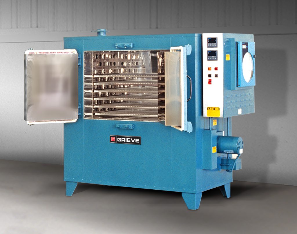

No. 934 is an 850° F (454° C), cabinet oven from Grieve, currently used for heat treating at a customer's facility. Workspace dimensions of this oven measure 38" W x 20" D x 26" H, and 10 KW are installed in Incoloy sheathed tubular heating elements, while a 600-cfm, 1/2-hp recirculating blower provides horizontal airflow to the workload.
January 15, 2019
No. 934 is an 850° F (454° C), cabinet oven from Grieve, currently used for heat treating at a customer’s facility. Workspace dimensions of this oven measure 38″ W x 20″ D x 26″ H, and 10 KW are installed in Incoloy sheathed tubular heating elements, while a 600-cfm, 1/2-hp recirculating blower provides horizontal airflow to the workload.
This Grieve cabinet oven has 6″ insulated walls, an aluminized steel exterior and type 430 stainless steel interior.
Controls on the No. 934 include a digital indicating temperature controller, 10″-dia. circular chart recorder and SCR power controller.
