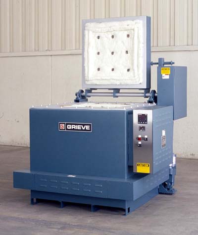

No. 943 is an electrically-heated, 2000°F top-loading pit furnace from Grieve Corp., currently used on a variety of heat treating applications at a customer's facility.
August 1, 2011
No. 943 is an electrically-heated, 2000°F top-loading pit furnace from Grieve Corp., currently used on a variety of heat treating applications at a customer’s facility. Workspace dimensions measure 24″W x 24″D x 24″H. 26kW installed in nickel chrome wire coils, supported by vacuum-formed ceramic fiber, supply heat to the workload.
This Grieve pit furnace feature 7″ thick insulated walls, comprising 5″ of 2300°F ceramic fiber blanket and 2″ of block insulation. A 6-½” thick furnace floor is made of castable refractory materials.
No. 943 also includes an air-operated vertical lift door and a reinforced ½” steel top plate to protect the unit while loading and unloading occur.
Safety equipment includes an adjustable, thermocouple-actuated, manual reset excess temperature controller, separate heating element control contactors and a door interlock switch.
