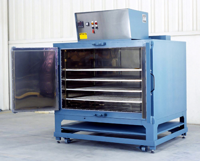

No. 945 is an electrically heated 500°F(~260 degrees C) universal oven from Grieve, currently used for various curing tasks at the customer's facility.
August 1, 2014
No. 945 is an electrically heated 500°F(~260 degrees C) universal oven from Grieve, currently used for various curing tasks at the customer’s facility. Workspace dimensions are 54″ wide x 36″ deep x 36″ high. Grieve installed 6.6 KW in Nichrome wire heating elements to heat the load, while a 600 CFM, ½-HP recirculating blower provides horizontal front to rear airflow.
The unit has 4″ insulated walls, an aluminized steel exterior and Type 430 stainless steel interior. It is also equipped with an integral leg stand with casters and leveling pads.
Controls onboard No. 945 include a digital indicating temperature controller, manual reset excess temperature controller with separate contactors, recirculating blower airflow safety switch and SCR power controller.
