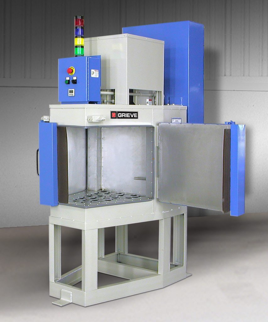

No. 994 is a 500° F (260° C) special cabinet oven from Grieve, currently used for heating the end of long parts at the customer's facility. Workspace dimensions of this oven are a tapered 10" at front and 20" at rear wide x 20" deep x 21" high.
October 17, 2017
No. 994 is a 500° F (260° C) special cabinet oven from Grieve, currently used for heating the end of long parts at the customer’s facility. Workspace dimensions of this oven are a tapered 10″ at front and 20″ at rear wide x 20″ deep x 21″ high. 9KW are installed in Nichrome wire heating elements, while a 600 CFM, ½-hp recirculating blower provides vertical upward airflow to the workload.
This Grieve cabinet oven has 4″ insulated walls and an aluminized steel interior and exterior. Features also include safety equipment for handling flammable solvents, including explosion venting door hardware.
Controls on No. 994 include all applicable NEMA 12 electrical standards and a tower light to indicate machine status.
