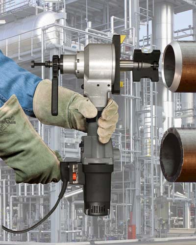

A heavy-duty I.D. clamping pipe milling end prep tool now offered with an electric motor for performing heavy-wall preps at metal fabrication shops or on-site is being introduced by ESCO Tool.
June 12, 2012
The Prepzilla MILLHOG Electric I.D. Clamping End Prep Tool features robust construction with dual-opposed tapered roller bearings, direct-drive gears, a rigid blade lock system, and TiN coated T-15 tool steel cutter blades. Now offered with an 1800W motor that operates on 110/230VAC, it needs only one mandrel and eight sets of clamps for pipe from 1.5″ I.D. to 8.62″ O.D.
Designed to bevel, face, and bore all hard pipe alloys, the Prepzilla MILLHOG Electric I.D. Clamping End Prep Tool is supplied complete with all clamp ribs and pads, a hose and filter, lubricator, and a metal carrying case. For users who have the pneumatic version of the tool and want to convert to electric, the changeover only requires four bolts.
he Electric I.D. Clamping End Prep Tool is priced at $8,995.00 or is offered for rent in the continental U.S. for $336.00/week.
