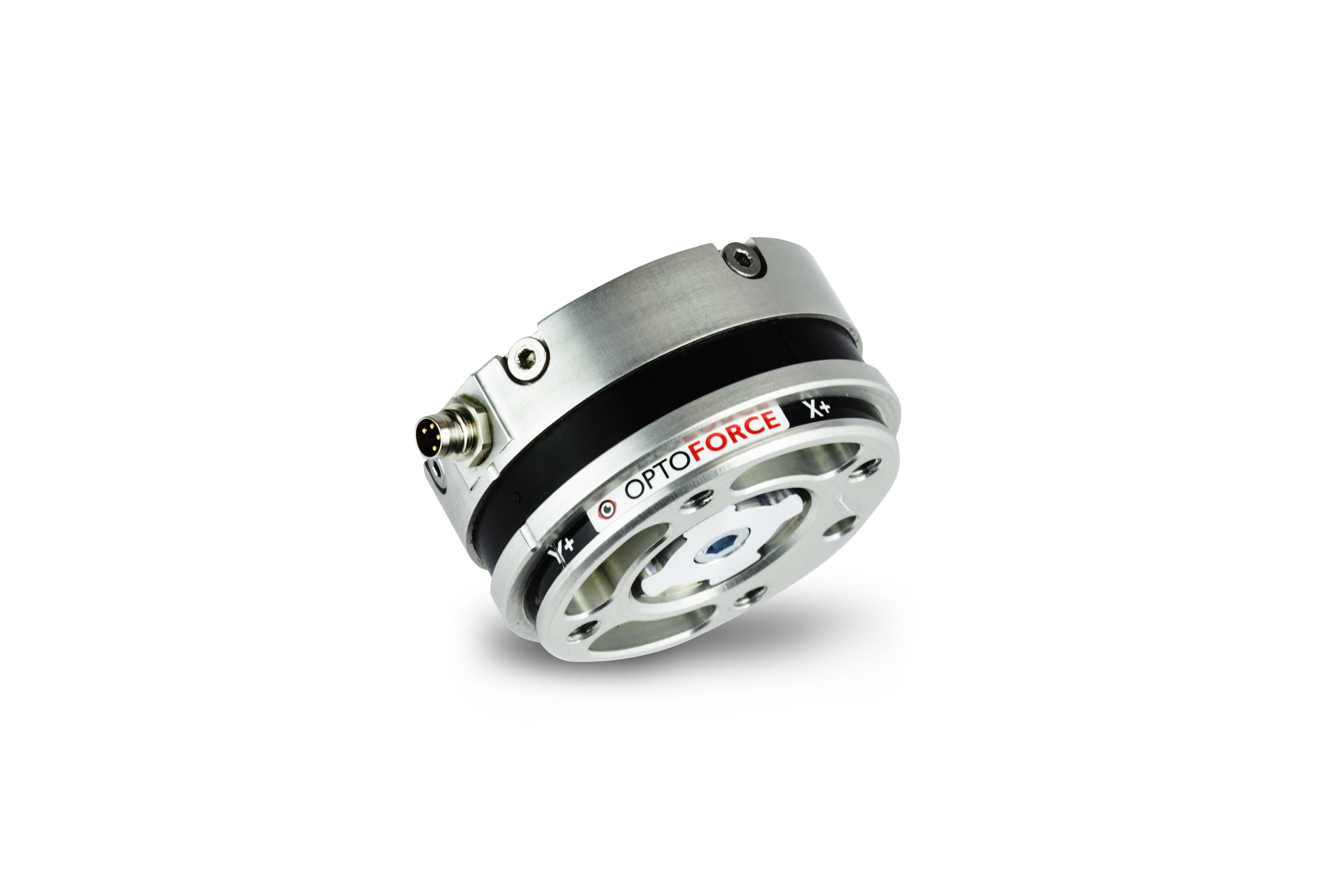

An OptoForce sensor.

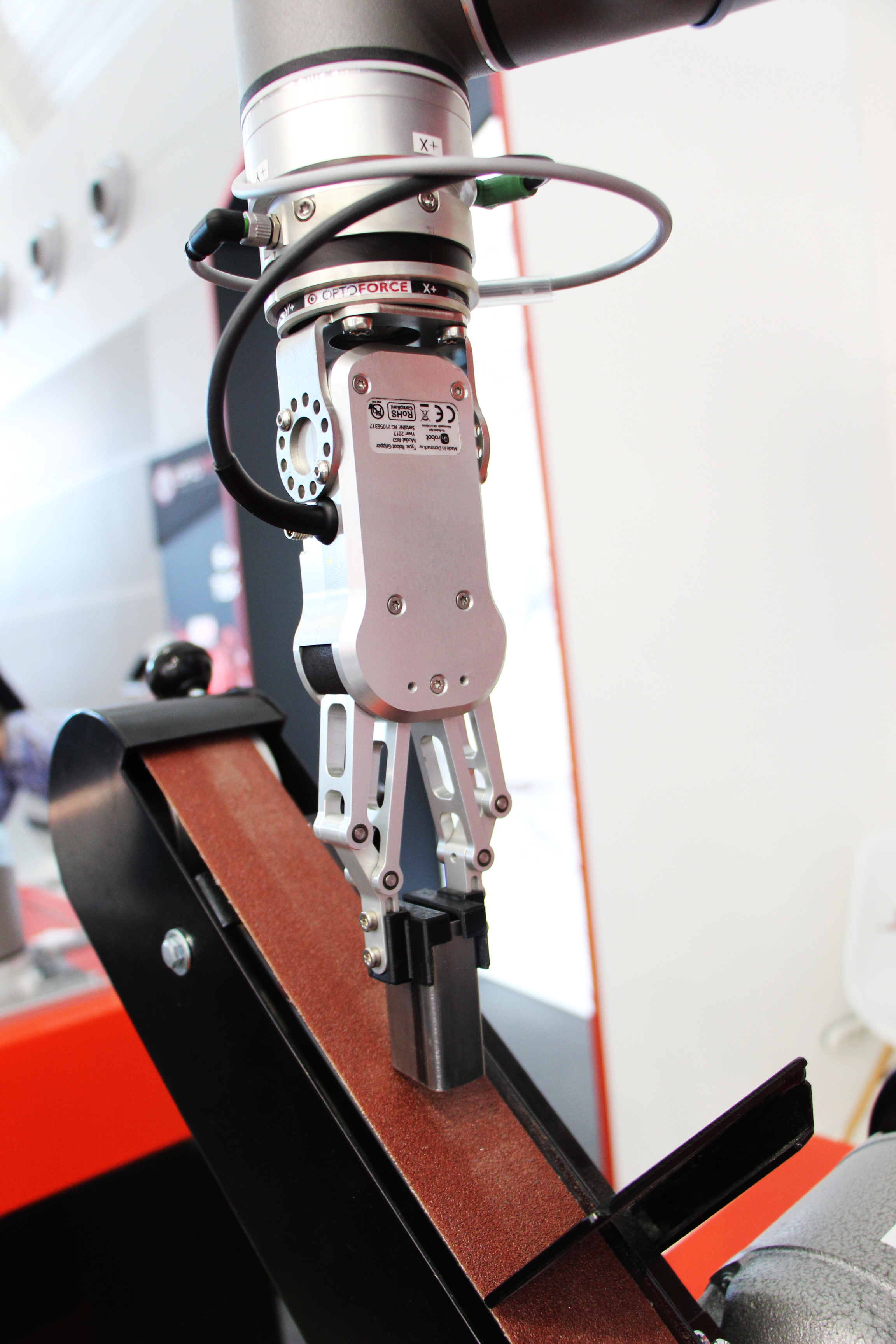

Rewritten Core Software for Universal Robots Industrial Robots image
Sanding a metal part with OptoForce sensor and software solution.
