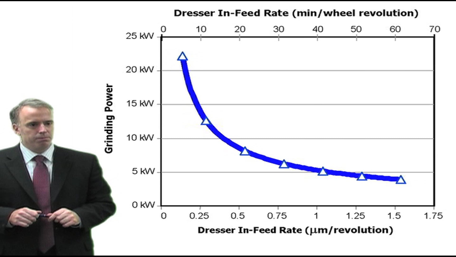

A shop performing continuous-dress, creep-feed grinding on nickel alloys contacted Dr. Jeffrey Badger for advice on battling burn while reducing wheel consumption. Check out Badger's response in the latest episode of The Grinding Doc video series produced by CTEplus, the Web site for Cutting Tool Engineering magazine.
October 14, 2016
A shop performing continuous-dress, creep-feed grinding on nickel alloys contacted Dr. Jeffrey Badger for advice on battling burn while reducing wheel consumption. Check out Badger’s response in the latest episode of The Grinding Doc video series produced by CTEplus, the Web site for Cutting Tool Engineering magazine. Visit The Grinding Doc website for more advice from Dr. Jeffrey Badger at
