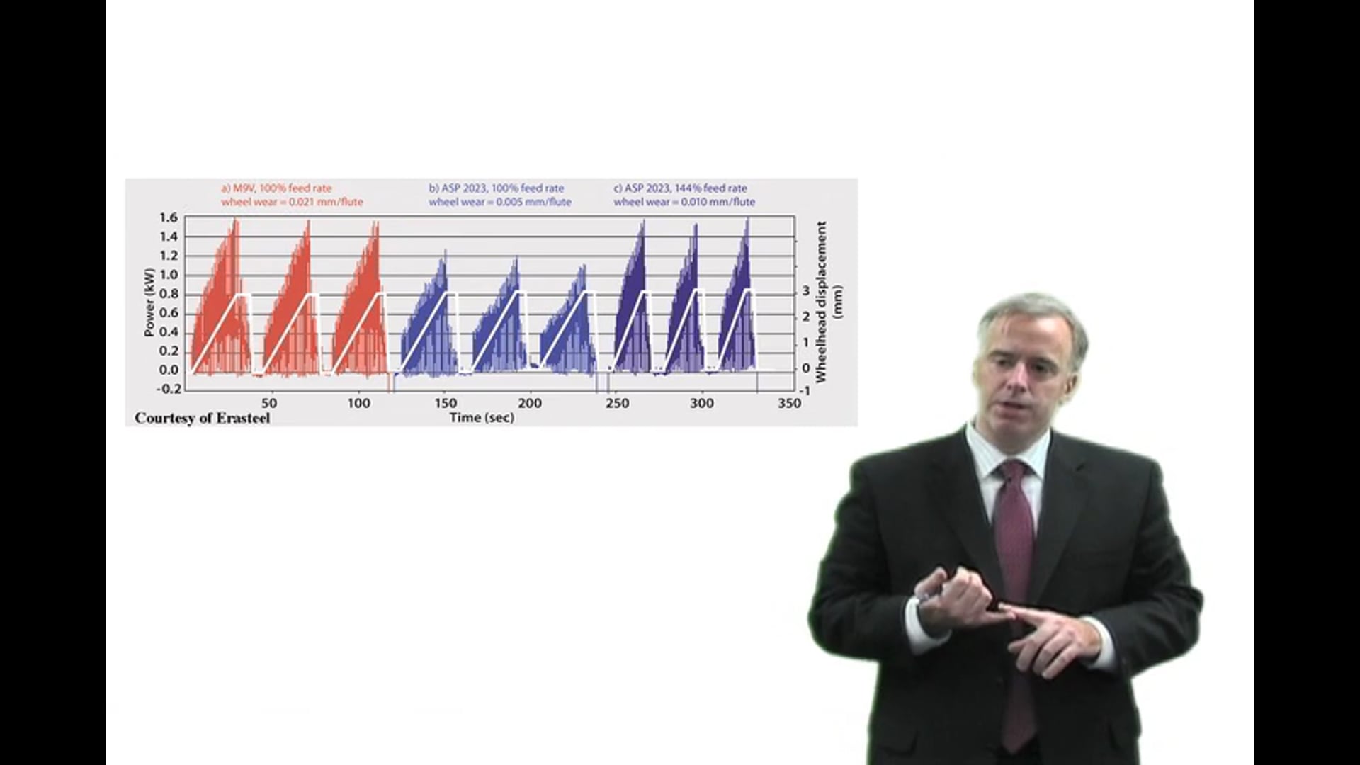

In episode 18 of the Grinding Doc video series, a shop experiencing more wheel wear and burn after switching from one high-speed steel grade to another with lower grindability—requiring slower feedrates—seeks a recommendation for a wheel that won't require the shop to increase cycle time. Dr.
October 14, 2016
In episode 18 of the Grinding Doc video series, a shop experiencing more wheel wear and burn after switching from one high-speed steel grade to another with lower grindability—requiring slower feedrates—seeks a recommendation for a wheel that won’t require the shop to increase cycle time. Dr. Jeffrey Badger, the Ask the Grinding Doc columnist for Cutting Tool Engineering magazine, responds. Visit The Grinding Doc website for more advice from Dr. Jeffrey Badger at
