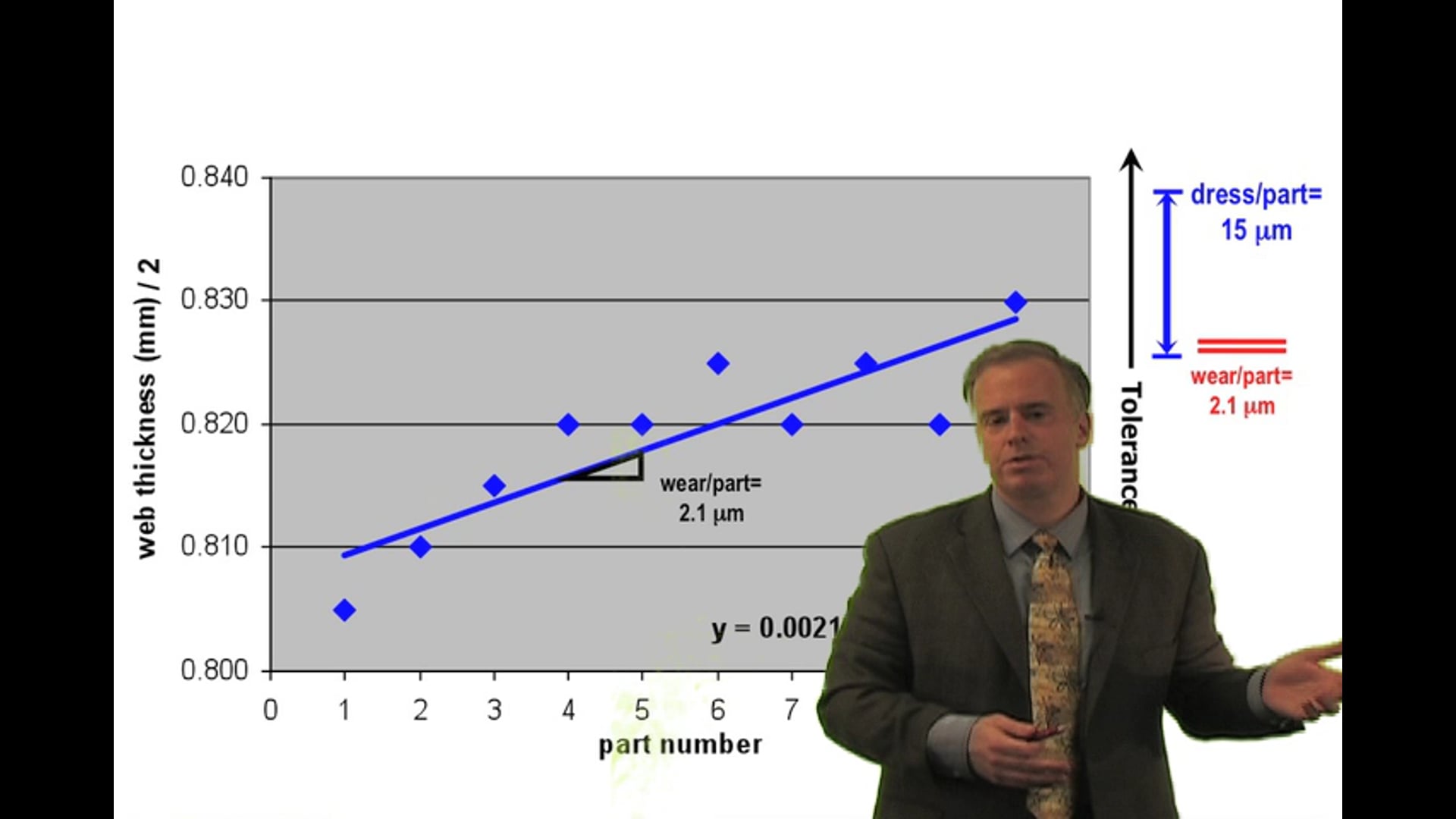

The Grinding Doc suggests a shop look at its dressing policy if it hopes to reduce its wheel consumption. Visit The Grinding Doc website for more advice from Dr.
