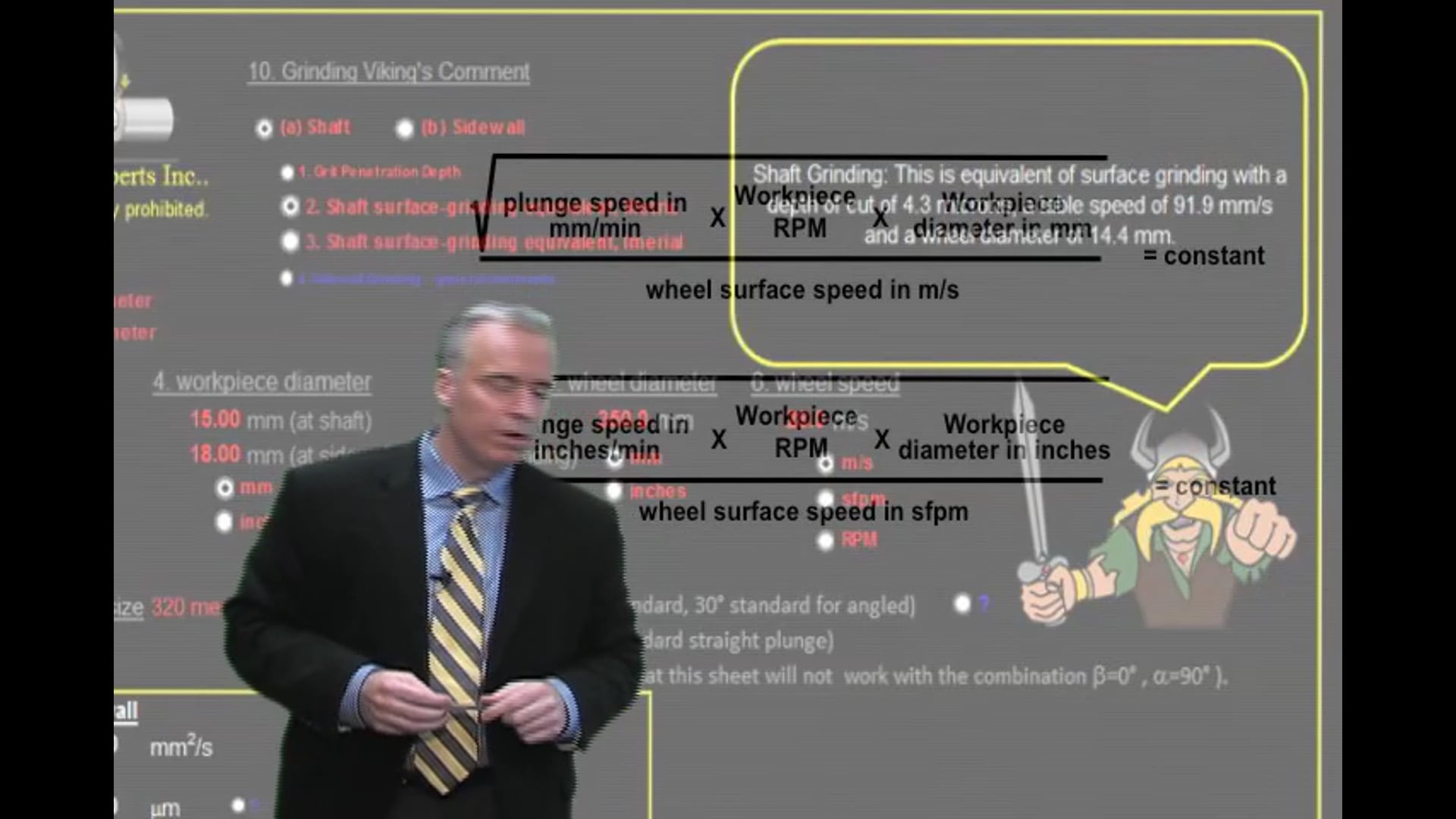

A shop that cylindrical-grinds tungsten-carbide is running into trouble maintaining optimal parameters when switching to a larger diameter. Dr. Jeffrey Badger, Cutting Tool Engineering magazine's Ask the Grinding Doc columnist, offers some insight. Visit The Grinding Doc website for more advice from Dr.
A shop that cylindrical-grinds tungsten-carbide is running into trouble maintaining optimal parameters when switching to a larger diameter. Dr. Jeffrey Badger, Cutting Tool Engineering magazine’s Ask the Grinding Doc columnist, offers some insight. Visit The Grinding Doc website for more advice from Dr. Jeffrey Badger at
