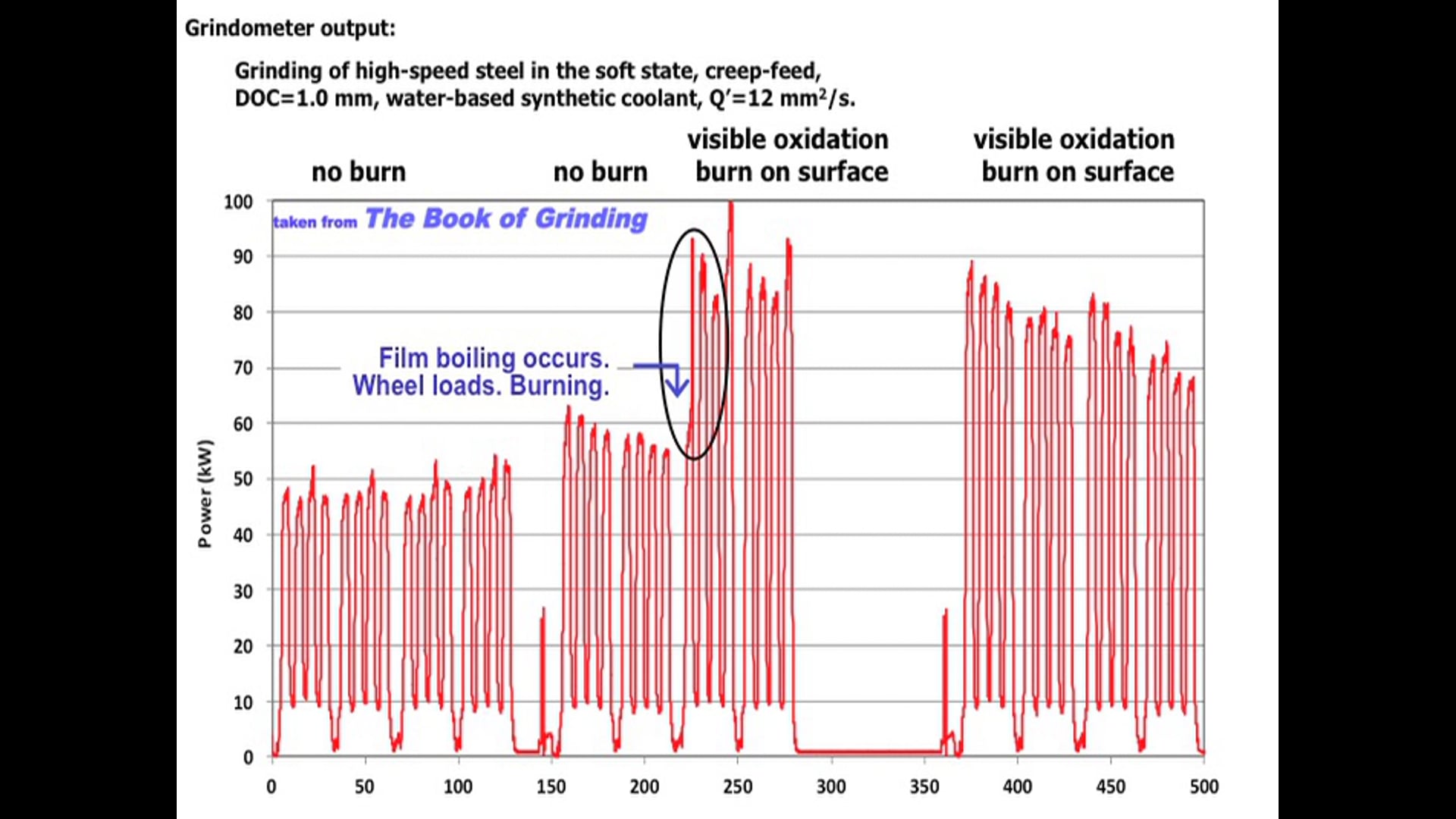

Grinding hardened steel using a water-based coolant is fine for a few hours, then—wham!—really bad burn. The Grinding Doc offers some insight. Visit The Grinding Doc website for more advice from Dr.
December 16, 2016
Grinding hardened steel using a water-based coolant is fine for a few hours, then—wham!—really bad burn. The Grinding Doc offers some insight. Visit The Grinding Doc website for more advice from Dr. Jeffrey Badger at
