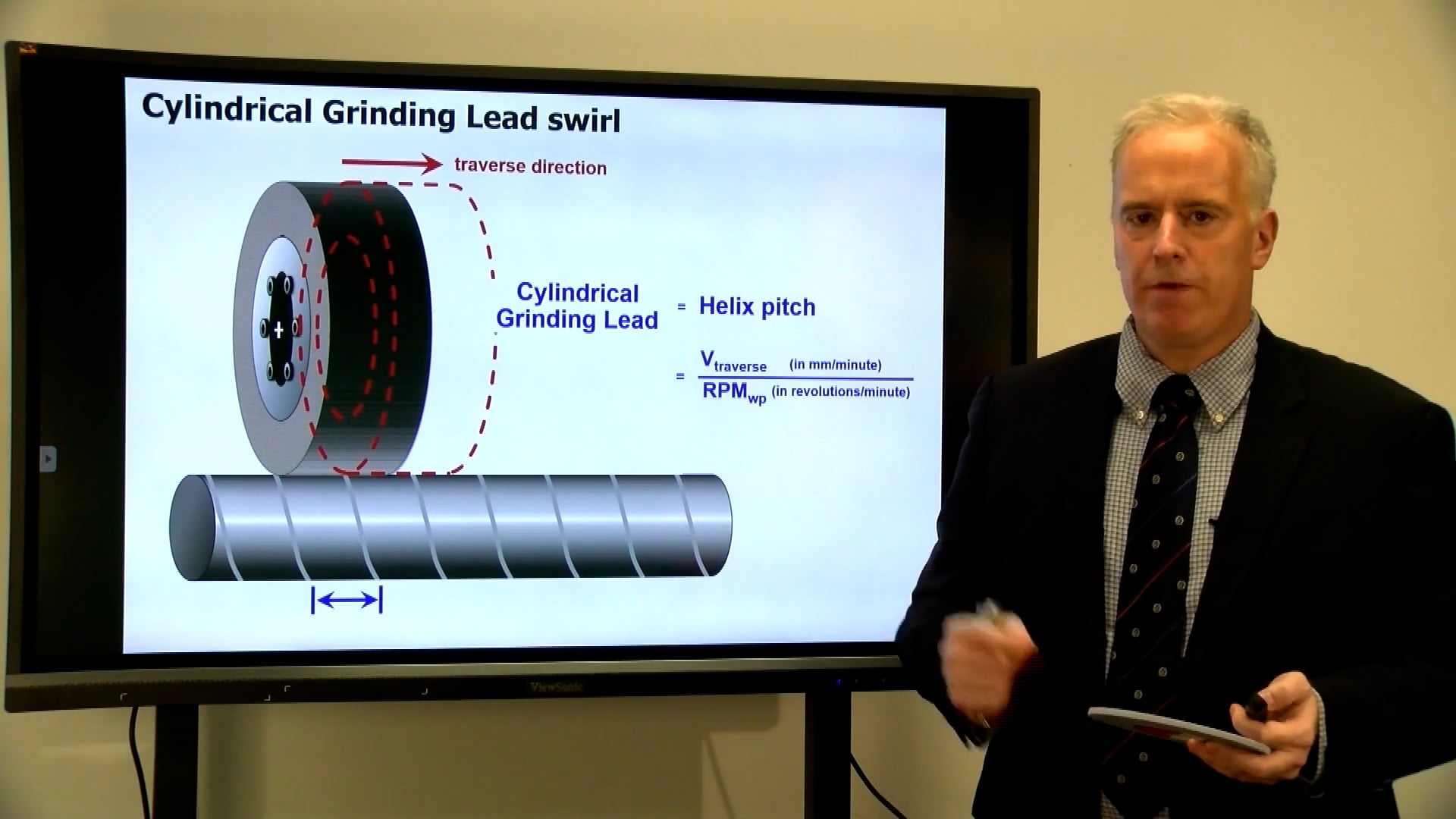

Episode 99: Spiraling out of control
The Grinding Doc helps a shop understand the source of the spiral marks showing up on a part, and offers a potential solution.
February 26, 2020
The Grinding Doc helps a shop understand the source of the spiral marks showing up on a part, then offers a potential solution in the 99th episode of CTE’s Grinding Doc video series.
