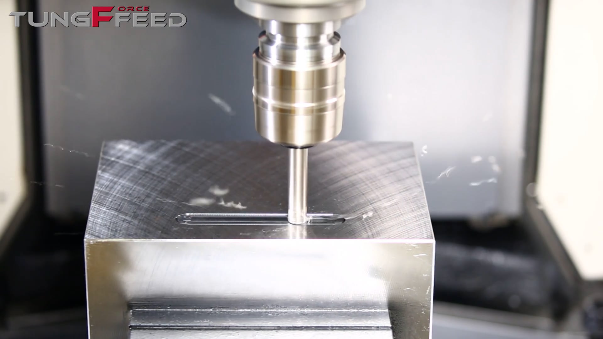

TungForce-Feed, indexable small diameter high feed milling cutters with diameters ranging from ø0.375″ – ø0.625″, allows depths of cut up to 0.02″. The new cutter ensures high productivity and economy in profiling die/mold parts over conventional solid end mills and similar indexable tools.
April 29, 2019
TungForce-Feed, indexable small diameter high feed milling cutters with diameters ranging from ø0.375″ – ø0.625″, allows depths of cut up to 0.02″. The new cutter ensures high productivity and economy in profiling die/mold parts over conventional solid end mills and similar indexable tools. The inserts large positive rake and inclination angle geometry, combined with closer-pitched cutter bodies, allows it to be used in a broader application range, while ensuring high machining efficiency. The thick insert corner withstands heavy loads during milling, preventing insert fracture and possible cutter body damage. Two insert grades are available, and the cutter body comes in a shank or modular type.
