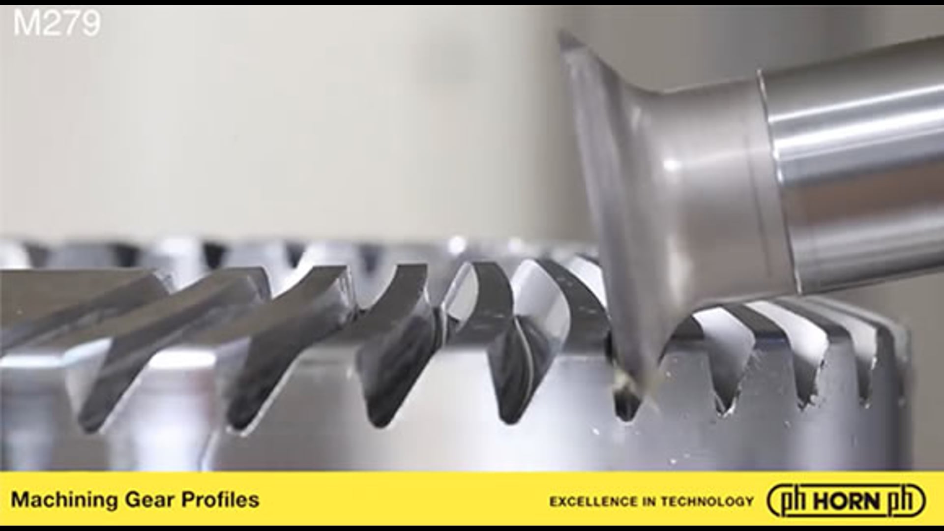

Cyclo-Palloid tooth profiles can be milled with specialized cutting tools. The tooth profiles are produced in multiple rouging and finishing passes. Internal and external spur gears can be produced with single tooth or progressive tooth broaching tools. Broaching tools can be turret mounted or used in a reciprocating attachment.
August 1, 2018
Cyclo-Palloid tooth profiles can be milled with specialized cutting tools. The tooth profiles are produced in multiple rouging and finishing passes. Internal and external spur gears can be produced with single tooth or progressive tooth broaching tools. Broaching tools can be turret mounted or used in a reciprocating attachment. Power skiving is a unique process used for gear production.
