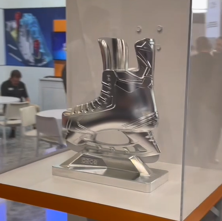

Among the draws of this busy booth was a hockey theme that showed how its hyperMILL software technology can help manufacturers produce perfect finishes such as a brilliantly finished ice skate on display. The theme continued with a hockey stick and goalie mask. The difference, of course, was that these hockey tools were made of metals.
“[The] skate is completed, finished and machined,” said Alan Levine, managing director at OPEN MIND Technologies, “with perfect surfaces and blends using hyperMILL’s smooth overlap, and point-spacing techniques, it is just a beautiful object.”

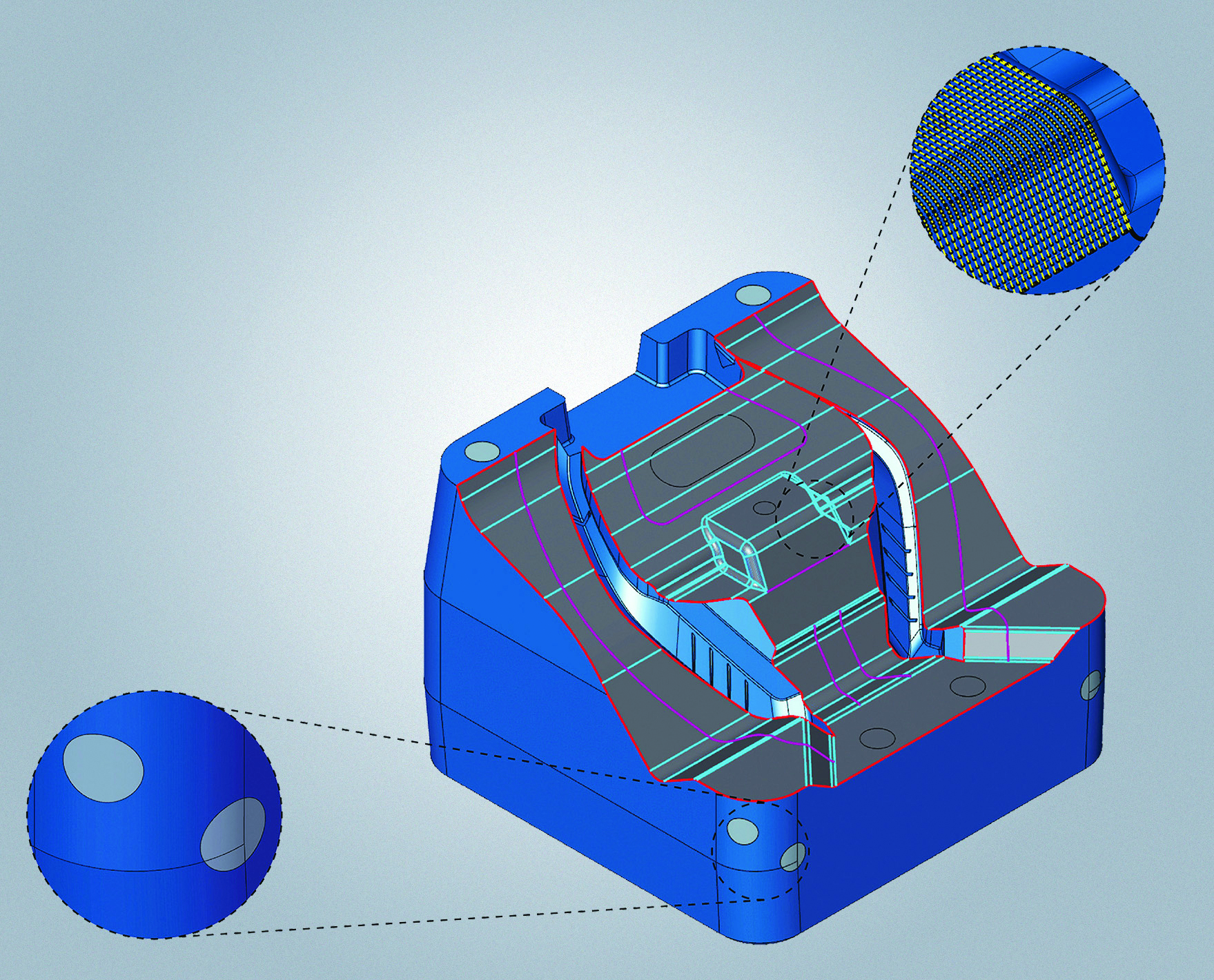

In addition, a new algorithm for 3-axis and 5-axis Rest Machining (see picture above) helps ensure automatic, complete detection of all rest material areas, and optimized toolpath calculations for faster, reliable machining. Toolpaths are now optimally divided to ensure more efficient machining, and the detection of intersection areas where paths meet has been optimized for collision avoidance, the company said.

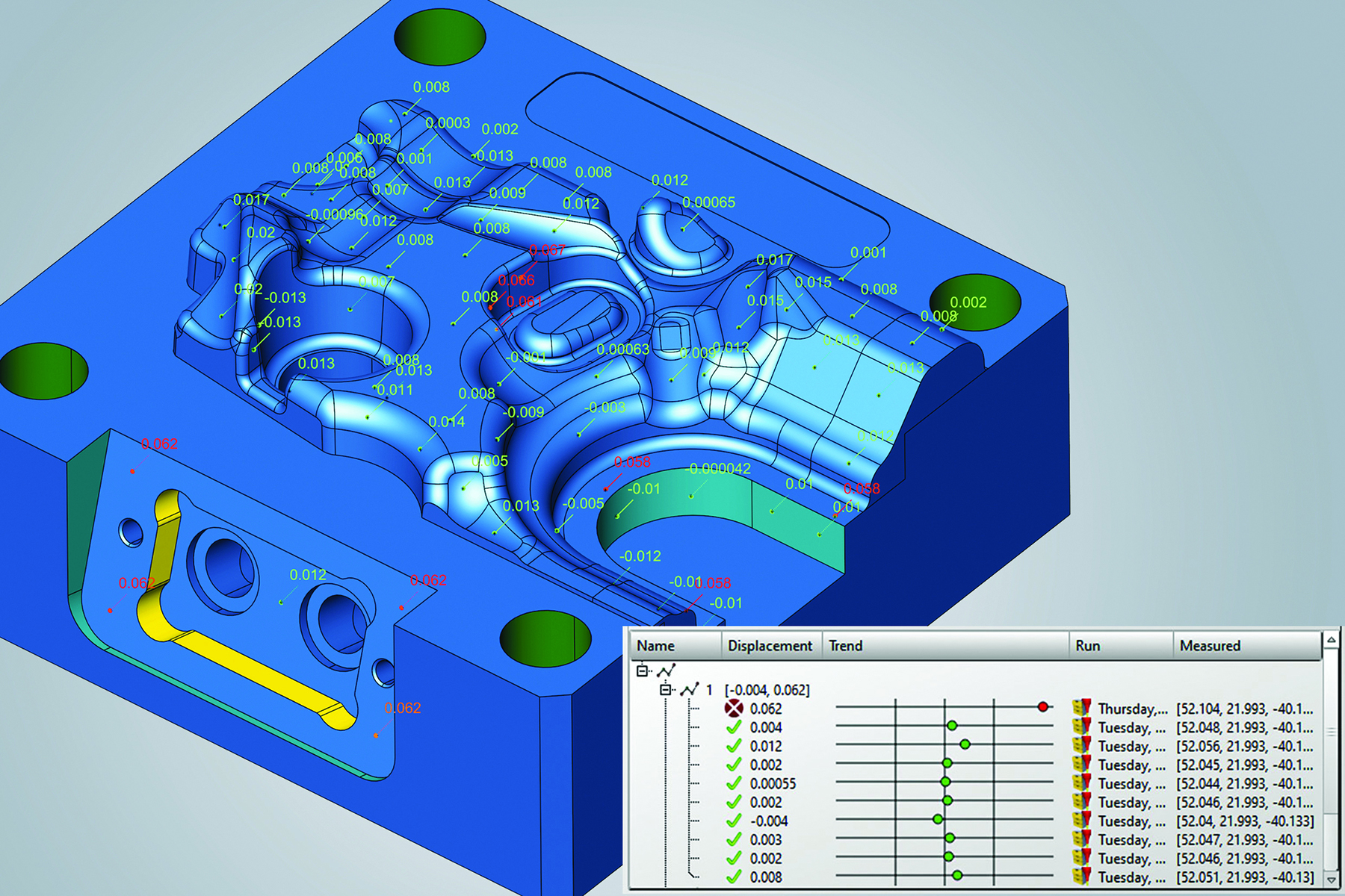

read measurement pointsMeasuring points read back for improved quality and process control. A 3D model of the component shows measuring points that are outside tolerance.“>
Another virtual machining features is reading back of measuring points that allows graphical representation of measured points on the part model, rather than comparing a list of measurement results.
The company says that users can quickly identify measuring points that are out of tolerance on a 3D part model and compare trends over sequential measurements. As a result, it is much easier to analyze and compensate for inaccuracies and tool wear after milling.
