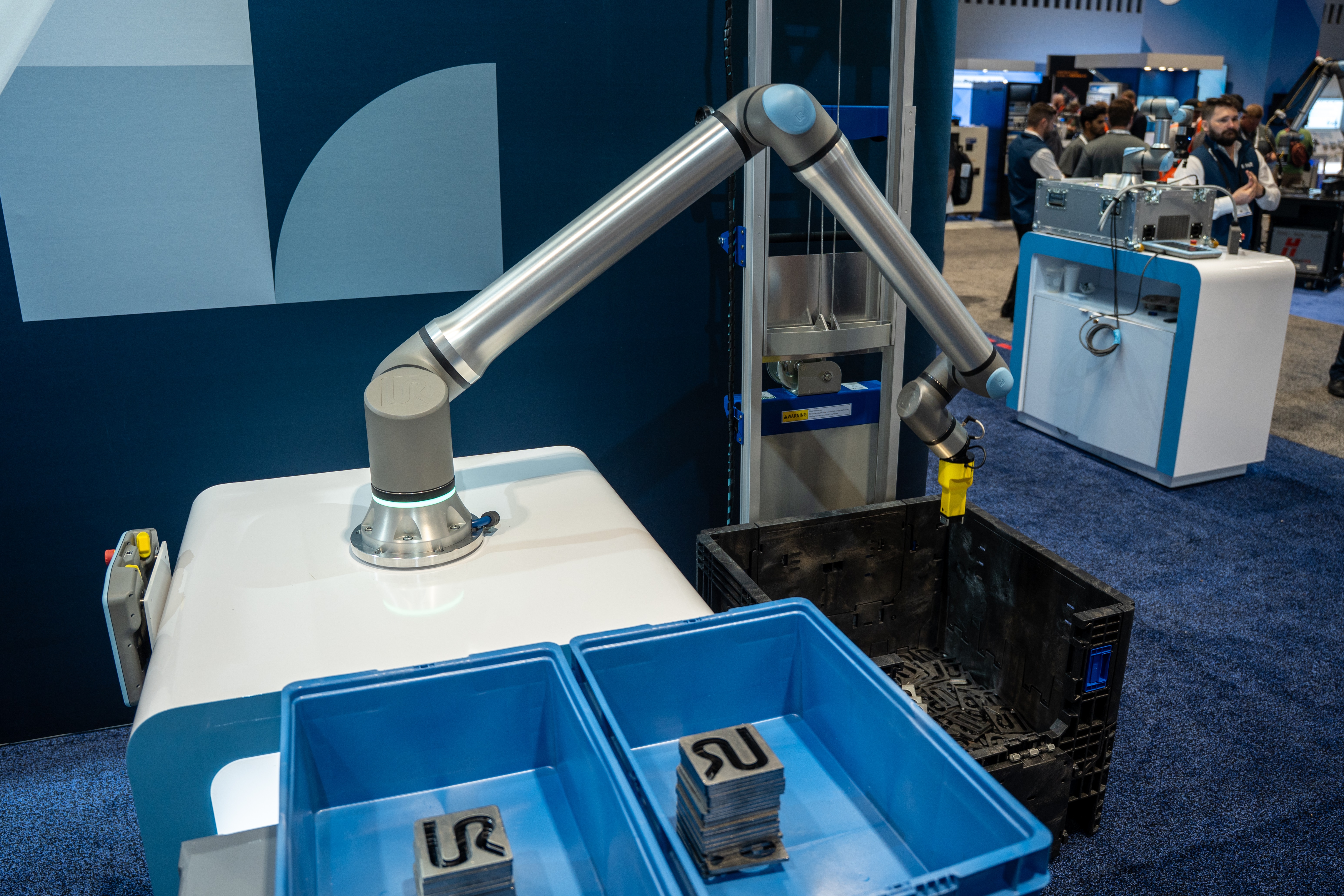

UR8 LongUR8 Long’s extended reach, combined with coordinated multi-axis motion, is highlighted in this bin picking demo.“>UR8 Long
It features a 1,750 mm (68.9 in.) reach that it combines with a rugged, compact, lightweight form, featuring an 8 kg (17.6 lbs.) payload. Hathout said these features makes it ideal for space-constrained setups and industrial tasks, from complex weldments to precision dunnage picking and flexible multi-point inspections.

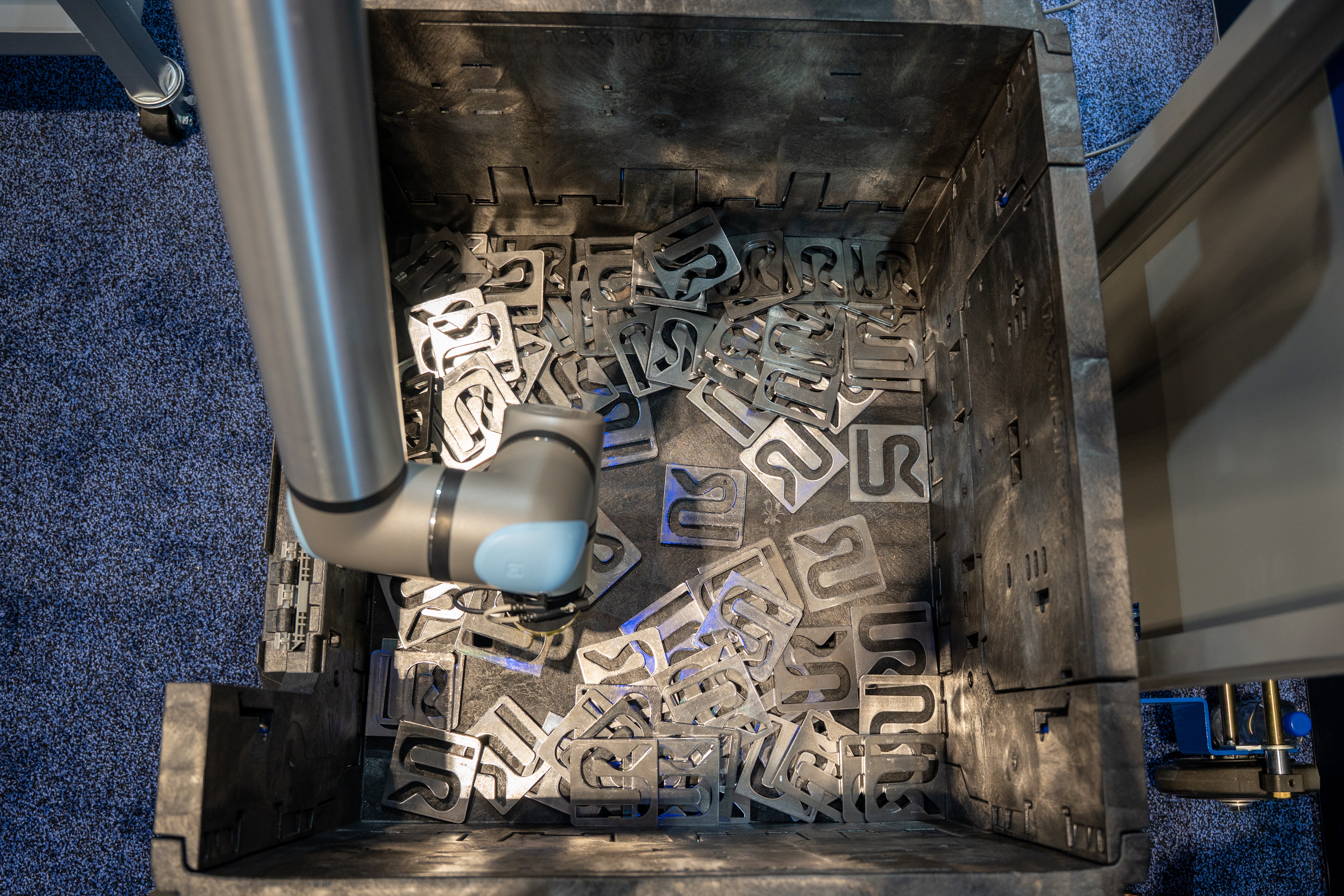

For example, at Fabtech Universal Robots showcased its bin-picking capabilities. It showed the UR8L picking parts from a full dunnage bin into a separate container. The longer reach, combined with the new robot’s compact tool flange and fast wrist joints, allows more pick positions and for the robot to reach deep into bin corners with ease. The improved joint architecture delivers up to 30% faster cycle times compared to earlier generations of Cobots.
