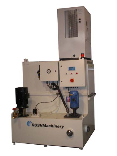

Rush Machinery Inc. introduces redesigned high-performance filtration systems. Designed to integrate with most grinding, lapping and honing machines, the FC-300 filtration system provides continuous filtration, automatic back flush and clean fluid on demand to machines. The enhanced capabilities and features of the filtration systems include: The ability to filter oil or water-based coolant using edge filtration technology. Oil can be filtered to a 1µm particle size and water to 5µm (nominal) particle size. This provides for improved surface finishes, extends the life of grinding wheels and fluids, and reduces machine maintenance. Filtration systems for water utilize stainless steel edge filtration elements and vessels that never need replacing, according to the company. On multi-vessel systems, vessels are automatically back-flushed individually to provide a constant supply of clean fluid during the regeneration cycle. Balanced clean and dirty fluid tank sizes ensure separation of clean and dirty fluid during automatic regeneration of filter elements. Compact system footprint. Customized systems to fit your machines and shop floor layout. Single and multi-pump configurations are available for clean fluid delivery to your machine tools. All components are designed and located for ease of maintenance. An optional cooling system can be incorporated to ensure optimal grinding oil temperature.
