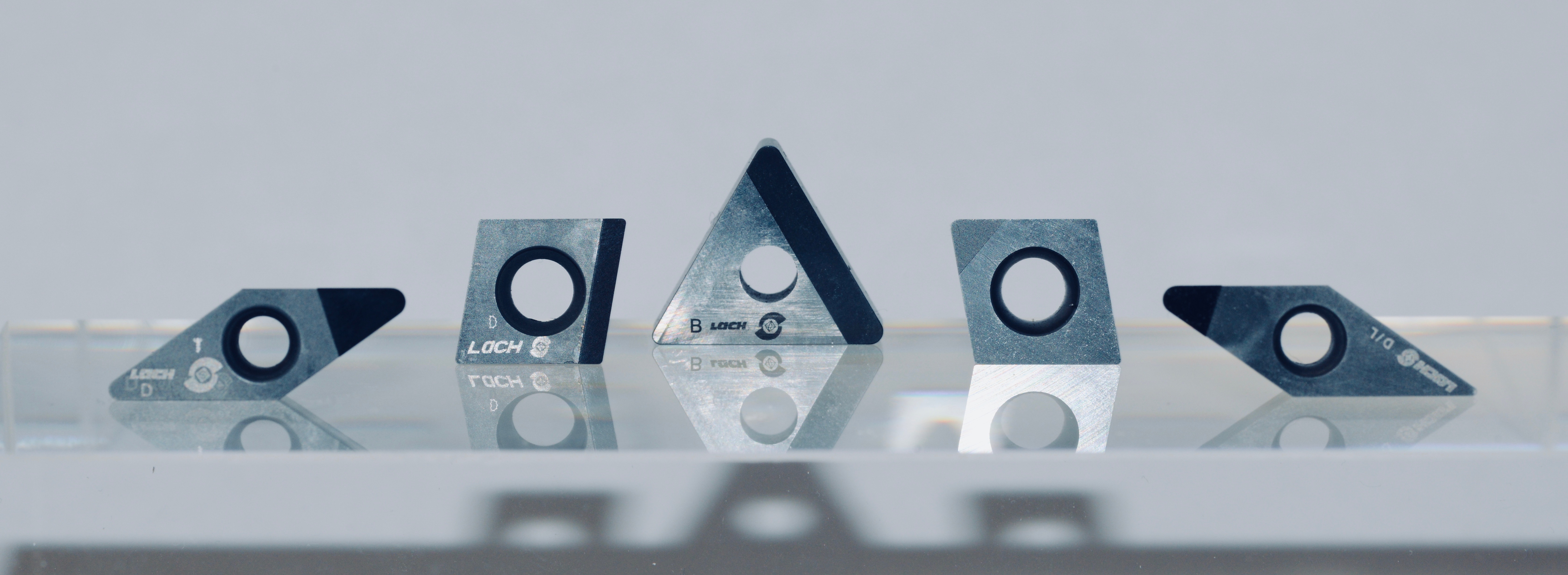

A selection of PCD and PCBN inserts, developed during the 1970s, for milling and turning.

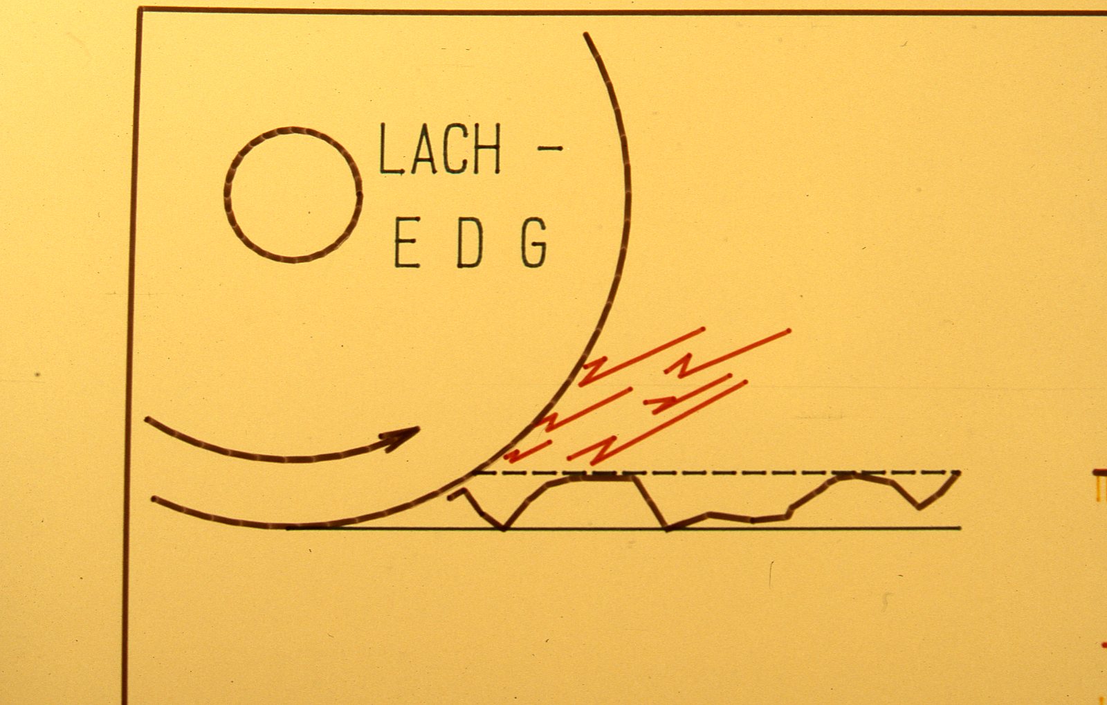

A diagram of spark erosion grinding with rotating electrode, either graphite or copper.

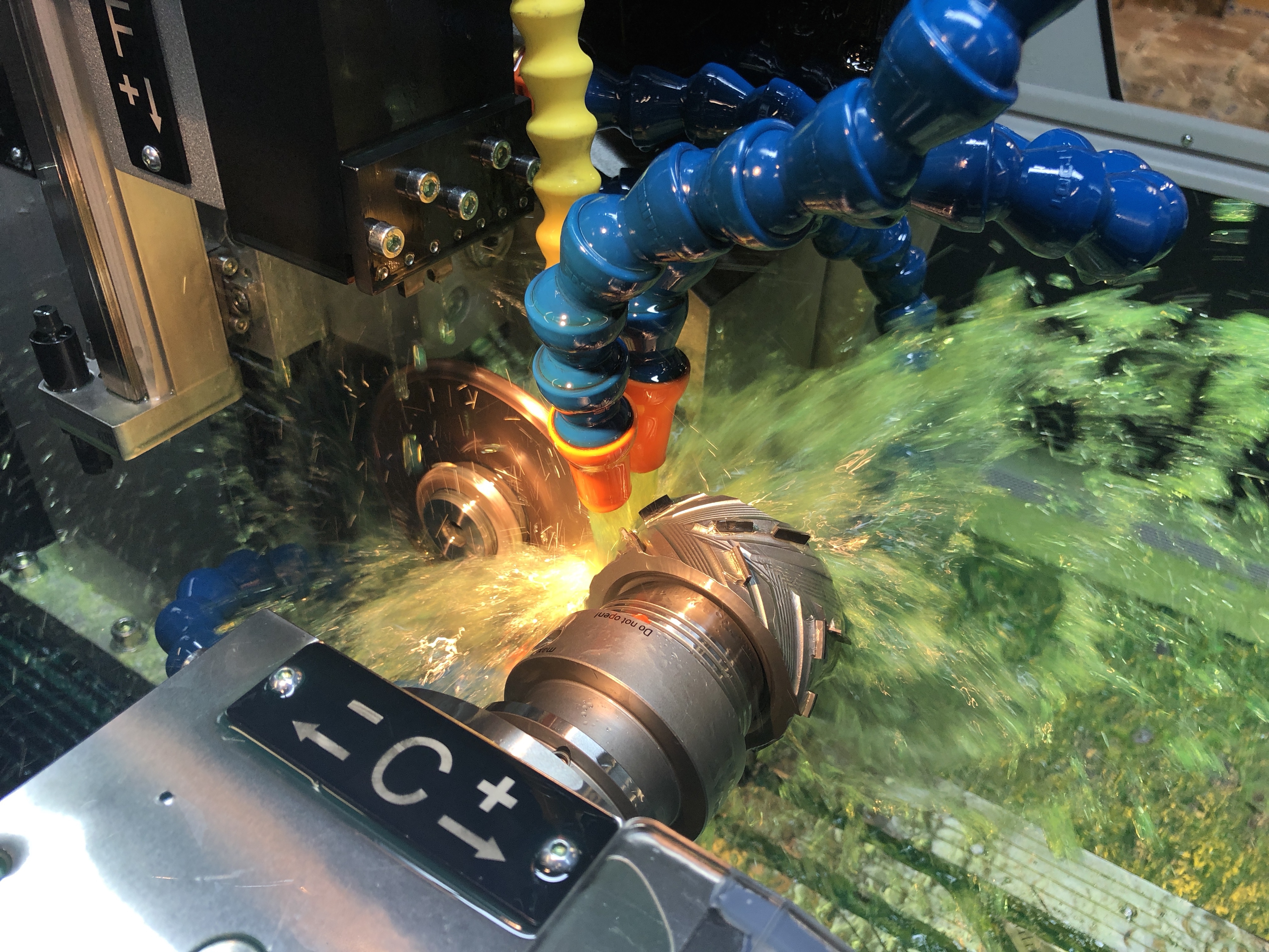

Demonstration of LACH-EDG spark erosion grinding on a »Dia-2200-mini«.

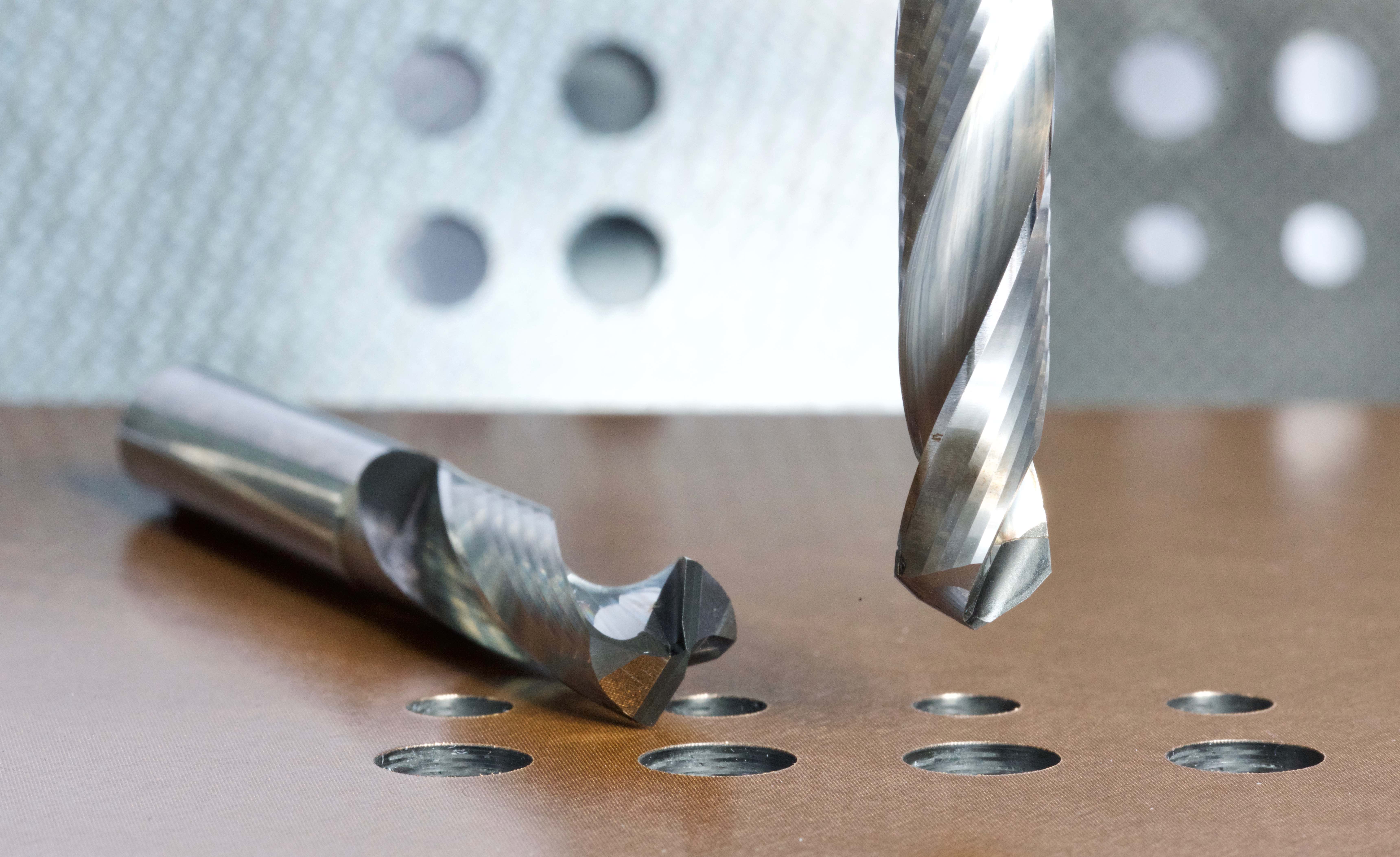

The PDC spiral drill »PS-plus« is for machining composite materials.
