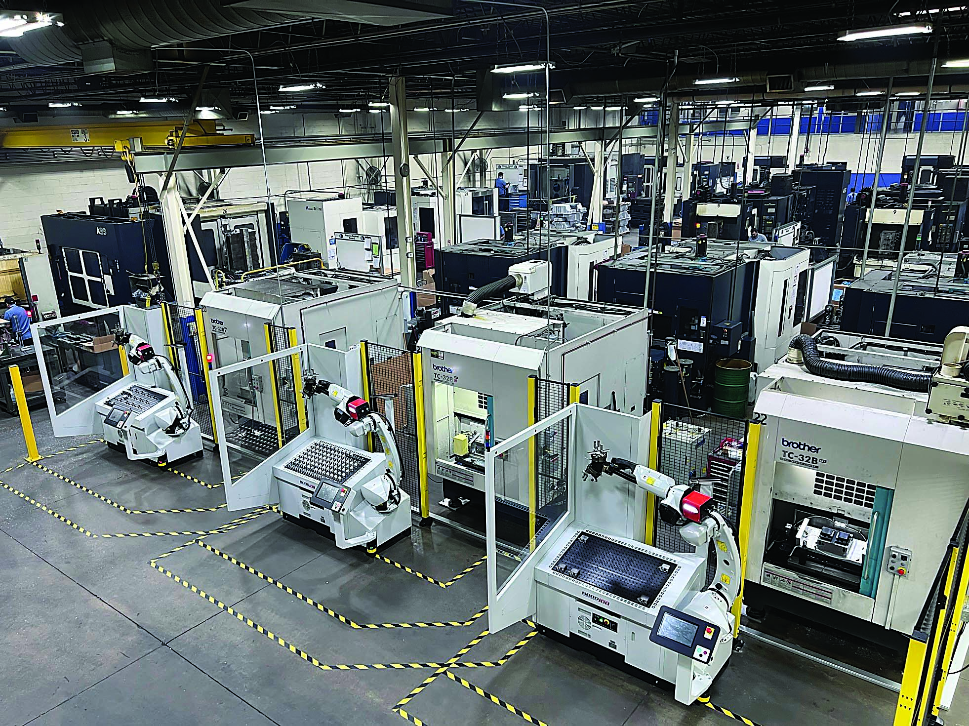

For maximum safety and efficiency, ideally each CNC machine is governed by a dedicated robot.
For maximum safety and efficiency, ideally each CNC machine is governed by a dedicated robot. Image courtesy of C. Zoberis
Accessibility. Ideally, machine-tending robots are mounted on an incline to allow the machine opening to stay clear for the machinist to operate manually for first articles and enable tool changing. The angle of the robot is defined in a specific way to easily access the machine clamping device without mounting directly in front of the machine. The consequence is that it is not possible for the robot to reach a second CNC because it is out of the robot’s mechanical limits. This means that if the robot wants to reach two machines, it must be placed right in front of the doors of the machines — thus you will lose operator access to both machines.
