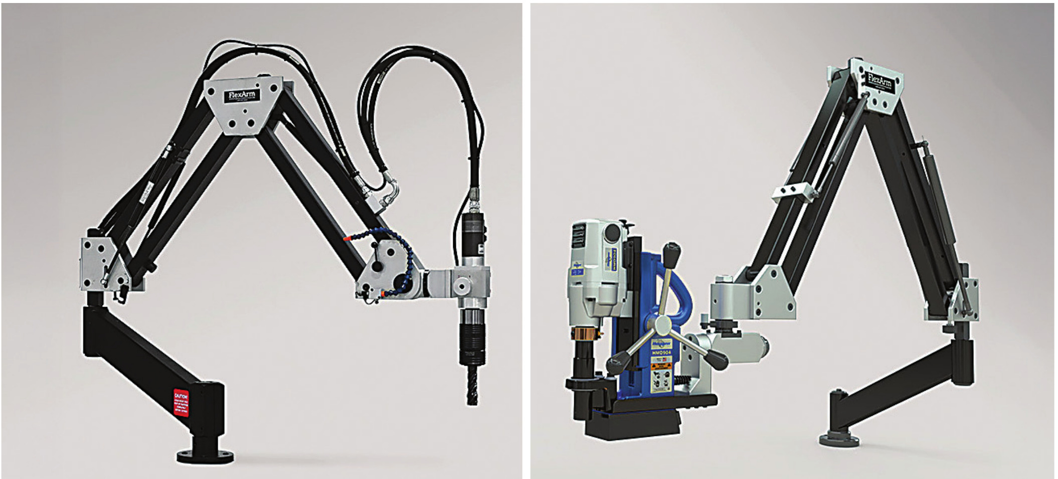

These tools are in the space between a manual tool like a tap wrench or handheld drill and a CNC machine tool or robot. The accompanying image shows a FlexArm tapping arm on the left and a Mag Drill arm on the right. For operators, FlexArm tools ease the burden of carrying the weight of a tool and controlling its torque reaction during an application, allowing them to concentrate on accuracy and productivity with increased safety for both the work and workforce.
FlexArm tapping arm and drilling arm
Shown are the FlexArm solutions for tapping (left) and drilling. Credit: Flex Machine Tools
These arms have a tool post that attaches perpendicular to a work surface on one end. The tool post is a cylinder with flange or magnetic base; the end of the arm has a hub that fits on the post that allows the arm to rotate around the post. The distance between the tool post and tap center line is manipulated by the operator while the mechanical arm keeps the tap perpendicular to the work surface. With these two degrees of freedom (one rotary and one linear), the tap can be brought to bear anywhere in a workspace.
