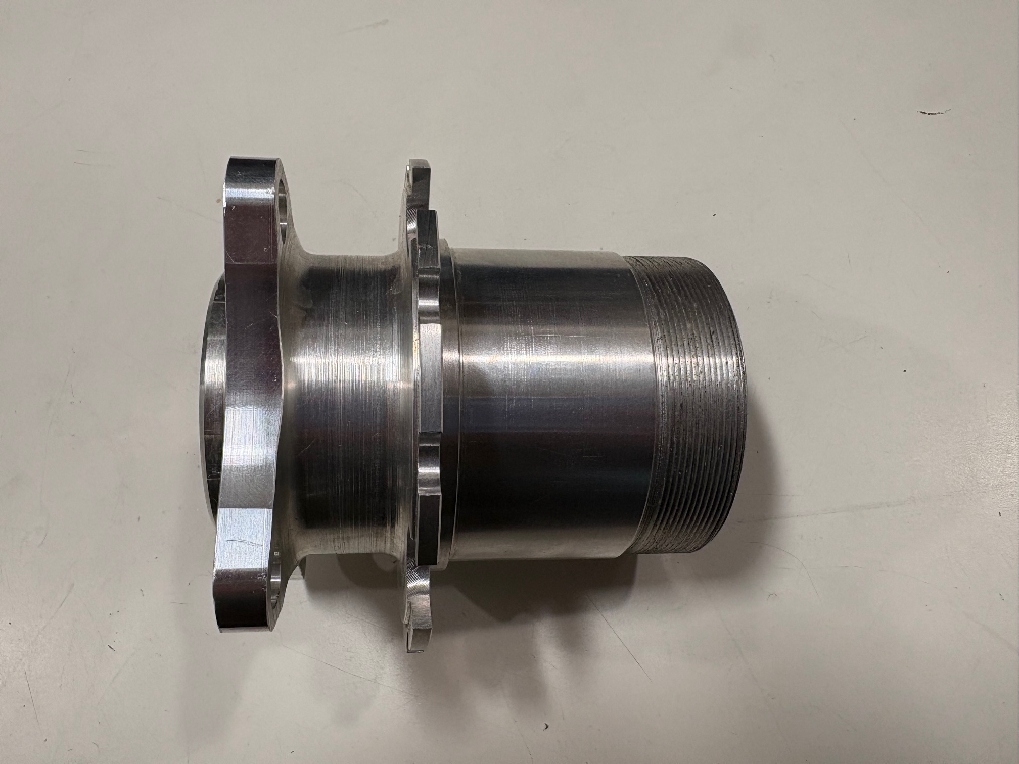

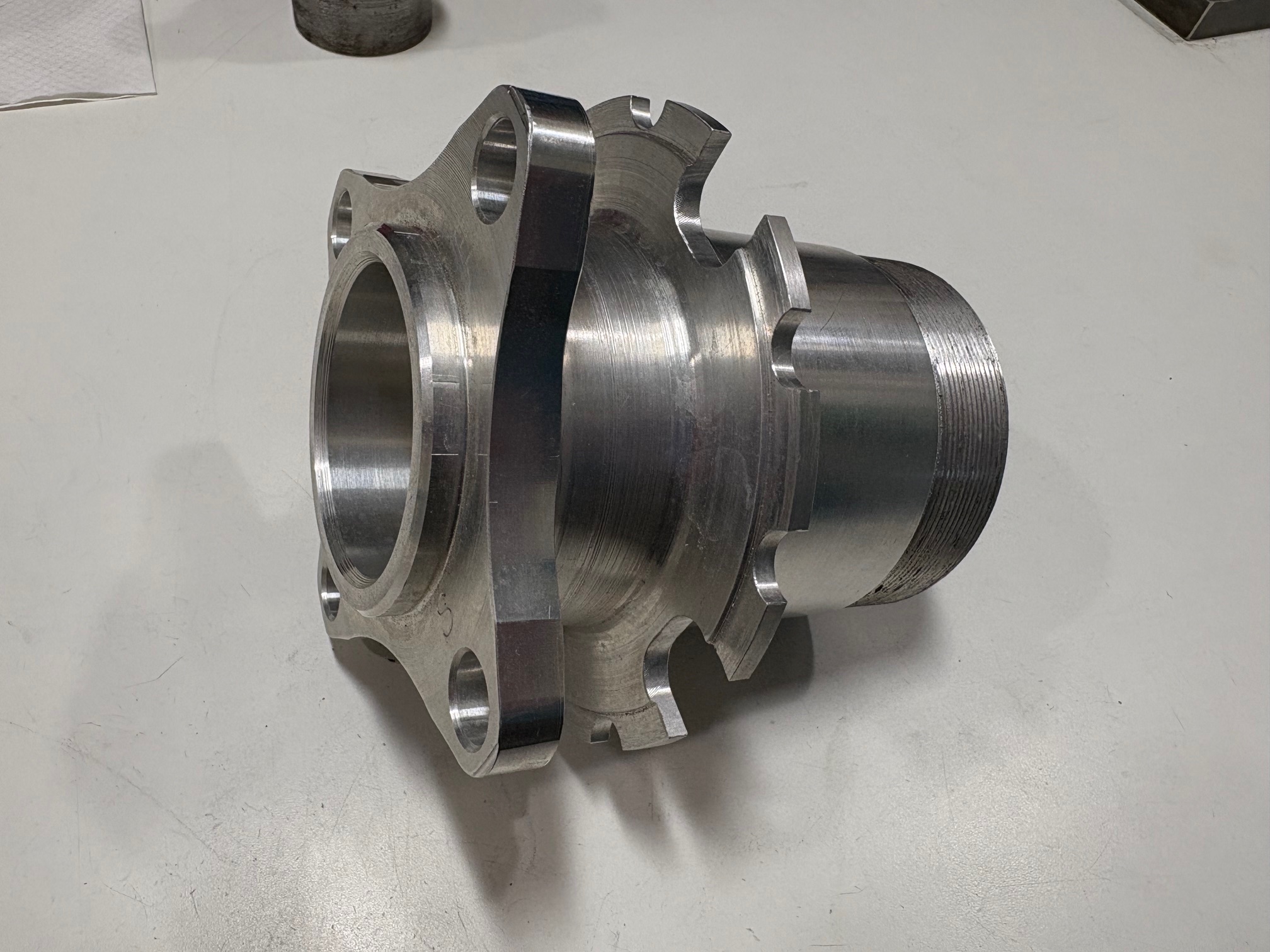

Figures 1 and 2 show the outside features of the parts as turned. This view is identical for all six pieces. I made the two for the front, the two for the rear, and a spare of each to pack in the toolbox in case the worst happened at the track.

This new design embodied the principle of “monolithic integration” or making a single part that performs many jobs at the same time. Instead of bolting flimsy rings of steel to a flange for brake rotors, which in turn was bolted to another part that became the hat/hub/brake rotor, this hub integrated the flanges with the bearing diameter, pre-loading threads, wheel lug flange and the half-shaft input. This single part performed five separate operations all at the same time!
While it may sound wasteful to take a large chunk of stock, in this case a 5" diameter bar saw cut to roughly 6" in length, this method saves the added hardware and weight of redundant parts. Despite the pile of chips and shavings from cutting a half dozen of these things, you must remember two important points:
First, I work in a prototyping shop, and these are acceptable losses in the quest for a successful design.
Second, these parts still retained a substantial amount of the material while weighing in at a fraction of what their predecessors did.
For this part, I started the machining with use of the factory hard jaws on the three-jaw chuck, gripping on the part with a little extra bite while sticking enough of the material out to turn most of the features in one setup before needing to reverse the part to finish it.
As a result of the increased precision and repeatability, I chose to machine these parts in our CNC lathe. I programmed the machine to face the part, turn the OD of the threaded area, the bearing diameter, the shoulders, and the OD for the brake rotor mounting flange. I also programmed the machine to turn the brake rotor flange back a bit past the desired width so I could clean up the back surface in the finishing setup.
Next, I had the machine switch tools and put a small undercut at the end of the threaded shank, so the threading tool had a place to run off.
After that was the threading operation, a custom thread that I will discuss in more depth in another column. The print called for a 2.875"-20 unified thread custom fit to a mating lock nut. I simply touched off the threading tool in my initial setup, told the machine the diameter of the thread and the distance between the threads and the machine spun away, with two additional spring passes to ensure it cleaned up properly.
Our machine is a conversational-type CNC. You simply input your start and end dimensions, and the control calculates tool nose offset and triangulations for you. Great for small lot work, or for those who aren’t savvy with G- and M-Code programming, yet want some CNC capabilities. Being able to put in the diameter, distance between threads, desired spindle speeds and thread lengths with mere numerical decimal values and getting a finished part at the end of the cycle is a big selling point for this type of machine. Since I was using these parts as the thread gauge for the lock nuts, I checked the threads with a pitch gauge and called it good.
The last operation in this setup for the rear wheels is the pilot drill for the half-shaft pocket and grease fitting tap drill. Using the tailstock, I stepped up drill sizes until I reached the diameter of the round-bottom pocket. Then, using a drill that I ground to have a rounded cutting surface instead of the standard drill point tip, I sank that drill to the desired depth. Lastly, I sank the tap drill for a 3/8"-24 UNF thread through the center deep enough that it would open out in the opposing counterbore in the second side. For the front wheel hubs, since they served no power transmission purpose, they were simply drilled and bored out to leave a 0.250" thick wall to the smallest outer diameter feature to give the hubs a high strength-to-weight ratio.
For finishing these parts on the second side, I did not want to use the factory hard jaws on the chuck because I would be gripping the parts on a finished diameter, the bearing surface. I needed a set of custom soft jaws bored out to the diameter of the bearing surface. (To see how we tackled the making of soft jaws for our lathes, see my earlier article “Eccentricity Rings True” in the January 2025 issue.)
On the advice of a coworker who spent many years doing finish and repair work by making soft jaws, I bored the jaws to about 0.002" smaller than the desired diameter, ensuring a strong grip on these hubs as they were being finished.
After taking a skim cut on both the face and the OD of the unfinished side, and setting the tools to it, I programmed the remaining features and let the machine turn all that excess stock into chips. This included the turning of the shoulder for the wheel’s center hub to rest on, the OD for the stud flange, and the undercut between that and the brake rotor flange. For the front wheel hubs, the same bore was cut and match turned as it was on the first side. For the rears, a weight reducing counterbore was sunk in, leaving a wall for the half-shaft to press against and capture the grease for lubricating the half-shaft ends.

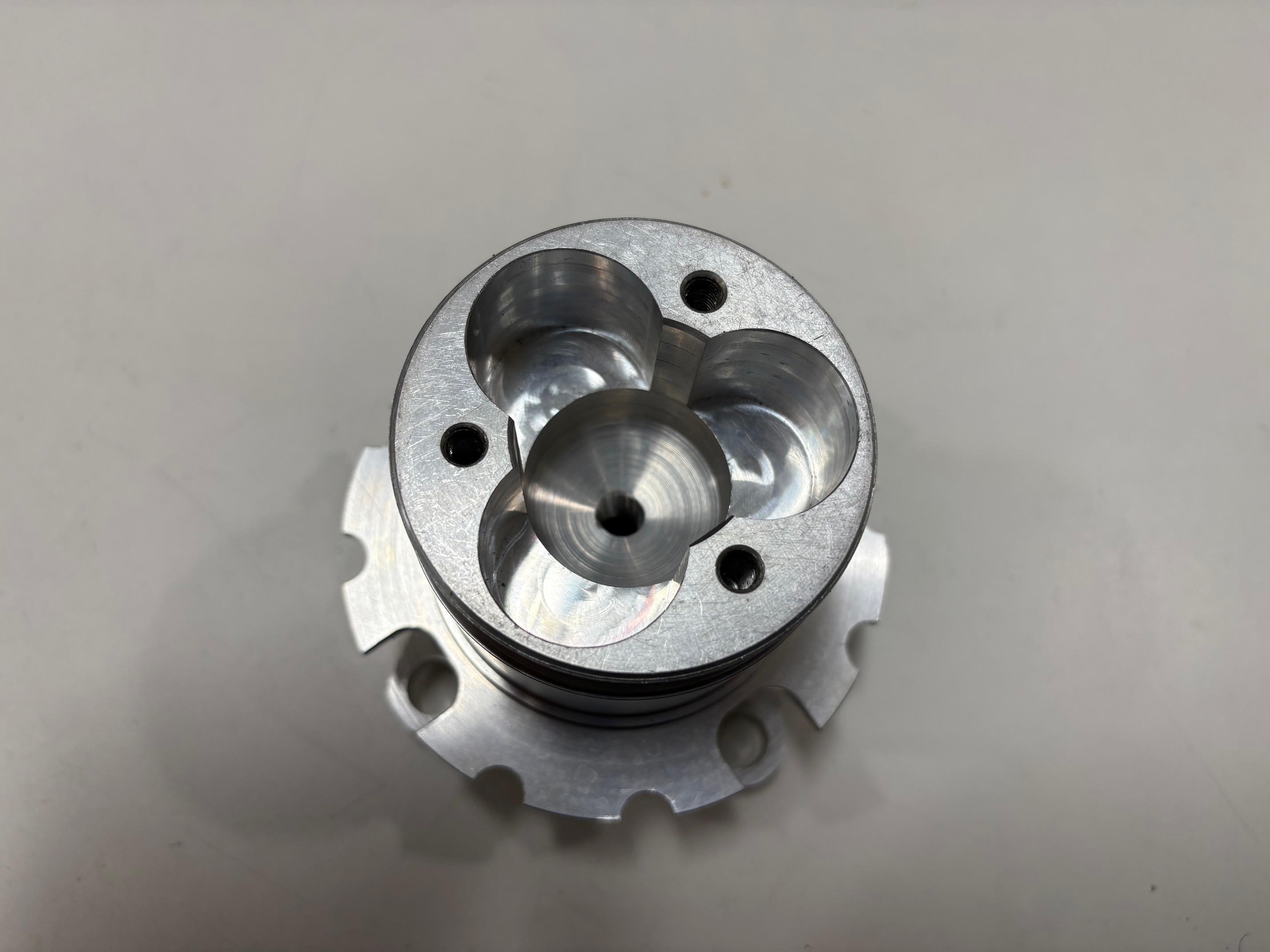

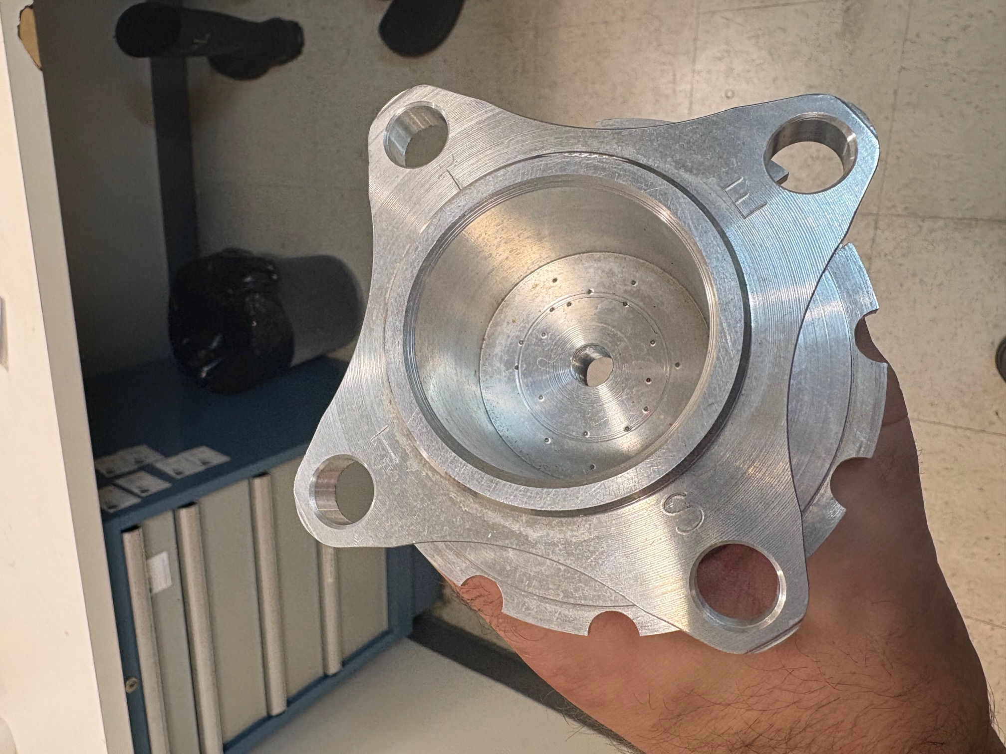

With all the turning completed at this point, all six parts were sent over to our CNC mill to get the holes for the studs and the cutouts for the floating brake rotor pins (see Figure 3). The rears received the three-lobe pockets for the tripod rollers to ride in, as well as the three threaded holes used to hold down the collar that captures it all together (see Figure 4).
