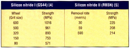

Table 1: Ceramics have different sensitivity to maching conditions.
The maximum mrr, however, can sometimes be limited by factors such as part geometry and the material’s susceptibility to machining-induced damage. Generally, ceramics with large internal flaws are less sensitive to machining-induced damage than ceramics with small internal flaws. This is illustrated in Table 1, where the strength of the hot-pressed Si3N4 (a high-strength ceramic) is much more sensitive to machining conditions than the reaction-bonded Si3N4 (a low-strength ceramic). Because of such limitations and variations, all ceramics must be tested to establish maximum grinding rates.

These results indicate that the influence of process parameters is important. However, to achieve overall cost-effectiveness, a shop must also consider the material’s susceptibility to machining influences. For ceramics with large internal flaws, machining parameters have been found to have no significant influence on flexural strength. This was the finding of research conducted by the National Institute of Standards and Technology’s Ceramic Machining Consortium. For this study, researchers ground reaction-bonded silicon nitride (RBSN) under various conditions.
