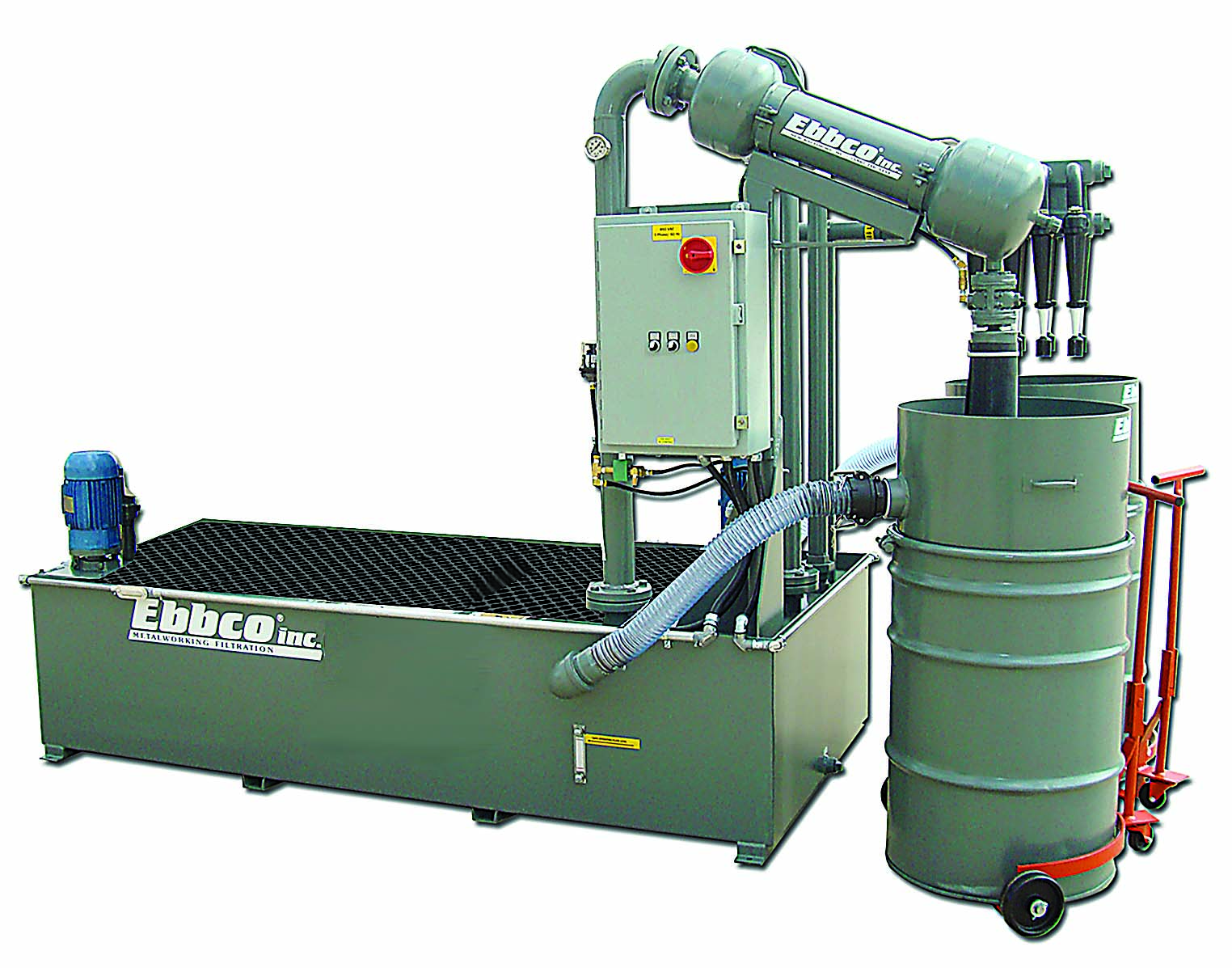

Ebbco’s media-free coolant management system extends coolant life by combining circulation and evacuation to prevent contaminants from accumulating anywhere in the system. Image courtesy of Ebbco.

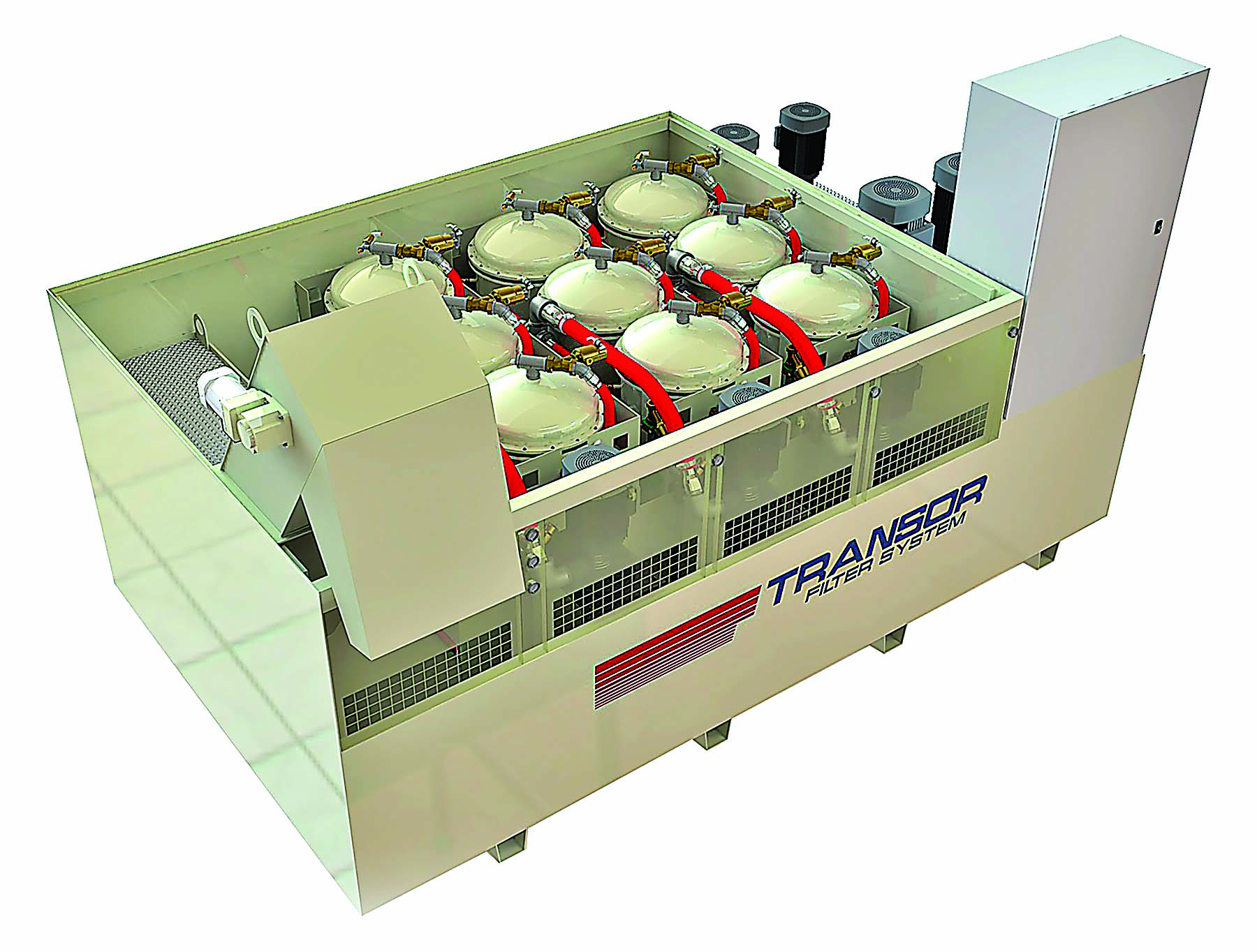

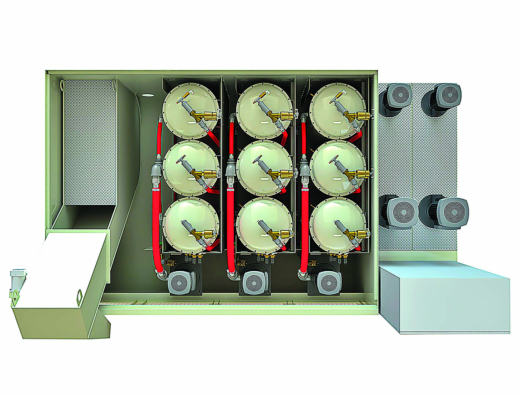

The Transor V-Series provides absolute One Micron Filtration and incorporates a chiller for temperature-controlled oil. Its expandable, modular design enables users to add modules of three filter vessels as their needs grow, within the same footprint. Image courtesy of Transor Filter.

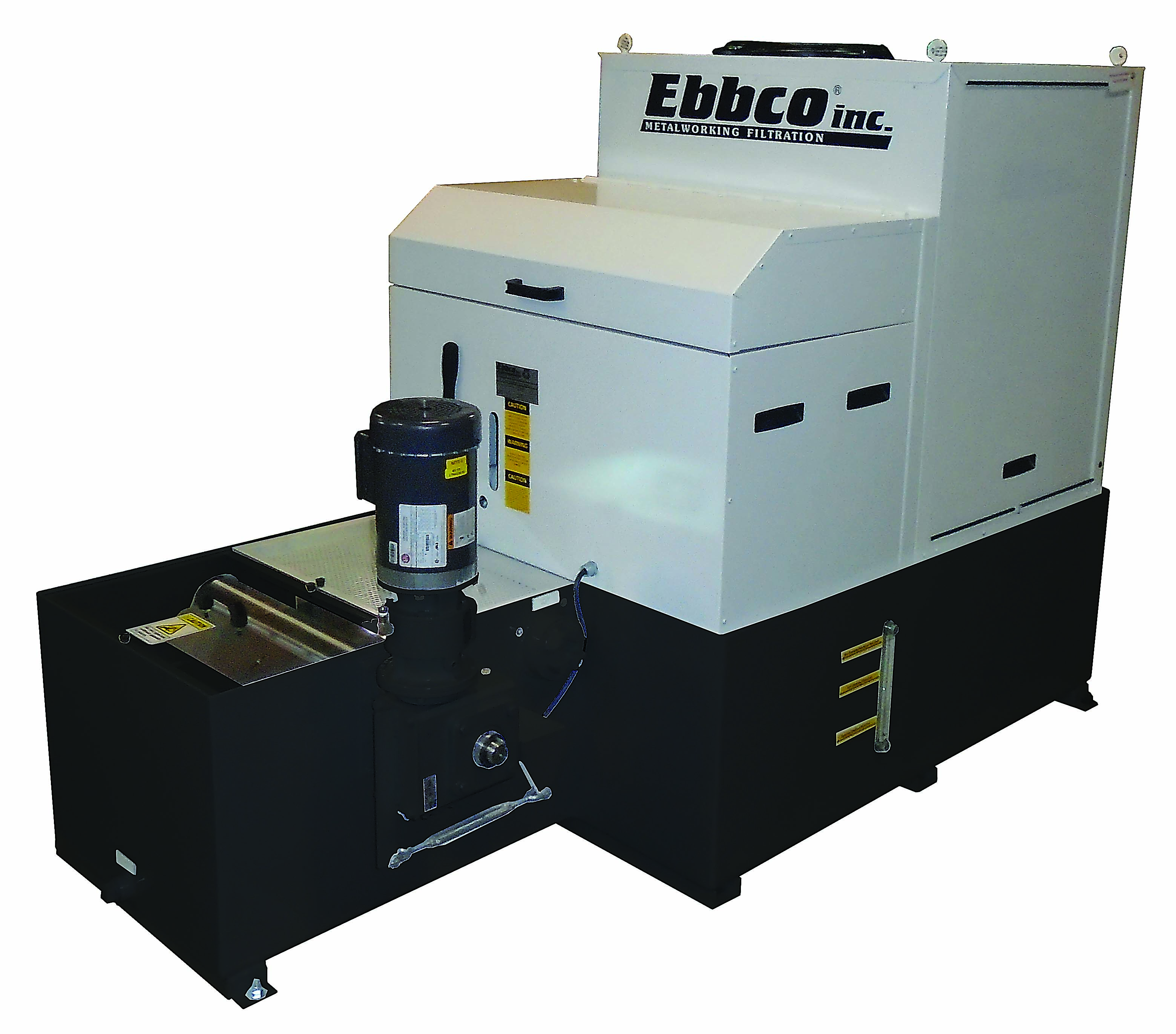

Evolution-series cartridge filtration systems from Ebbco allow filtration down to 0.5µm with multiple pre-filter options, such as this unit’s magnetic pre-filter. Image courtesy of Ebbco.
