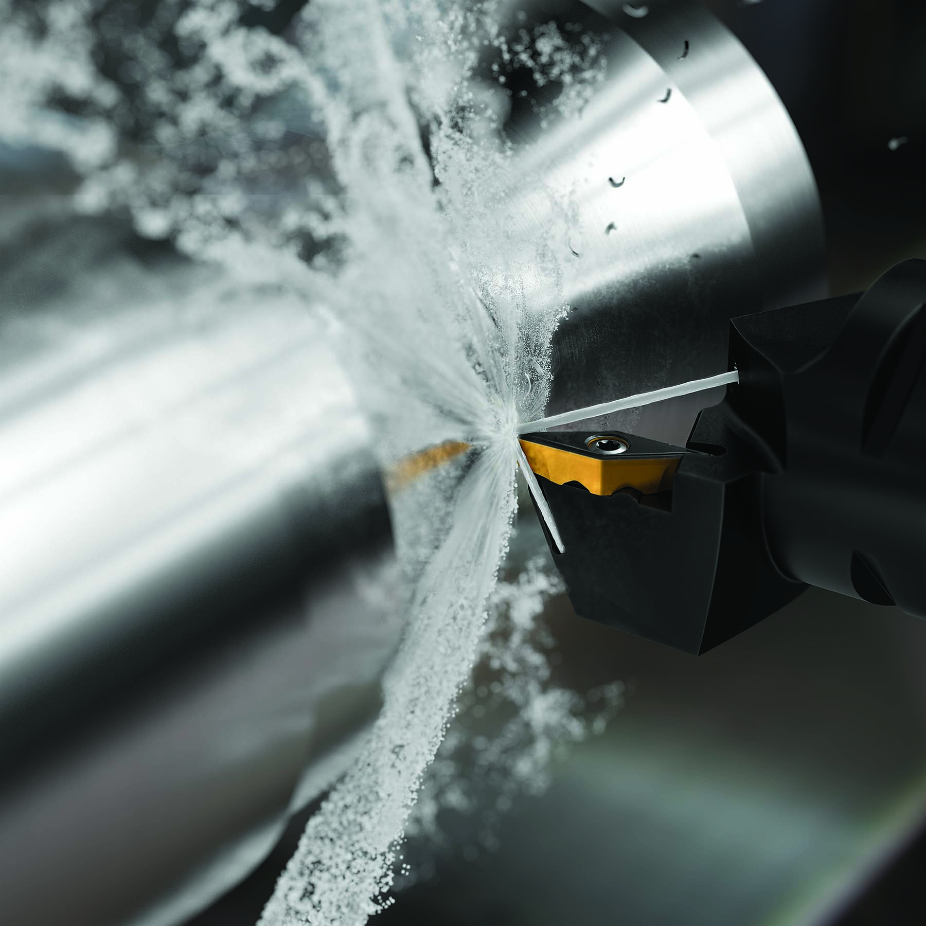

High-pressure coolant helps achieve that need because just applying a stream of coolant or flooding the zone with coolant is insufficient. Creating a parallel hydrolaminar flow with high-speed, high-pressure coolant also can assist with chip formation, said Brent Godfrey, machine integration product specialist at Sandvik Coromant.
“When the coolant nozzle is positioned correctly on the cutting tool,” he said, “you can get the flow of coolant to act almost like a power wedge to curl the chip and help to mechanically break the chip in some materials. In materials like titanium, you can effectively break chips with high-pressure coolant, which is a good problem-solver on those materials.”
Machining aerospace materials can be difficult, but tools and techniques are available to help.
Machining aerospace materials can be difficult, but tools and techniques are available to help. Image courtesy of Sandvik Coromant
The minimum pressure on a standard high-pressure pump on many machine tools is about 69 bar (1,000 psi), Godfrey said, but pumps are available, such as on some vertical lathes, that go to 172 to 207 bar (2,500 to 3,000 psi).
