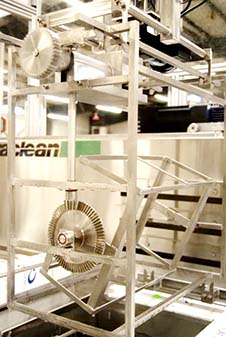

Aqueous immersion parts cleaners, such as this one from Miraclean, can offer multiple wash stations
and full automation. Image courtesy of Miraclean.

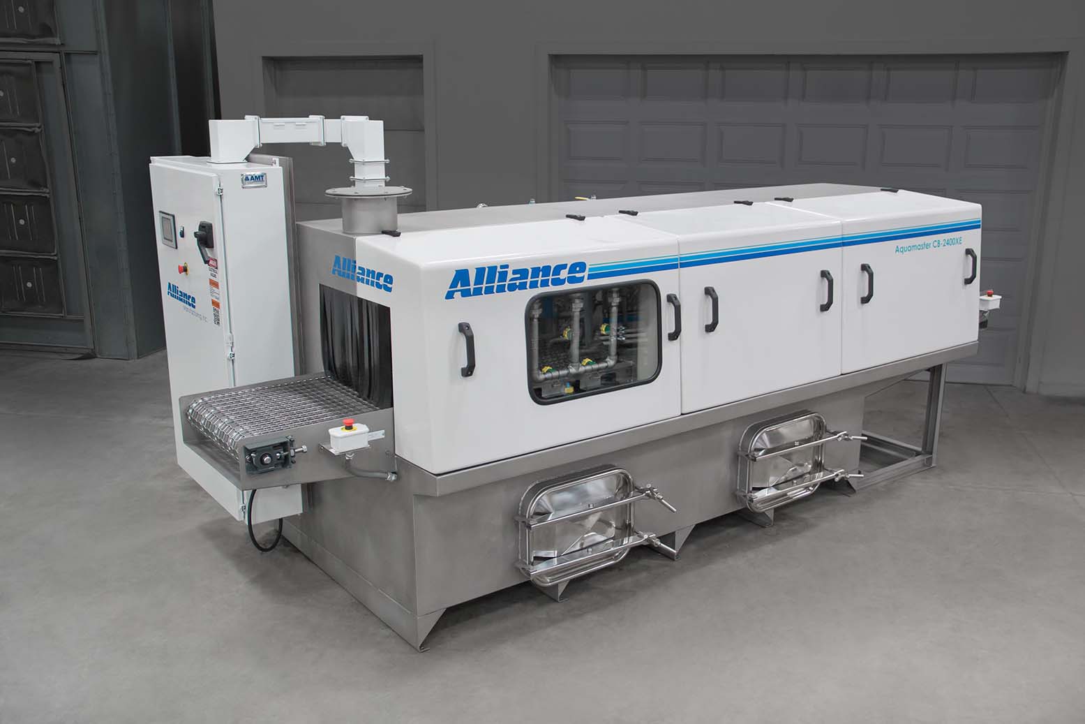

There are two types of aqueous parts-cleaning systems: spray and immersion. Spray systems typically involve high-pressure water streams directed at parts moving on a conveyor, while immersion cleaning involves submerging parts in various bath stations. Both methods have advantages.
“In a lot of cases, we prefer spray washing,” said Alliance’s Manninen. Spray washing can be performed in either a batch or continuous process. “It combines chemistry and heat in a very different way, and the mechanical agitation is built in. The continuous-spray washing process offers an advantage in that it’s typically faster in terms of throughput, because the parts are constantly moving on a conveyor belt or other conveying method. In batch-based immersion systems, you can only have so many parts in the bath at a time and contaminants that are removed can be redeposited onto the parts.”
Alliance Manufacturing offers spray cleaning systems, which typically feature faster
through put than batch/immersion systems. Image courtesy of Alliance Manufacturing.
Miraclean, Ashville, N.Y., manufactures immersion systems, with an emphasis on automation and ultrasonic agitation. While the parts-cleaning approach a manufacturer takes has historically been determined by a combination of part substrate, type of soiling agent and part geometry, many companies today—especially in industries such as medical and aerospace—have validation specifications that must be factored into the process as well, according to Cheryl Larkin, marketing manager at Miraclean.
“As requirements get more sophisticated, the value of an automated system that controls everything and can track each part’s journey through the system … becomes more apparent,” she said. “That way, if there is ever a question about a particular lot of parts, you know exactly what they went through in your care.”

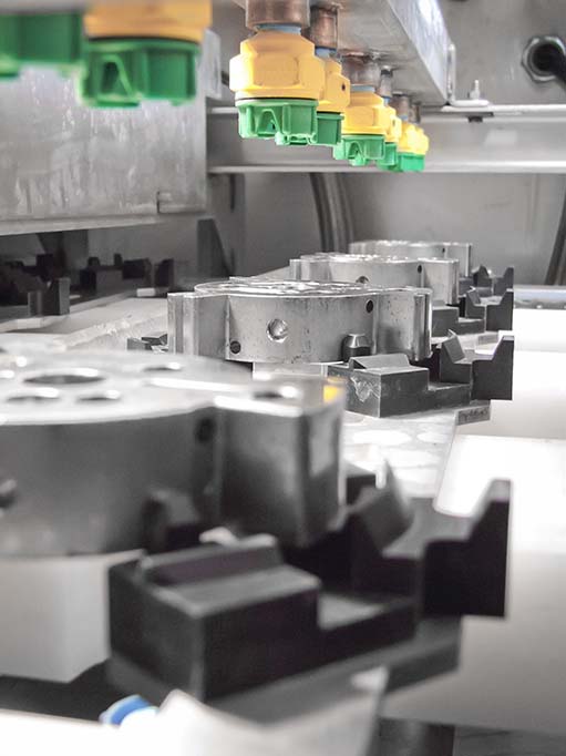

The conveyor belt on spray cleaning systems can be programmed to slow or stop at predetermined points
to ensure crucial surfaces are cleaned. Image courtesy of Alliance Manufacturing.
“We can customize a chemical agent, we can customize specific mechanical actions, we can even customize fixturing for parts going into the baths,” Larkin said. “In that way, we can present the soiling agent to the cleaning solution in such a way that even complex geometries can be cleaned in a production environment.” While it’s a simple concept in theory, she said something that is successful in small-batch testing frequently doesn’t work with high volumes of parts. Alliance, while also making use of advanced chemistries, has realized the potential of automated work cells in parts cleaning. In this way, cleaning can be accomplished unmanned.
“The biggest advantage to automation comes when you get into indexing,” Manninen said, which involves securing parts in fixtures and placing them on a conveyer. “The advantage to indexing is that, as the part moves along the conveyor, you can stop it at specific points to ensure certain facets of the geometry are hit with cleaning fluid. We have made huge advances in terms of fixturing and indexing, which allows us to achieve a very precise and critical cleaning process using, essentially, water.”
