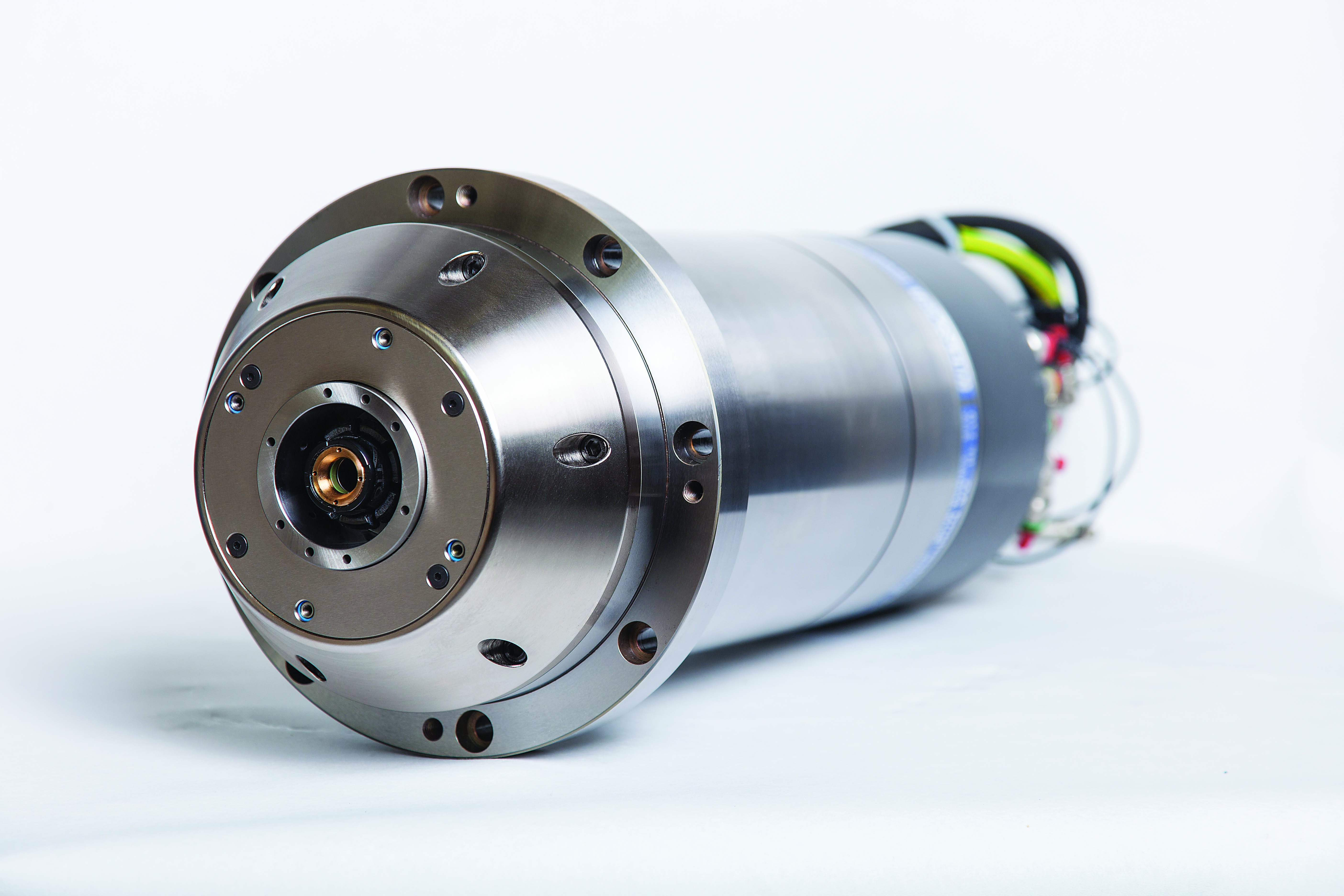

Alternatives to steep tapers
HSK spindles, like the one shown in the illustration above, offer advantages steep-taper styles can’t. Image courtesy of IBAG North America.

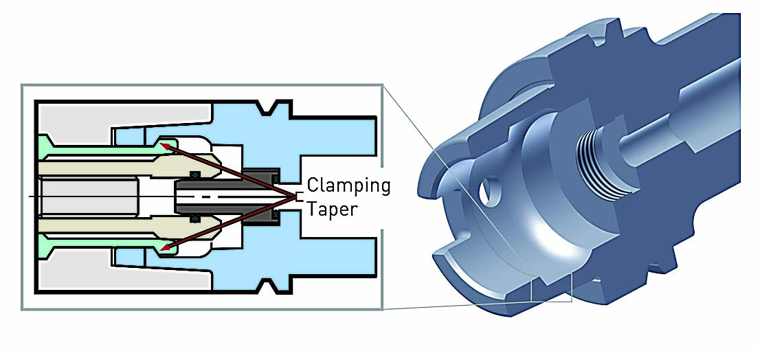

Unlike CAT, BT and BIG-PLUS, which have solid bodies, HSK and other hollow toolholders expand along with the spindle cartridge as the rpm increases. This alone improves accuracy and rigidity at elevated spindle speeds, but these systems also incorporate dual face and taper contact, similar to BIG-PLUS. They’re also much lighter than solid-body designs, making them more suitable for extreme spindle speeds.

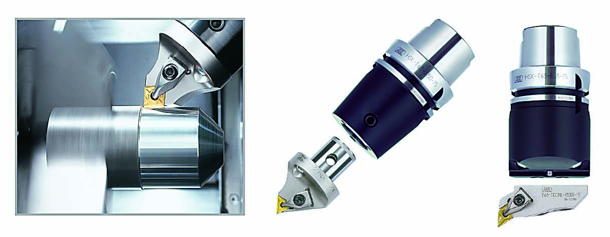

HSK is available in six styles, HSK-A through HSK-F, as well as the newest style, HSK-T, which is specifically for multitask, or mill-turn, machines. Common sizes range from 32mm (1.259″) to 125mm (4.921″), as measured at the face diameter, with some capable of running at 50,000 rpm or higher. Dual-contact designs such as this are more difficult to produce, requiring extreme accuracy in toolholder and spindle taper alike. There is also a new U.S. standard for HSK, recently published by ASME.

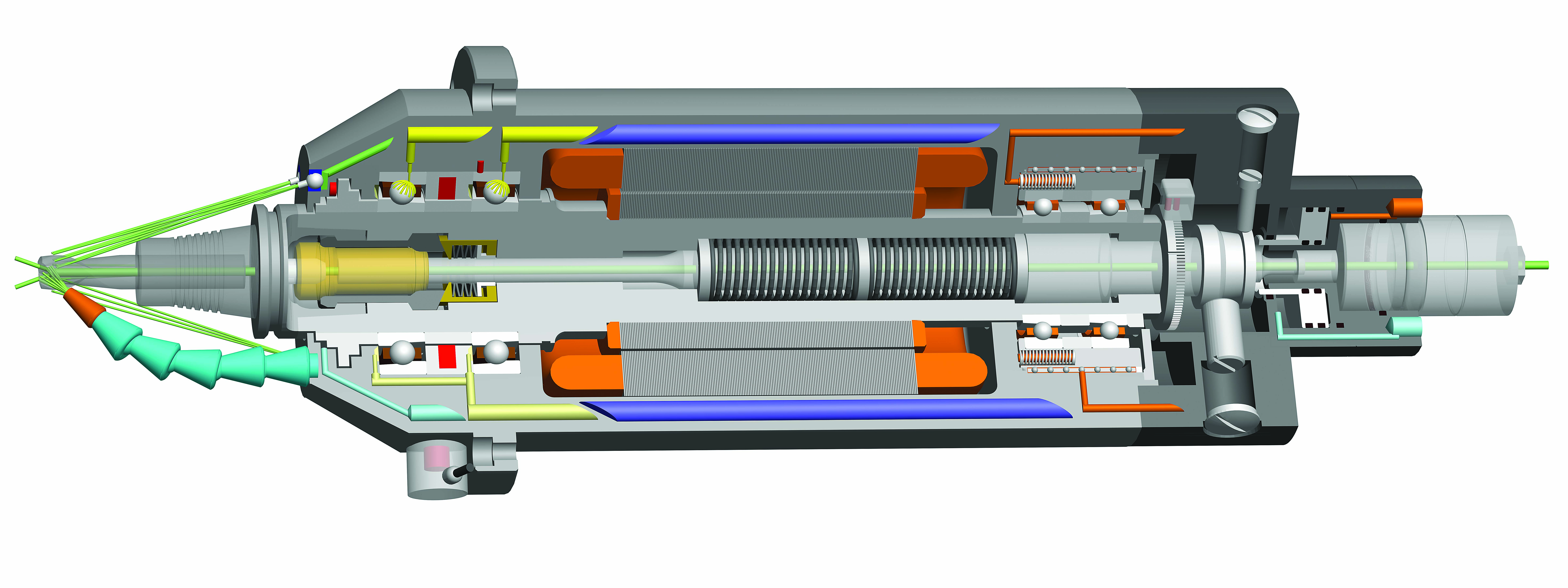

Modern spindles are capable of high spindle speeds and extreme accuracy. Image courtesy of IBAG North America.

The HSK-T standard was developed specifically for multitask machines. Image courtesy of BIG KAISER Precision Tooling.

Bill Popoli, president of IBAG North America, North Haven, Conn., said the company started building steep-taper spindles in the late ’80s, but 95 percent of its work has since transitioned to HSK spindles. As mentioned earlier, the extreme accuracy needed to guarantee near-simultaneous contact between the spindle face and taper is challenging, requiring micron-level tolerances in toolholder and spindle alike.
These requirements were impossible to meet when steep taper was first developed, Popoli said, resulting in looser standards overall for CAT and BT spindles than the ones applied to HSK spindles and toolholders. Because of this, purchasing an HSK or equivalent toolholder automatically makes one “part of the club” when it comes to balance, accuracy, repeatability and tool life.

The clamping mechanism for HSK toolholders is distinctly different from that of steep-taper holders. Image courtesy of BIG KAISER Precision Tooling.
