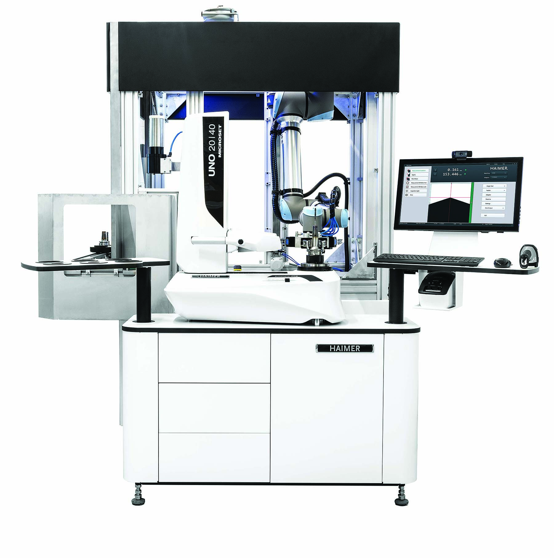

At IMTS 2022, Haimer showed a shrink-fit and presetting Automation Cube, which can incorporate a balancing machine if required.
At IMTS 2022, Haimer showed a shrink-fit and presetting Automation Cube, which can incorporate a balancing machine if required. Image courtesy of Haimer

In 2021 at EMO Milano and in 2022 at IMTS in Chicago, Haimer presented a much more far-reaching solution: the Shrink Automation Cube. This automated shrink station contains a collaborative robot that supports shrinking and unshrinking of tools with highly accurate length repeatability. The cell is scalable according to the requirements of a customer. The cube is controlled by Data Analyzer and Controller tool management, and Haimer’s presetting and balancing technology can be integrated into the cube. A scanner for reading out unique tool combinations and a conveyor belt that is variable in length are also available.
Such equipment allows the following procedure to be carried out, for example: The operator places a worn-out tool — consisting of a toolholder and a cutting tool — on the conveyor belt and provides a new cutting tool. The cobot picks up the complete toolholder assembly and identifies it via its unique data matrix code, optionally via RFID. The cobot then picks up the new cutting tool and measures the cutting edge. In the meantime, the coil moves onto the worn-out toolholder assembly, unshrinks the old cutting tool and then shrinks the new one to the required projection length. After air cooling, the new, complete tool is ready for use, and the old cutting tool is disposed of.
