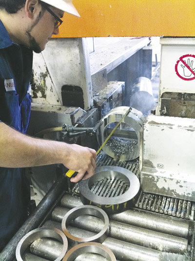

Whether it’s machined components or sawed metal bars, customers want short lead times. On the flipside, the manufacturers producing the parts and bars desire long tool life while satisfying their customers’ expectations.
Special Quality Alloys Inc., a Humble, Texas, distributor of bars and forgings, understands those requirements. The company has three bandsaws to cut precipitation-hardened stainless steel and nickel-base superalloy bars from ½” to 19″ (12.7mm to 482.6mm) in diameter with a hardness from 22 to 40 HRC, said Marco Deuterio, company president.
“We want to offer our customers good lead times. Having good saw blades and good equipment allows us to do that,” said Jimmy Carlile, SQA’s technical manager.
In a move aimed at improving bandsaw blade life, SQA allowed Houston-based distributor Industrial Diamond Products Co. Inc. to visit and test the SineWave blade from Simonds Saw, Fitchburg, Mass.

Special Quality Alloys applies SineWave bandsaw blades from Simonds to reduce cycle times while extending blade life. Image courtesy Special Quality Alloys.

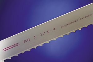

A Simonds blade that can be SineWave-customized. Image courtesy Simonds Saw.

According to Simonds, its Sine-Wave blade technology features a series of tapered ramps on the back of the blade to create a rocking motion and broaching-type action in the cut for significantly faster sawing, smoother finishes, longer blade life and up to 75 percent less material waste than abrasive-cutoff methods. In addition, the technology exerts more force in the cut without having to increase machine pressure and provides ramp customization to optimize the performance when cutting a specific alloy.
Deuterio pointed out that the triple-chip, carbide-tipped SineWave blades are more expensive than conventional bimetal and carbide-tipped blades, but their ability to reduce cycle times by an estimated 30 percent or more when sawing challenging workpiece materials convinced SQA that they are worth it. “We decided we would rather go with the more-expensive blade that has a longer life and can cut through the metal than buy a cheaper blade and replace it more often,” he said.
With the SineWave technology, Deuterio said SQA tries to achieve the most-effective combination of cutting speed and blade life. “I want to reach a balance where I can get the most out of the blade but also cut fast.”
To help with that effort, Carlile said Simonds and Industrial Diamond visited SQA to educate its employees about how to better operate the company’s bandsaws, effectively monitor sawing operations and offer different blade options.
Since switching to SineWave blades, Deuterio said SQA has tested at least six or seven different blades from other manufacturers but none performed better than SineWave. Operators also sense a big difference with SineWave—sawing is faster, more aggressive and smoother.
Deuterio pointed out that if and when there are any issues with cutting performance, Industrial Diamond and Simonds personnel have always been prompt in coming onsite to investigate. In addition, they have supported SQA in blade studies to help determine optimal performance based on material grades and dimensions.
