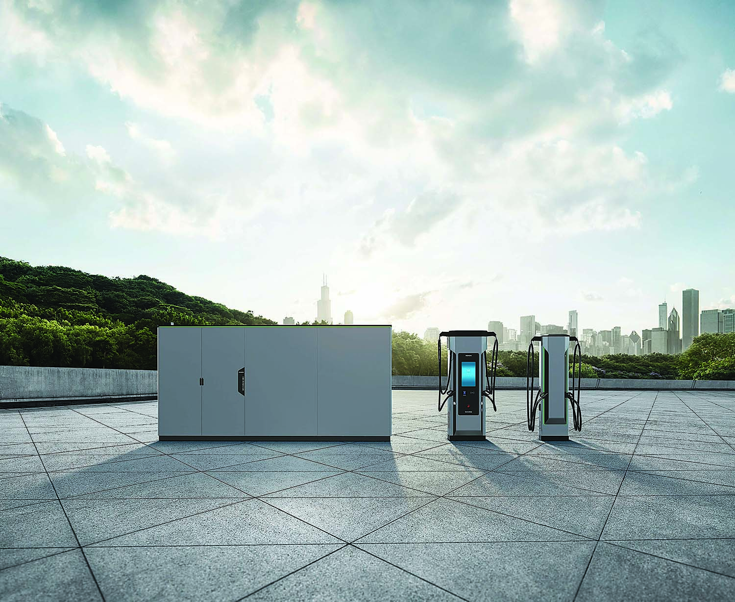

An image of Siemens’ Sicharge D and SiE storage dispenser. Sicharge D is a companion for electric vehicle charging that features a power range of up to 300 kW DC. Image courtesy of Siemens”>
