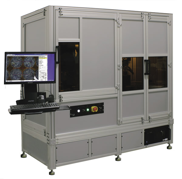

PhotoMachining’s three-wavelength, ultrashort-pulse micromachining system can drill high-density holes in polymers. Image courtesy PhotoMachining.

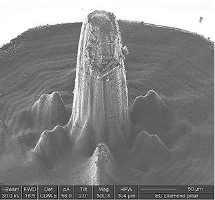

Machining the hardest known substance, diamond, is possible with lasers. Here, a pillar is built by removing the surrounding area. Image courtesy Newson USA.

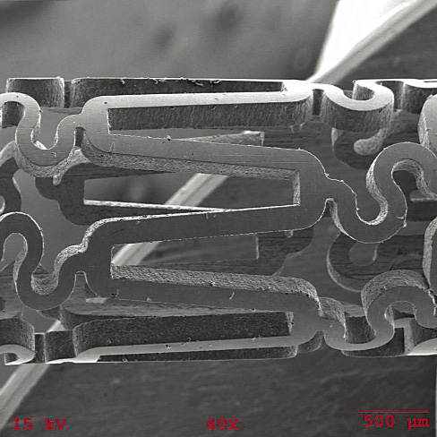

The cross sections of this laser-machined Nitinol stent measure 150µm (0.0059″) across. Image courtesy LPL Systems.
