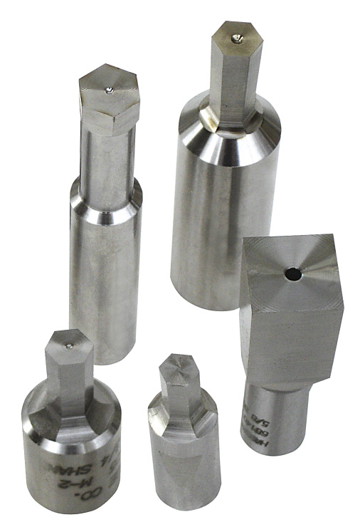

A sample of hexagon and square rotary broach tools.

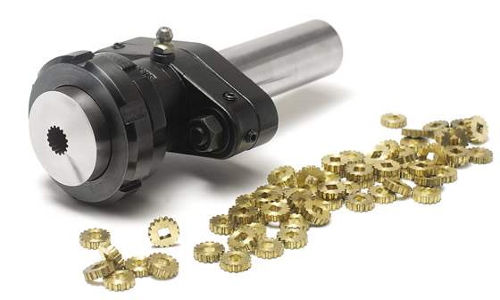

Rotary broaching requires two components: a toolholder specifically for rotary broaching and a broach tool. The rotary broach holder incorporates an internal live spindle, or free-spinning bearing, that holds the broach at a 1° angle relative to the centerline of the workpiece. While either the machine spindle or the toolholder body is rotating, pressure on each corner of the broach is constantly changing. This creates a chisel-type shearing action, cutting one corner at a time as the broach is fed through the workpiece to the desired depth.

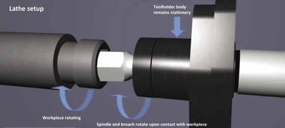

In a turning machine, the toolholder body is stationary while its internal live spindle and the broach rotate, driven by the workpiece (see graphic on next page). Because the workpiece drives the broach, the process does not require live tooling. In a milling machine, the toolholder is mounted in and rotates with the machine spindle while the internal live spindle and broach remain stationary.

This rotary broach toolholder and broach tool created these small brass parts with a square internal form and spline-shaped external form.

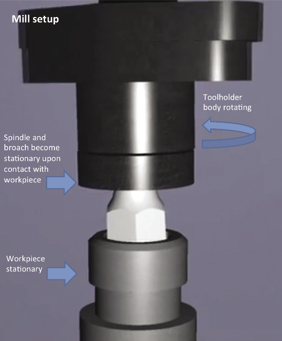

In a lathe (above), the rotary broach toolholder body is stationary, while its internal live spindle and broach rotate upon contact with the rotating workpiece. In a mill (below), the toolholder body rotates and the workpiece is stationary, while the spindle and broach become stationary upon contact with the workpiece.

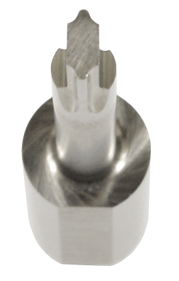

Index broaching is an alternative to full-form internal rotary broaching and involves a stationary spindle and a partial form of the shape to be generated. Once hole preparation is completed, the polygon-shaped form is generated on the machine tool by making imprints of the form to the proper depth while the part is indexed to create the full form. Index broaching is performed on Swiss-style machines and is most effective at hole diameters of 3/8” (9.525mm) and under.

An index broach cuts a portion of the form as the part is indexed to produce the full form.
“Rather than cutting the entire form at once, the tool is only cutting a portion of the form,” said Bill Fletcher, vice president of sales and marketing, Hassay Savage Co. “You are basically punching. You drive the index broach into the workpiece, make an impression, remove it, index the part, reenter the hole and make the second impression, come back out, rotate the part and cut a third impression. The cut is broken into three separate sections to get the full geometry.”

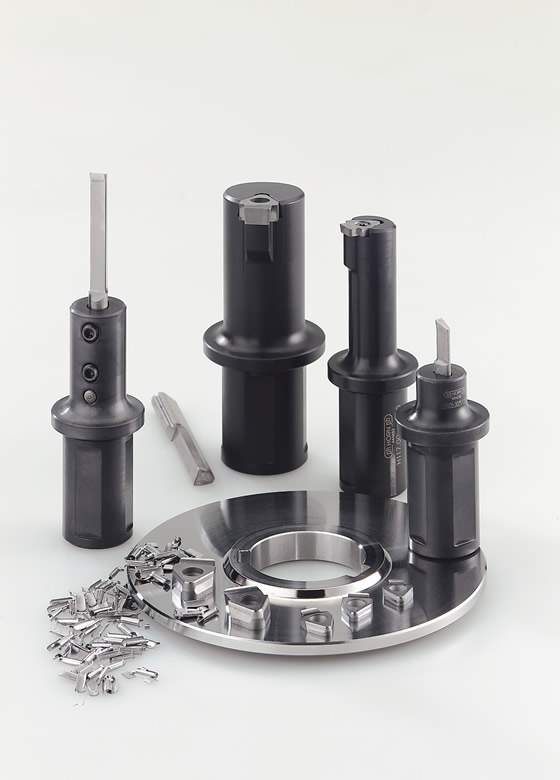

An option for producing polygon-shaped forms is using an insertable, single-point broaching tool. The single-point tool does not produce the whole form at once. Rather, it removes 0.001″ to 0.003″ (0.0254mm to 0.0762mm) of material during each pass.
“We consider it broaching because it is essentially shaving the part to the form we want to produce,” said Jason Farthing, marketing and sales coordinator for toolmaker Horn USA Inc., Franklin, Tenn. “With each pass, the tool gets farther and farther away from centerline on the X-axis and closer to the chuck until it reaches the required depth. This decreases tool pressure and the required machine horsepower because it is not cutting all that material at one time.”

Horn USA’s insertable, single-point broaching tools remove a minimal amount of material during each pass.
Standard single-point tools are used to broach keyways, hex shapes and lobular sockets, and specials can be ordered for internal and external applications. Standard tools are available with up to a 4.5:1 ratio for the tool length to bore ID.
Like a rotary broach, a single-point broaching tool can be applied on lathes and milling machines. “The tool allows users to eliminate secondary operations or the need to subcontract work,” Farthing said.
