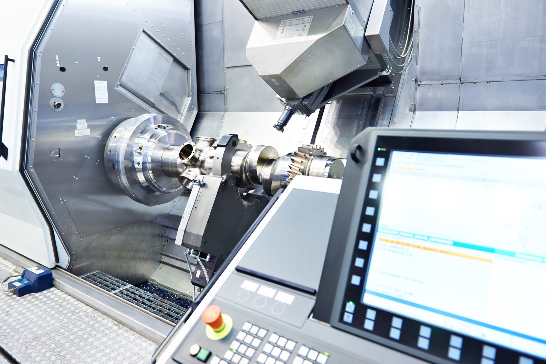

Traditional and CNC-based broaching approaches each have application-specific strengths. Credit: Adobe Stock
Machine builders routinely provide machines with increased capabilities that address the needs of shops that are dealing with a growing skills gap. Builders are offering non-traditional machine tools and methods that allow programmers and engineers to create part geometries in one machine that would have taken two or three machines in the past.
Broaching is one of the old-school machining operations that machine builders and tooling companies have successfully transitioned to modern CNC machines. Tooling manufacturers are making indexable tools that can be held in the turret or spindle and used to create keyways, splines and other geometry that has been traditionally broached.
These new tools are fascinating to watch and, from this perspective, seem to be capable. Like most things in machining, there are going to be some trade-offs. Transitioning from traditional broaching tools to the newer tools is not a straightforward decision and requires consideration of several factors.

When using some of the newer tools and techniques, like the broach tools held in a lathe turret, it is easy to see how tool offsets, part runout, and similar settings could cause dimensional issues. A few thousandths off center could keep a gear or pulley from aligning to the keyway on a shaft. A small amount of error in the indexing angle of a spindle axis can throw off internal splines when using the new tools that require the part to be indexed. If the tool is not set square to the machining axis, the broached feature will not be properly aligned, thereby generating improper part geometry.

Broaching inside the CNC machine reduces or eliminates the need for handling. A lathe with a bar feeder and parts catcher can easily be set up to make complete parts. It can’t be stressed enough that reduced handling dramatically reduces the opportunities for quality problems and lost productivity associated with fingerprints. These costs, while difficult to calculate, are an important consideration. Making a complete part in one setup is the primary advantage of the newer tools. This one characteristic might be significant enough to discount all of the disadvantages associated with broaching inside the machine.
