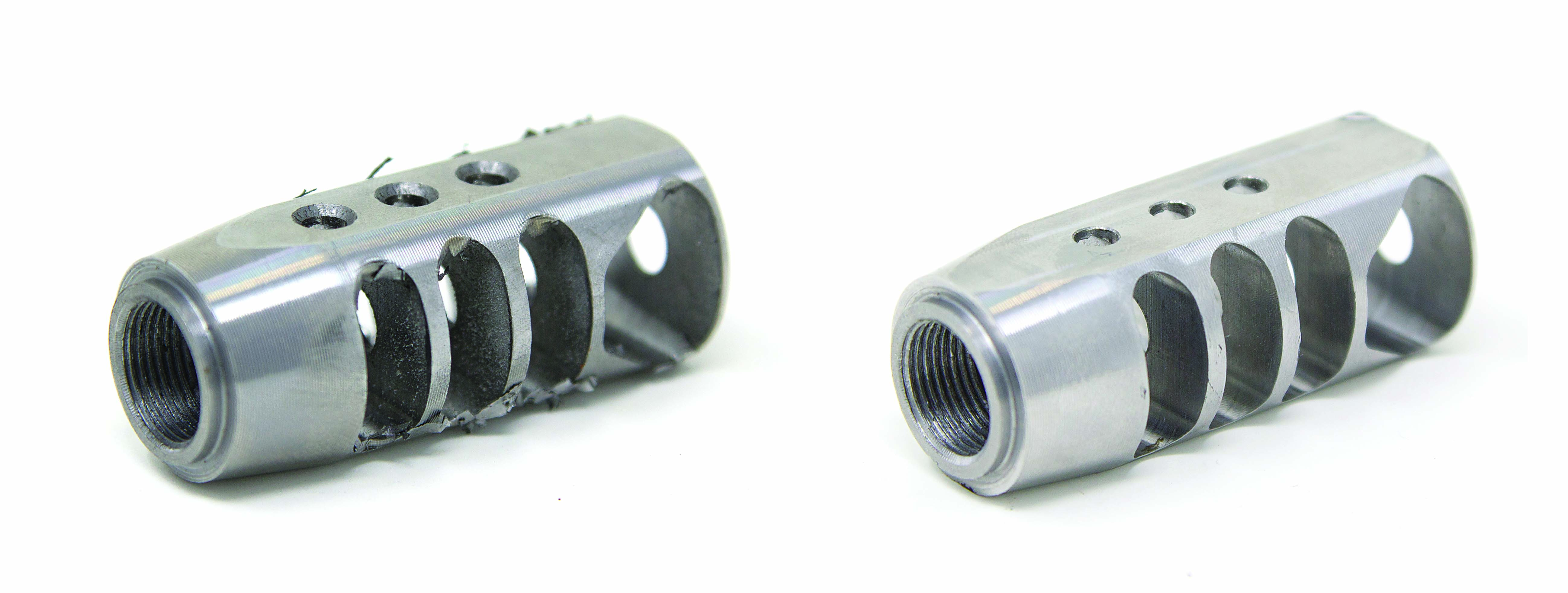

JR Precision & Welding LLC generates light, medium and heavy burrs when machining 4140 steel muzzle brakes. Removing the burrs is challenging, said James Mawazeb, director of operations and lead engineer at the Houston-based machine shop, which was founded in 2017.
A muzzle brake, or compensator, is a device connected to the barrel of a rifle or pistol to help control recoil and the rising of the barrel that normally occurs after firing. Muzzle brakes utilize slots, vents, holes, baffles or similar features to redirect a portion of propellant gases to counter recoil. Burrs form on the oval-shaped gas ports of parts.
Mawazeb said the shop initially took additional passes with the cutting tools that had been used to machine the parts.
“It never helped us remove any of the burrs,” he said.
JR Precision & Welding next sought whether another company could deburr the parts with aluminum-oxide sandblasting or even glass beads, but the processes proved ineffective, Mawazeb said.
A 4140 steel muzzle brake is shown before and after deburring. image courtesy of JR Precision & Welding
Manually deburring light burrs with a hook-shaped deburring tool and removing large burrs with a Dremel rotary power tool outfitted with a sander were effective but inefficient methods.
“We pumped out 500 parts within about 10 days,” Mawazeb said, “and it took us an extra six days just to deburr all those parts. Even after we got done with deburring them, I still had to make sure every part was right. A lot of people consider me a stickler for that, but if you are going to put your name on a product, you have to make sure it’s right.”
He defined a light burr as one that can be removed with a thumbnail and said large burrs can’t be. The largest burrs the shop sees are about 3.175 mm (0.125″) high.
Adding to the challenge was that the bar stock JR Precision & Welding previously machined was from a supplier that sold only heat-treated 4140 steel bars, Mawazeb said. The shop eventually switched to a supplier of annealed stock, which is easier to machine and deburr.

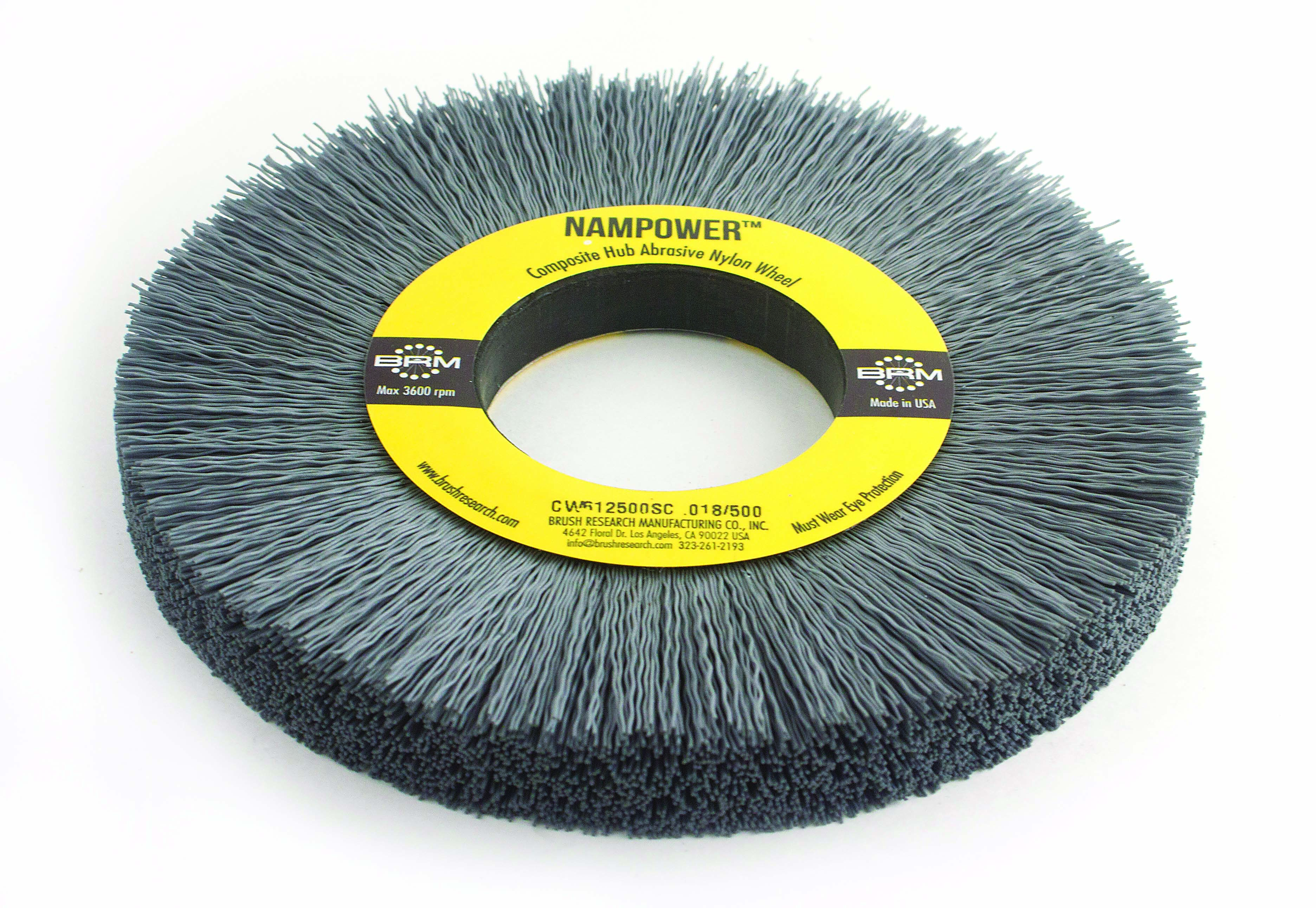

By switching from a four-flute endmill to a five-flute endmill, JR Precision & Welding reduced average burr size but still needed an efficient solution. Bass Tool & Supply recommended an abrasive brush from another toolmaker that the distributor carries: Los Angeles-based Brush Research Manufacturing Co. Inc. He wasn’t convinced that a different brush would do the job but sent parts to test at Brush Research Manufacturing’s surface finishing laboratory. After a test in which an abrasive disc brush didn’t sufficiently remove burrs, Brush Research Manufacturing deburred a part with a 152.4 mm-dia. (6″-dia.) abrasive nylon wheel brush that has filaments made of silicon carbide.”It was able to easily get into the slots, push the burrs out and remove them,” said Elysha Cole, product support specialist at Brush Research Manufacturing.
The filaments self-sharpen. As a brush contacts a work surface, filament grit wears off and exposes new cutting particles. This action enables a brush to remain sharp even after repeated use.
After the concept was proven in a lab, JR Precision & Welding purchased an 80-grit 76.2 mm-dia. (3″-dia.) brush. The shorter trim fill has less give and delivers a more aggressive deburring force than the larger version. In addition to removing midsize and large burrs without altering the surface finish, the brush provides a soft edge break to the four gas ports so they are not razor sharp. Mawazeb said deburring a part with the brush takes about a minute. The shop purchased the brush in August and had yet to replace the brush after months of use.
To remove light burrs, it’s more efficient to run a secondary operation using a 4.7625 mm-dia. (0.1875″-dia.) two-flute chamfering tool, which would break when removing heavier burrs, he said.
