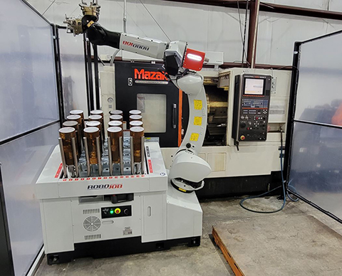

Automated systems can operate at higher speeds, perform tasks simultaneously and optimize resource utilization. Image courtesy of C. Zoberis
