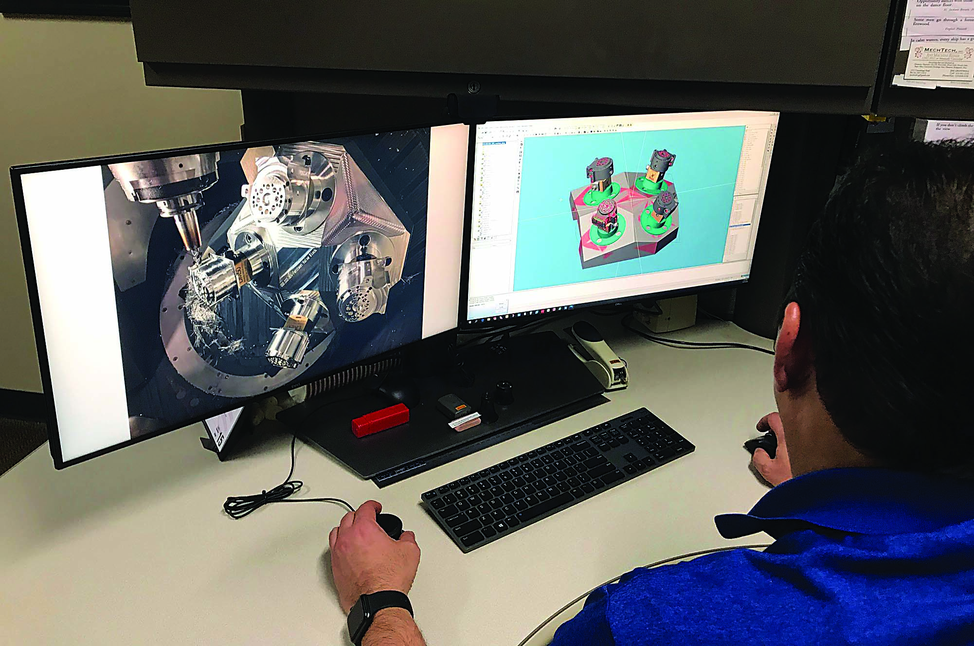

Esprit CAM can keep up with Holmatro’s high demands. Image courtesy of Espirt CAM

“We periodically check in with our team to ensure Esprit is evolving with our needs,” said Manufacturing Engineer Chuck Cain. “Esprit was very good at multifunction machining when we bought it in 1999. A few years ago, we reviewed many other CAM packages to evaluate if we were keeping up with the times. After many demos, we concluded that Esprit was still the best choice for us. We ended up adding multiple seats of Esprit to our facility in the Netherlands.”
Holmatro’s U.S. headquarters houses more than 30 CNC machines, ranging from nine-axis mill/turn to five-axis simultaneous equipment, mostly made by DMG Mori USA Inc. and Okuma America Corp. Holmatro uses incredibly demanding processes to get the job done. Because a lot of the products save lives, there’s no room for error.
“The parts that we manufacture are complex due to the nature of manufacturing parts to such close tolerances,” Cain said. “A typical product will have tolerances not to exceed 30 µm (0.001″). We also have many products with 20 µm (0.0008″) tolerances.”
Holmatro regularly uses Esprit CAM to quickly manufacture fixtures and program parts on five-axis milling machines.
“We were able to save approximately 30 minutes per part by utilizing a 3+2 machining mentality,” Cain said. “ProfitMilling also helped with cycle time reduction.”
