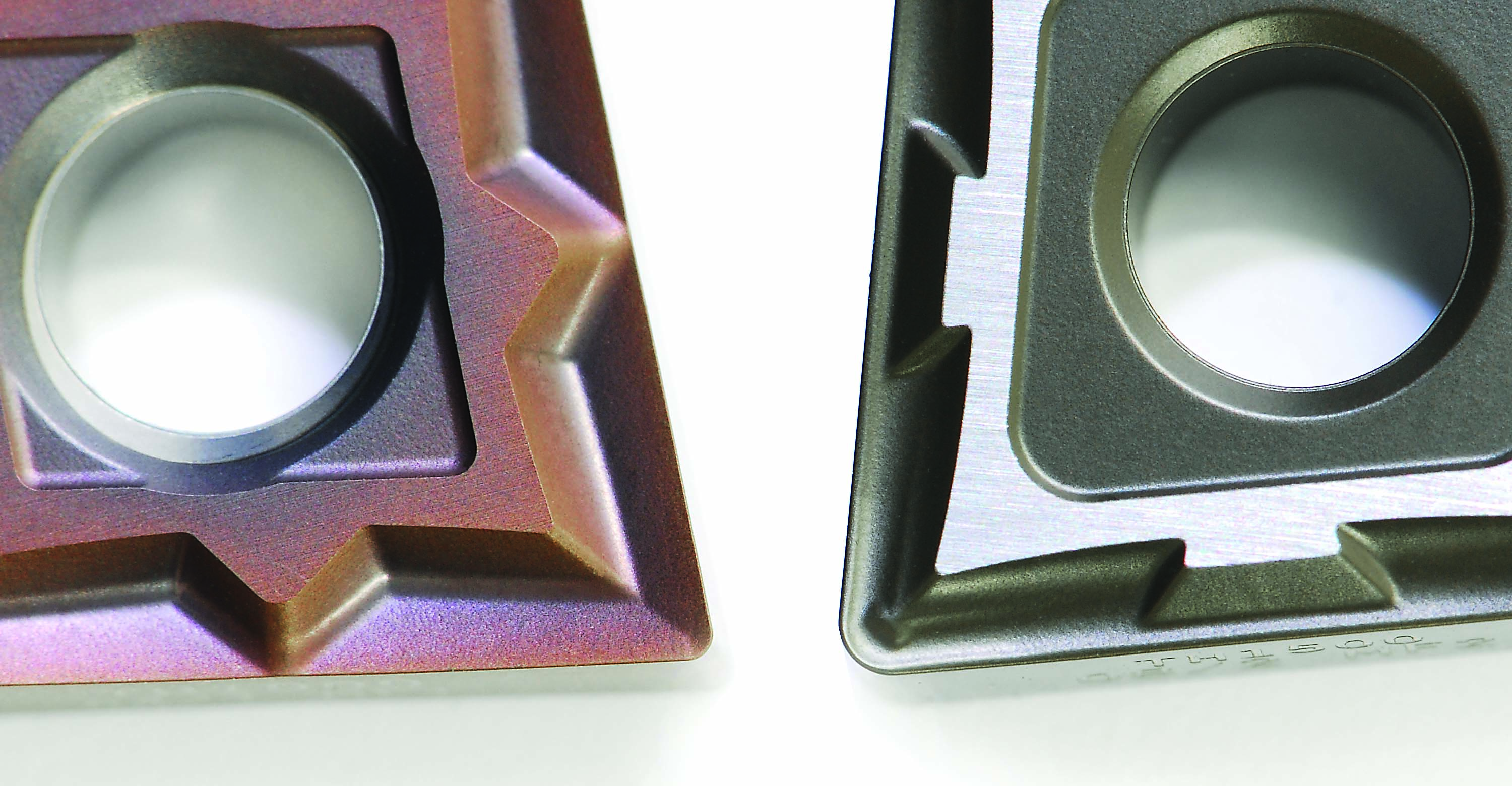

Toughness represents tool resistance to pressure and impact, which is required when performing interrupted cutting. Image courtesy of Seco Tools
In the cutting zone, temperatures can rise above 760° C (1,400° F). Hard carbide withstands and dissipates those high temperature levels and therefore handles the high heat generated in continuous cutting. High hardness levels can make metal brittle, however, which explains why heat-resistant carbide tools tend to chip in situations that produce large amounts of pressure or vibration.
Tough Enough?
At the other end of the continuum, toughness represents pressure and impact resistance, which correlate with the ability of a tool to withstand high feed rates, heavy DOCs and the repetitive impacts associated with interrupted cutting. But in exchange for durability, tough carbide becomes vulnerable to heat, making tough carbide less than ideal for high-speed, continuous cutting.
Both attributes tie directly to the primary elements that make up carbide: tungsten, carbon and cobalt. Tungsten promotes hardness and toughness while carbon boosts hardness, and the combination of the two yields tungsten-carbide molecules. Meanwhile, cobalt, which has a lower melting point than tungsten and carbon, contributes to toughness and intensifies the performance characteristics of other elements. In tungsten carbide, cobalt serves as a binder, essentially glue that holds carbide grains together.
Grain size also can determine the level of hardness and toughness. Hard carbide grades have smaller grains, and tough grades have larger ones. Hard grades need less cobalt binding to hold their grains together, which promotes better heat resistance for longer tool life during continuous cutting than with softer grades. Tough grades include more cobalt binding, which gives carbide grains better adherence to help a tool handle pressure and vibration with less heat resistance. Midway between hard and tough, cutting tools made of general-purpose carbide grades can deal with slightly interrupted cuts and offer considerable but not extreme wear resistance.
Carbide insert performance improvements often focus on two areas: the addition of superalloys or other enhanced materials to cobalt binding and the production and deposition of enhanced coatings to increase wear resistance. Image courtesy of Seco Tools

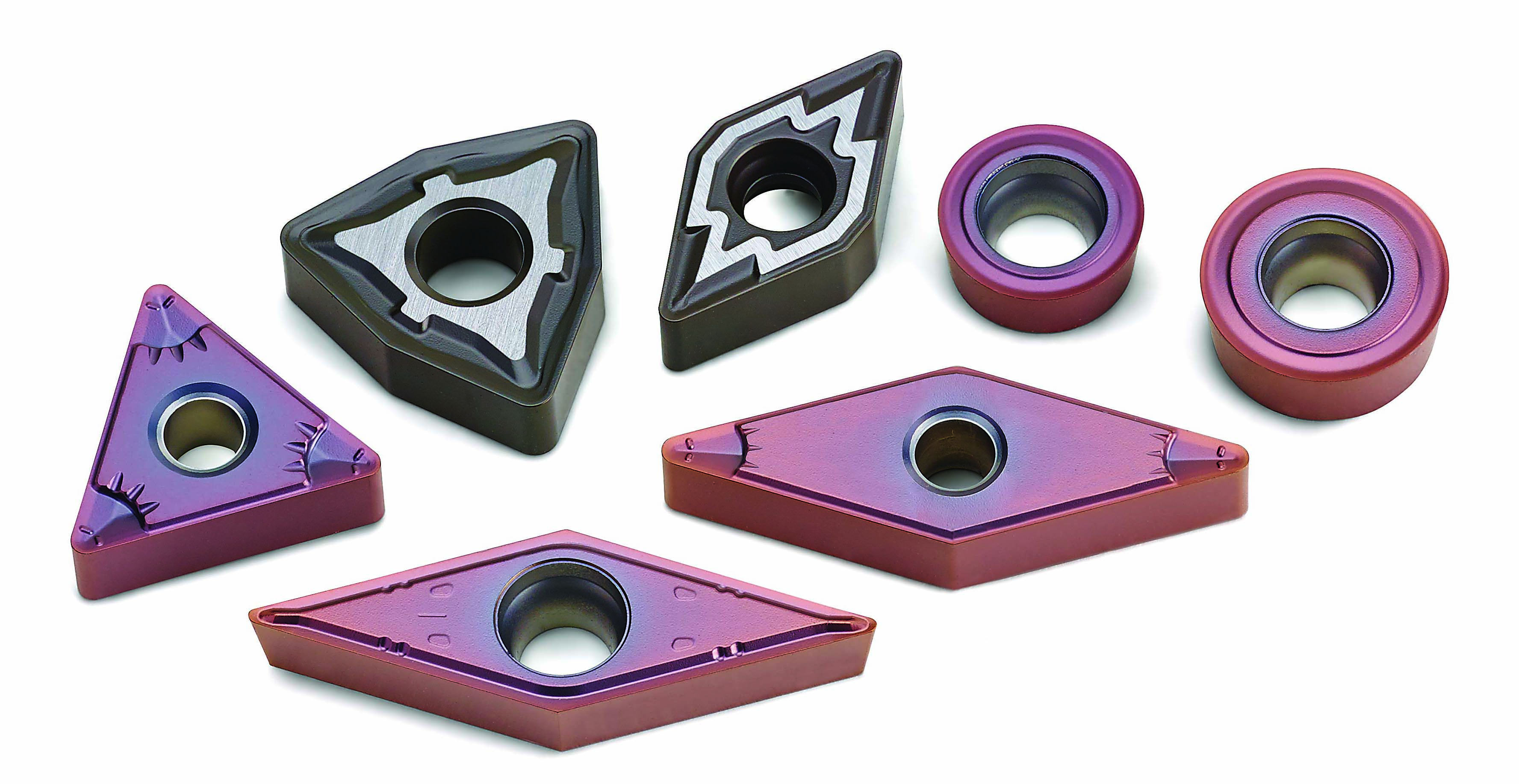

Seco Tools has increased the application range of wear-resistant TH1000 and TH1500 turning insert grades with additional positive and negative geometries, chipbreakers and nose radius sizes. Image courtesy of Seco Tools
