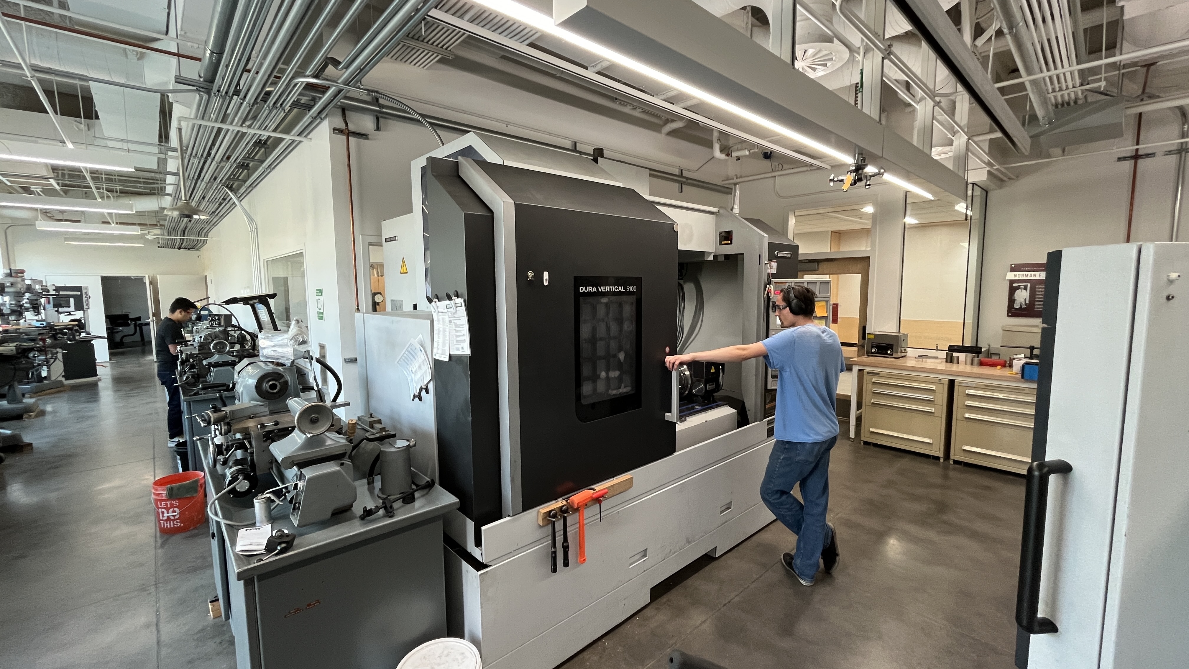

Utah Tech University Fabrication Lab

In the years to come, I want to improve the kind of equipment that we use to teach this course. Right now Utah Tech has two well-made machines — a mill and a lathe — both older DMG Mori models. They’re fantastic to start with, and frankly more machine than most engineering students ever see, but our capabilities are still limited. In the future, I want this course to include hands-on experiences related to micromachining, diamond turning, and 5-axis processes. I hope to acquire machine-tools that allow us to do that.
