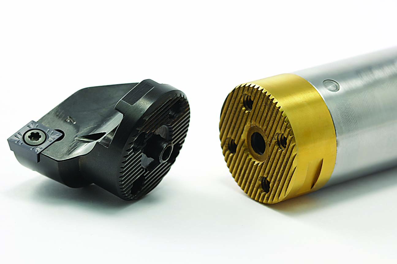

The BIG KAISER CKN connection is the strongest tool connection for lightweight tools. The double connector coupling enables the use of aluminum extension tubes, which results in a considerable weight reduction for larger tools.

BIG Daishowa reports that its modular boring systems use CK, CKB and CKN connections. CK provides a runout of 0.0051 mm (0.0002″) and consists of a cylindrical male pilot and female receptable, and the connection is made by means of a radial locking screw with a 15-degree taper. CKB is derived from CK without loss of technical and dimensional features or interchangeability. The CKB connection is equipped with a floating drive pin, which engages on both sides into respective pockets in the mating part.
The CKN connection is almost 100% compatible with CKB and is based on a three-screw connection, according to the company. By tightening the three screws, the slotted male connection expands and gives additional rigidity to the tool connection.
“CKB is the single-set-screw connection with a floating CKB pin for torque transmission during heavy cuts,” Tegelman said. “CKN uses three connection screws and slotted male pilot holes for better cylindrical and face contact between the mating components.”
He said CKN also permits the use of aluminum extension tubes for long-reach assemblies with reduced weight.
“CKB is far and away the dominant connection type,” he said. “CKN is really kind of a specialty for longer tools.”

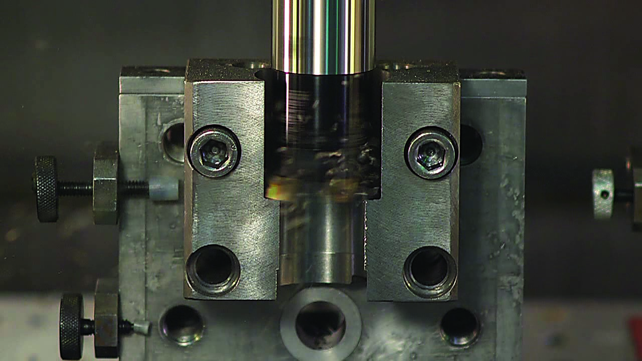

Boring a deep cavity with a long, skinny tool could cause the tool to deflect and generate chatter — a huge problem, according to Amberger. A fixturing issue, he added, is a common cause of chatter, and Parlec offers a heavy metal boring bar to enhance damping and rigidity compared with the standard steel bar.
In addition to its proprietary steel and heavy metal modular designs, Mulcahy said ARCH Cutting Tools offers two industry-standard models in carbide and steel, with steel being the lower-cost option and carbide costing up to 500% more. However, steel is suitable only up to a 4-1 projection ratio without worrying about chatter or harmonics, he said. A heavy metal bar can hang out at a projection up to 6-1 while the tungsten-carbide one can achieve at least a 7-1 and potentially an 8-1 projection when boring with a positive insert.

“All of our boring tools direct the coolant to the cutting tip to blow the chips out of the way and lubricate the cut,” Amberger said about Parlec’s products.
In addition, delivering coolant directly to the cut minimizes thermal cracking of the insert, Mulcahy said. If the speeds and feeds are correct, virtually all the heat generated in the cut leaves with the chips and coolant helps manage them, so they do not become long and stringy.
“Cooling that chip should be done immediately after it’s cut,” he said. “It will break the chip. So now you have smaller pieces of material that are easier to evacuate, and that’s a big deal when it comes to boring.”
