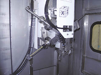

The 24-sq.-ft. footprint of an indexing rotary parts washer from Guyson Corp. is sized for a work cell. It incorporates two spray washing stations and two drying stations.
He called the work cell-based system a “lean” approach to parts cleaning where the parts are cleaned only as needed. “With a lean approach, the parts are essentially pretty darn clean all along,” Carson said, “but they’re not necessarily as clean as they’ll be in the final stages.”
In addition, waste is reduced by using only the energy necessary for specific cleaning requirements. “It’s very wasteful to be cleaning beyond what is needed for the next step because it’s going to have to be repeated after that guy dirties the parts again,” Carson said. For almost every manufacturing step, there’s some type of contamination that must be removed before the part can be considered finished, he added.
Although operational savings from a work-cell approach can be substantial, the equipment cost for a centralized or decentralized system may be similar. “The lean guy may still be spending $200,000 on his parts cleaning,” Carson said, “but he might spend $40,000 at a whack in five different locations.”
The savings from reduced labor, work-in-process inventory and parts transportation is not lost on manufacturers seeking to cut costs. “We see fewer and fewer examples of the old-fashioned methods of cleaning and more of the work cell-based, or leaner, approach,” Carson said. “People can’t afford to do it the old way and, frankly, it’s not justifiable.”

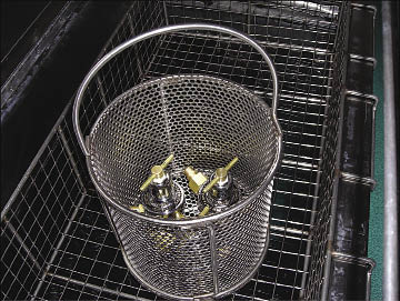

Instead of scrubbing and washing parts, potentially missing hard-to-reach cracks and crevices, a worker can place the parts in an ultrasonic parts washer, flip a switch and perform other jobs.

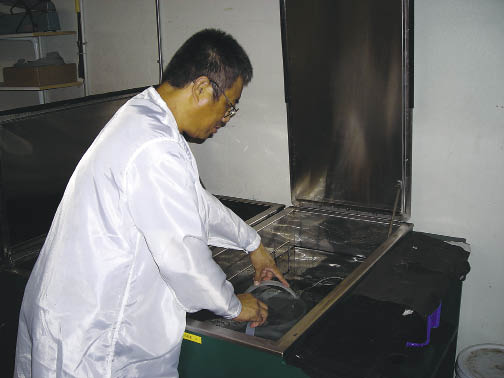

The equipment used to apply water-based cleaners varies based on numerous factors, including the need to reduce labor and part complexity. “You’re not having laborers scrubbing parts by hand,” Omegasonics’ Pedeflous said of ultrasonic cleaners. “The machine is doing that work so you’re not tying up valuable resources to do cleaning, especially if you’ve got blind-holes that you can’t get to no matter what tools you’re using. That’s where the ultrasound works so well because it can go into those areas and pull from the inside out.”
Cleaning is achieved by the vacuum sound bubbles an ultrasonic machine produces using an ultrasonic generator, or amplifier, and a transducer, or speaker. “It’s a lot like a stereo speaker in water,” Pedeflous said. “We’re just oscillating transducers within a water bath to create sound bubbles.”
In addition to the type of soap used, the output frequency needs to be appropriate for the job at hand. The higher the frequency, the smaller and more numerous the bubbles. Most industrial part cleaning applications are done at 40kHz, or 40,000 cycles per second. This means an ultrasonic tank creates 40,000 microscopic cleaning bubbles per second per transducer. For heavy items or highly contaminated items, a 20kHz to 25kHz output frequency might be appropriate because it creates bigger, stronger bubbles, but fewer of them.
On the other extreme, higher output frequencies, such as 68kHz or even 178kHz or higher, are suitable for cleaning debris smaller than a micron from parts. Those include medical and electronics applications, such as disk drives. “I wouldn’t use, as an example, a high frequency to clean an injection mold because I’m not going to get enough energy to do a good, thorough job,” Pedeflous said. “It may take a lot longer or I may just never get it done.”
Ultrasonic equipment manufacturers can build a tank with more than one frequency, such as 40kHz and 68kHz, but a user couldn’t operate between those at, say, 50kHz. However, Pedeflous said most will provide a sweep frequency, such as one that sweeps back and forth from 39,000 to 41,000 cycles per second, to eliminate standing waves for optimal cleaning performance.
The tank temperature and the time parts remain exposed to ultrasound are additional variables. The appropriate temperature is a function of the cleaning chemistry, because different chemistries break down at different temperatures. “The enzyme cleaner is something we generally don’t like to see go above 130° F because then it’s not as active,” Pedeflous said, noting that most applications are in the 130° to 150° F range.

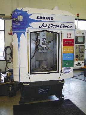

Unlike an ultrasonic machine, where parts are processed unfixtured in batches, Sugino Corp., Itasca, Ill., offers CNC high-pressure water washing centers that require hard fixturing to clean one or more parts at a time. “We can pressurize more than one nozzle, so if we have two parts sitting side by side, we can use a dual-nozzle manifold to hit both parts at the same time,” said Dave Becker, sales manager for Sugino. “When necessary, this is done to improve cycle time.”
Sugino’s three basic cleaning machines are the Ü-Jet with a maximum operating pressure of 1,015 psi, the recently introduced Spa-Clean Jet with pressures up to 5,000 psi and the Jet Clean Center with maximum pressures of 5,000, 7,250 and 10,000 psi, depending on the model.
The company developed the Jet Clean Center primarily as a CNC deburring machine but is finding more and more customers are using the machine for mainly intermediate and in some instances for final washing, according to Becker. “Our customers are relying on the pressure and the velocity of the water to clean parts rather than using a cleaning agent at a lower pressure,” he said.
Sugino recommends a 5 to 7 percent solution of synthetic rust preventative combined with deionized or reverse-osmosis water for all its cleaning machines. This solution provides the best composition for meeting cleaning specifications and eliminates the possibility of inputting particulate and chlorine directly into the machine, according to the company.

The Jet Clean Center from Sugino has a CNC turret for applying various tools for cleaning and deburring parts.
In addition to positioning hard deburring tools, the Jet Clean Center’s turret positions nozzles for cleaning and deburring, with little or no difference between the nozzles used for deburring or cleaning. “The difference may only be larger orifice diameters to produce more flow rate for washing or using a fan nozzle to provide more coverage when washing a part,” Becker said. The nozzles include lance, direct-spray, fan-spray and right-angle nozzles, as well as multiple-nozzle manifolds. Becker indicated the lance nozzles are Sugino’s own designs. They typically have two holes 180° apart but can also be tailored to an application. In contrast to Sugino’s other cleaning machines, the Jet Clean Center’s nozzles can enter the workpiece. “In some applications, we’re going 7 ” or 8 ” into the part,” he said.
