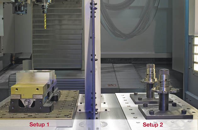

The Kiwa V21i-R VMC from Methods Machine Tools enables a shop to machine two setups in one operation, maximizing run time.
Methods also markets a Kiwa machine that McIver calls “A 40-taper production center.” The rapids and maximum spindle speeds of the Kiwa V21i-R VMC are not as fast as the smaller Robodrill machines, but the larger, more powerful spindle and extra mass is “for those guys who machine aluminum but who also do nickel-base alloys and titanium,” McIver said.
A pallet changer enables a shop to set up one job while another one is being machined, maximizing run time. The Robodrill is offered in fixed-table and side-by-side pallet configurations, while the Kiwa comes only as a lazy-Susan-style rotary pallet changing machine. “The rotary pallet changer provides the ability to run hydraulics and vacuum systems through the center of the pallet and add special fixturing and a 4th axis without the hassles of running umbilicals in and out of the machine, as would be necessary with side-by-side pallets,” McIver said.

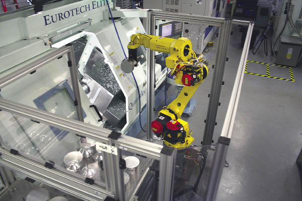

Multispindle Eurotech machine tools permit Chasco Machine & Manufacturing to use one machine to produce parts that otherwise would require secondary operations, while a Fanuc robot permits low-cost, untended work.

The one thing that “saved our butt” amidst the economic turmoil, Roth said, was the shop’s machine tools. Chasco has Elite multispindle lathes from Eurotech, Brooksville, Fla.; Tsugami Swiss-style automatic lathes imported by REM Sales, Windsor, Conn.; and is adding Lico CNC turning centers, supplied by Eurotech. A Fanuc robot permits untended operation. The multispindle machines enable Chasco to use one machine to produce parts that otherwise would require secondary operations, and the robot permits low-cost, untended work.
The shop’s newest Eurotech machine features a subspindle and has Y-axis capability on both of its twin turrets. “We have a customer coming in for a steel carrier for the AR-15 rifle. It’s 1,000 pieces a month, and the new machine is perfect for it,” Roth said. “We can take that part and run it complete on our lathe and be milling on two sides at the same time. Then we are going to send it out for heat treat; instead of grinding the 0.001 ” tolerance on the OD after heat treat, we are going to hard turn it in our Eurotech with the robot on it.”
