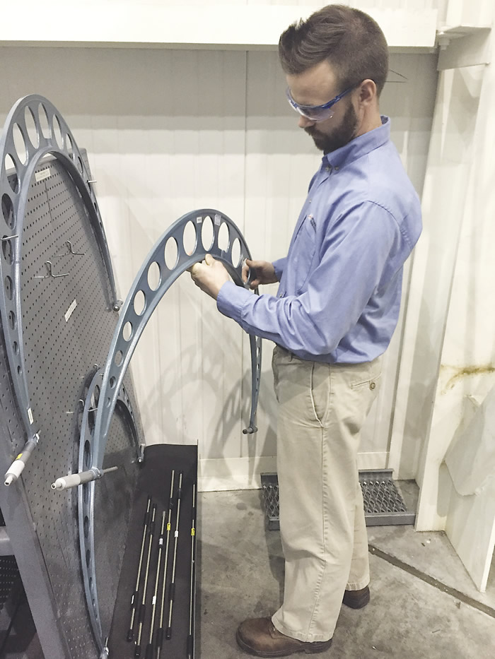

Joel Johnson, a quality engineer at Mitsubishi Hitachi Power Systems, checks calibration stickers on large micrometers used to measure the journals of gas turbine rotors. All images courtesy C. Tate.

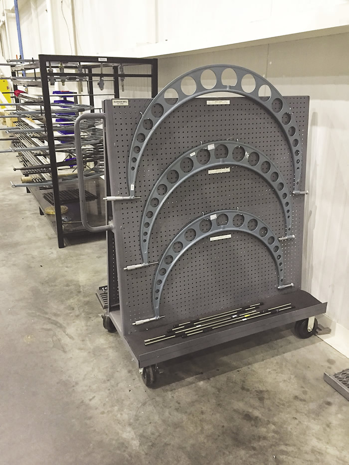

Large parts require large measuring tools, such as these micrometers used to measure turned diameters on large gas turbine components.
