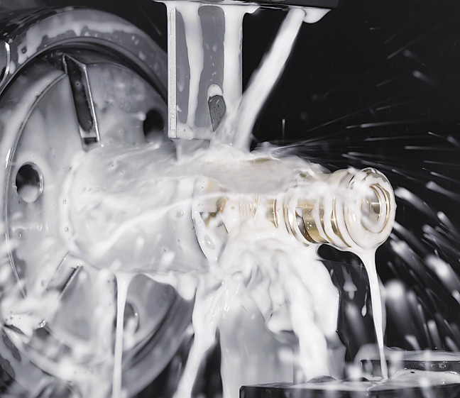

Regular monitoring helps ensure cutting fluid is used to its maximum potential. Image courtesy Microbe Inotech Laboratories.

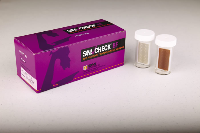

“There’s usually a great deal of bacteria in metalworking fluid that can exist without compromising the process,” Thomas said, “so if a customer is using one of our dip slides to check their fluid, it means they’ve already established an acceptable baseline. However, if the levels are over that baseline, they will take some sort of action, whether it’s adding a biocide.”
Biosan uses culture testing to test fluids. It takes longer than some other methods but generates more-detailed results. The dip slides can give results in 24 to 48 hours, so Thomas said some customers supplement the dip slide with a quicker method, such as ATP (adenosine triphosphate) testing. This is a method of detecting microorganisms through detection of ATP—a molecule found in and around living cells—a process that typically takes around 10 minutes. The downside, she continued, is ATP testing is typically much more expensive.

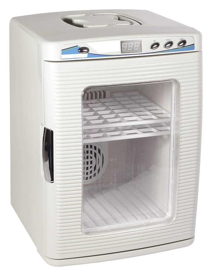

Culture testing involves placing dip slides in an incubator to monitor chemical changes associated with microorganisms. Image courtesy Biosan.

Biosan offers culture testing in the form of dip slides. Detailed results can be obtained in 24 to 48 hours. Image courtesy Biosan.

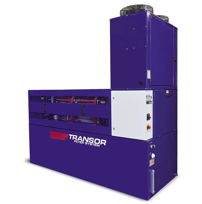

Transor provides 1µm oil filtration and temperature control, effectively allowing indefinite oil life for grinding and EDMing operations. Image courtesy Transor Filter USA.

Effective filtration is critical when looking to avoid regular testing, because particulates from the machining process can pass through an insufficient filtration system on each cycle and reduce the efficiency of the entire process, according to Kaage. “If you can filter down to 1µm, you take out almost all the physical contamination and won’t see that loss of efficiency.”
Temperature control is also important because a major contributor to the degradation of grinding oil is heat, he continued. In addition, excessive heat causes grinding burn marks on workpieces, premature failure and, ultimately, scrap.
