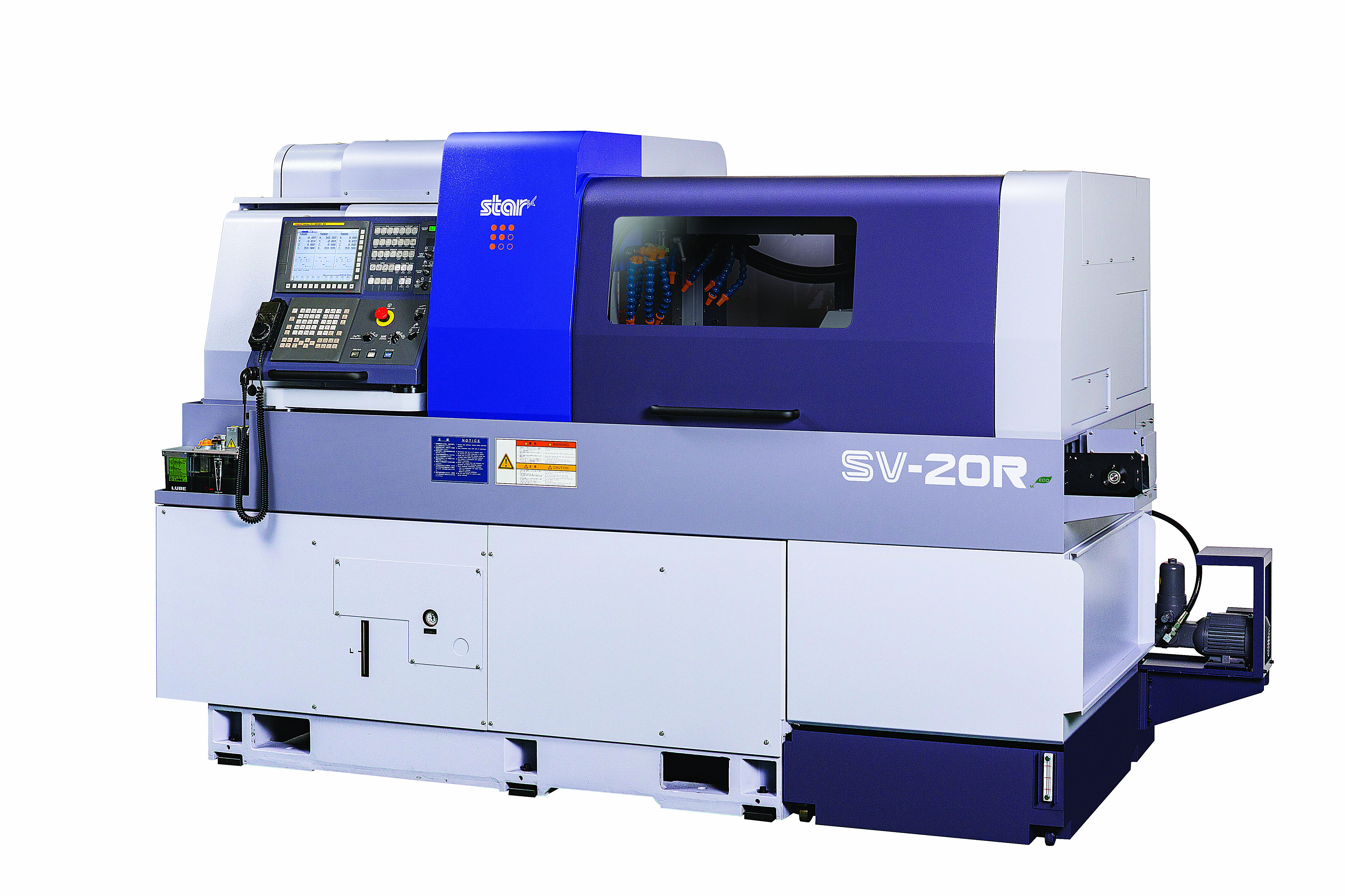

Convertible headstocks becoming the norm on Swiss-style machines
The option to switch between collet and guide bushing is standard on most Swiss-style turning machines, such as this one from Star CNC Machine Tool. Image courtesy of Star CNC Machine Tool.
The majority of Star’s machines are also convertibles. “The extreme length-to-diameter demand isn’t what it used to be,” Garber said. “Most customers are more concerned with getting parts done in as few operations as possible.”
Of course, most customers are also concerned about setup time. The good news is that switching from a sliding headstock to a fixed one takes 15 to 60 minutes. Users remove some screws and the guide bushing unit, flip a switch or change a parameter setting, and the machine is as ready to make parts as its now-converted alter ego.
