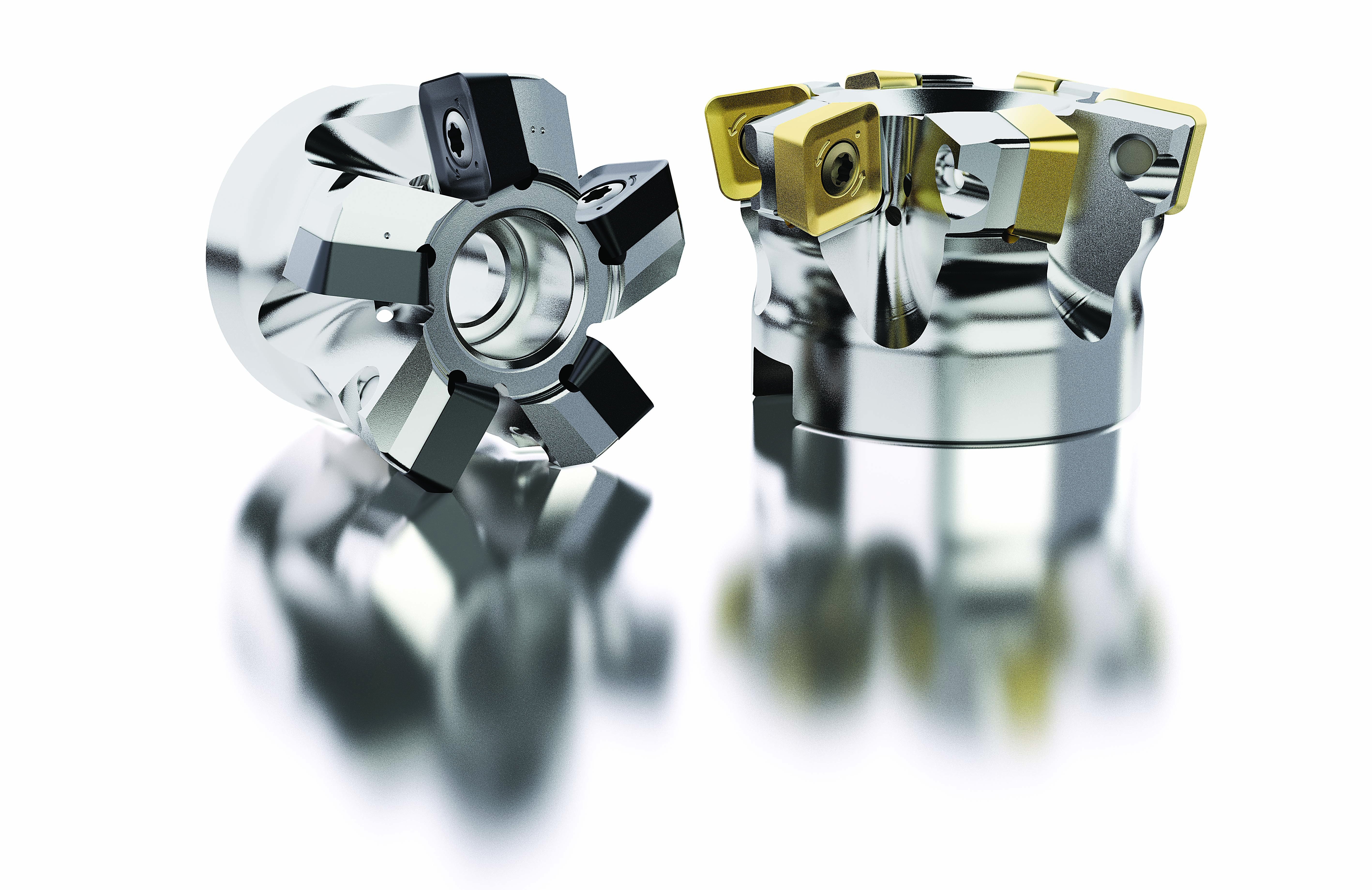

High-feed indexable insert milling tools are also widely available to up throughput. Andersson said this started several decades ago with round inserts, which have a continuously variable lead angle, depending on the DOC in relation to the radius.
High Feed Square Cut milling cutters pair a shallow DOC with a high feed per tooth to achieve high metal removal rates.
High Feed Square Cut milling cutters pair a shallow DOC with a high feed per tooth to achieve high metal removal rates. Image courtesy of Seco Tools

For example, Seco Tools introduced the High Feed Square Cut size 14 milling system late last year. The toolmaker reports that the single-sided, straight-edge insert geometries of the system are suitable for high-feed ramping, pocketing, plunging, facemilling and copy
milling.

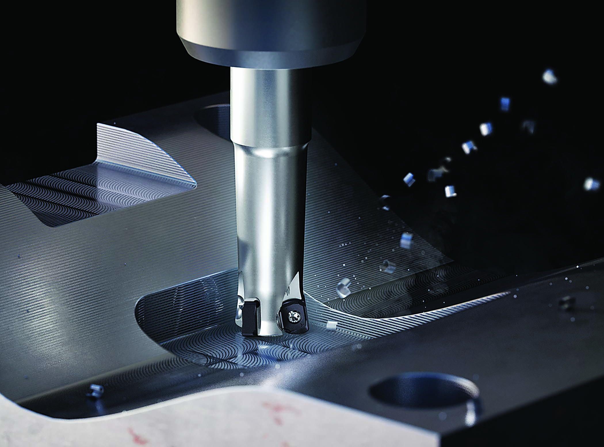

Bokram said high-feed milling tools use a simple design feature to fundamentally change machining parameters, often resulting in significantly higher total metal removal rates than conventional 45- and 90-degree designs. By reducing the approach angle of the cutter to 15 to 20 degrees, the resultant average chip thickness is reduced, which commonly is known as chip thinning.
“In order to increase the chip thickness to the ‘normal’ range for the insert edge geometry, the feed rate (ipm) must be increased,” he said. “The result is higher cutting speeds and ultimately higher metal removal rates.”

However, drawbacks exist. Bokram said a high-feed mill can impart poor surface finishes, so it’s applied only for roughing, and the DOCs are restricted because of the shallow approach angle.
The MaxiMill milling cutter accepts double-sided inserts with 16 cutting edges.The MaxiMill milling cutter accepts double-sided inserts with 16 cutting edges. Image courtesy of Ceratizit USA” data-entity-type=”file” data-entity-uuid=”d36f2bd2-1069-4a2c-868f-8f560169e012″ height=”551″ src=”/wp-content/uploads/legacy/inline-images/MaxiMill-273.jpg” width=”376″ />
“In the end,” he said, “the user must calculate the comparative metal removal rates to alternative milling system designs, based on the milling operations they are performing.”
Nonetheless, Bokram said that shallow approach angle causes the net resultant machining forces to be exerted mainly along the axis of the milling cutter.
“This means that high-feed designs are useful for long-reach applications because they generate very little vibration,” he said. “They also minimize radial force stresses on the spindle.”
