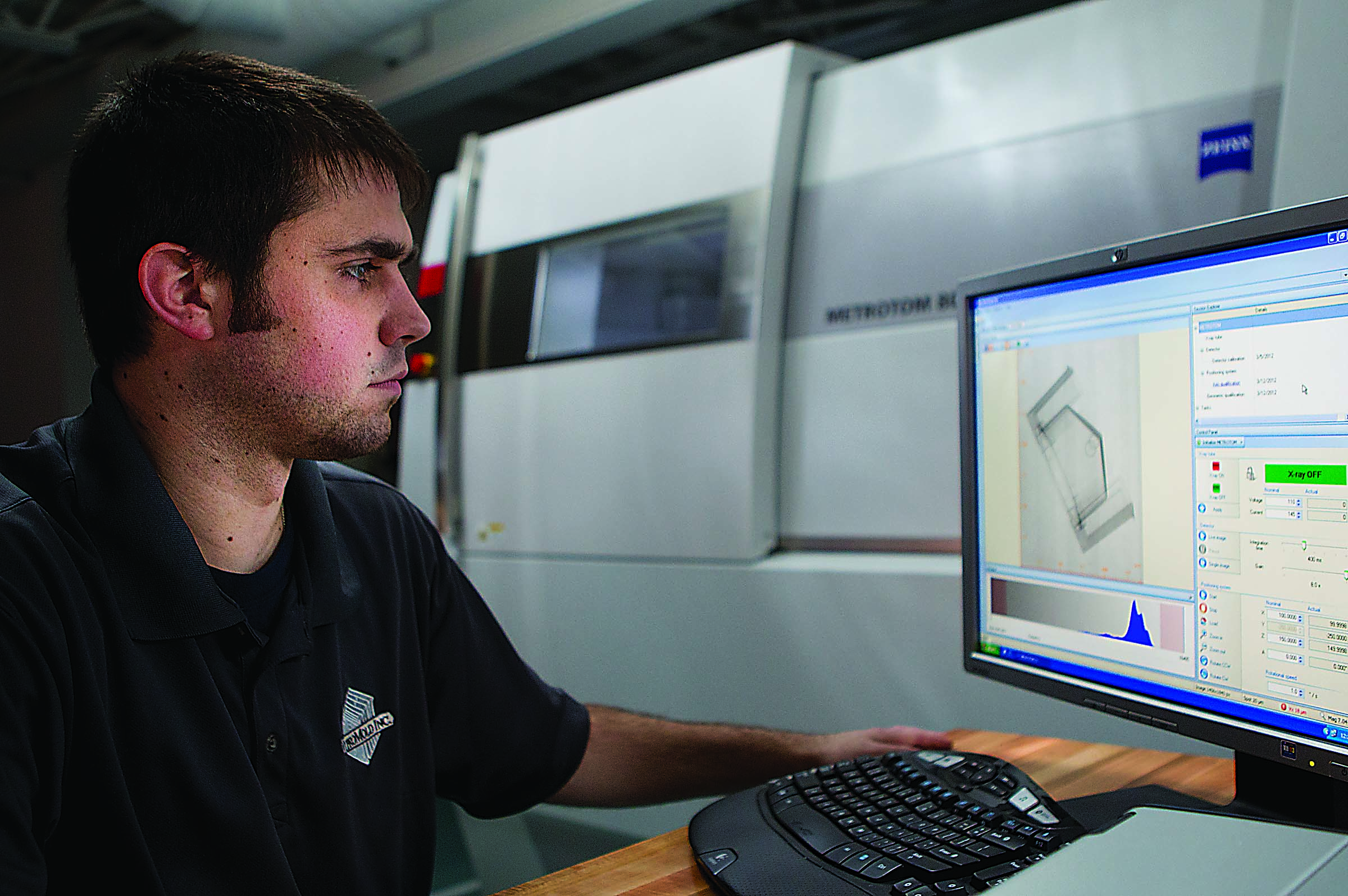

A quality engineer uses Volume Graphics software to analyze data from a scan of an electric motor. Image courtesy of Jesse Garant Metrology Center

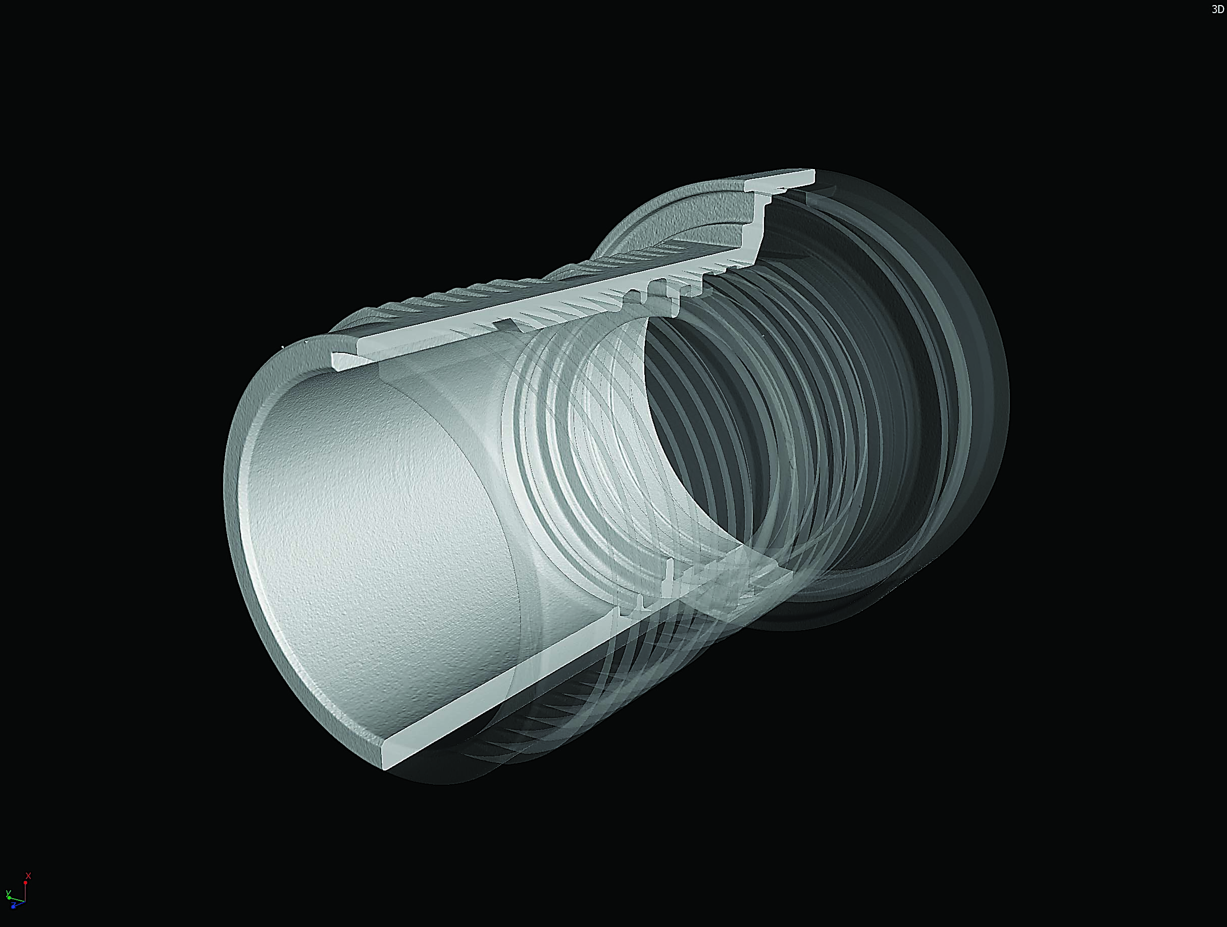

CT scanning is suitable for dimensional inspection, reverse engineering and CAD-to-part analysis. Image courtesy of Exact Metrology

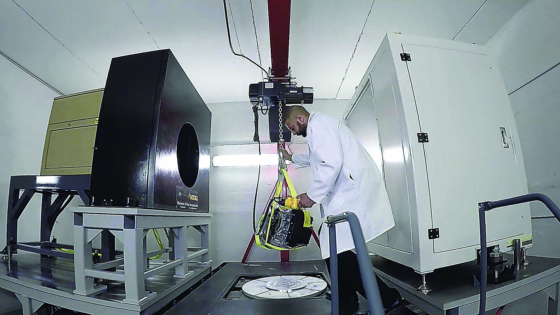

CT scanning machines need significant shielding to protect operators from X-ray exposure. Image courtesy of Exact Metrology

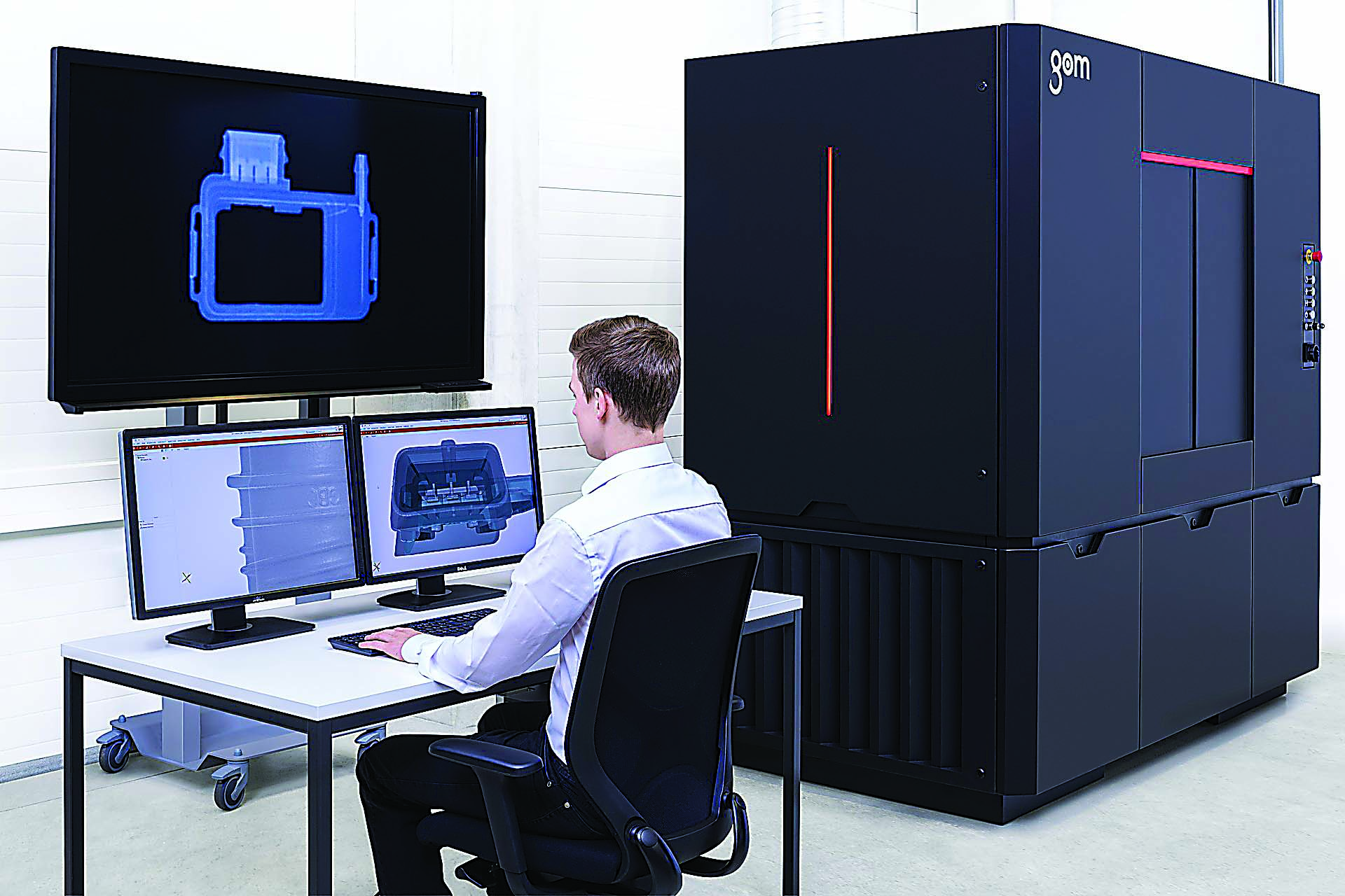

Ryan Bergeron, CT engineer at 3D ProScan, said it’s possible with smaller workpieces to perform multiple part inspections in one setup, which is a real timesaver when validating multicavity molds.

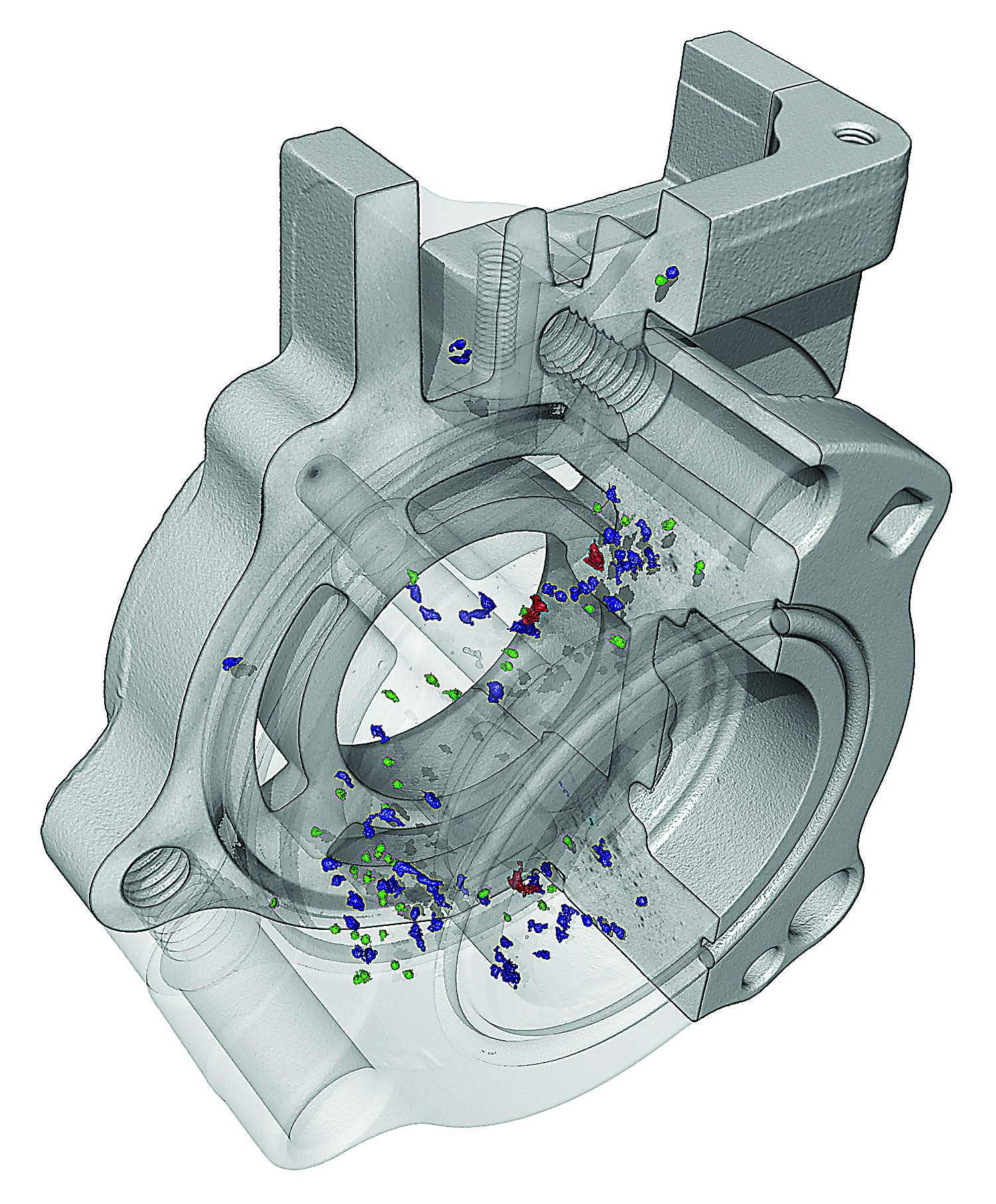

This aluminum casting was checked for porosity, a common application for CT scanning technology. Image courtesy of Jesse Garant Metrology Center
“The user-managed color maps provide visuals that make interpreting variation easier and decision-making more intuitive,” he said. “This is why the team likes to say CT scanning enables better decisions faster.”
