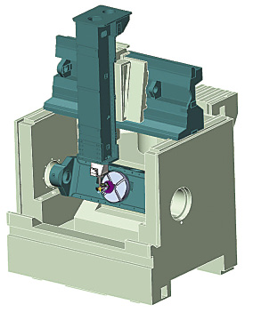

Full machine simulation of an insulator bracket being cut (see close-up below).

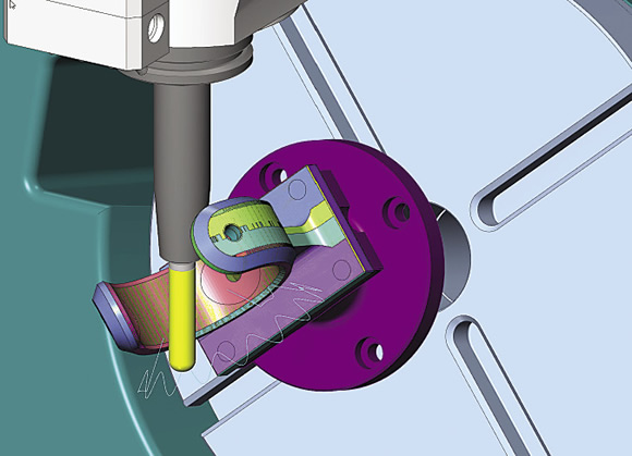

Close-up of the insulator bracket being cut during simulation. The programmer is checking “oscillation” motion to prolong tool life.

In the 5-axis world, it is sometimes necessary not only to simulate the CAM software’s intermediate code but also the G code driving specific, individual machines with unique kinematics. This higher level of verification, known as machine simulation, proves out machining strategies in a virtual 5-axis environment that ensures part geometries, tools, fixtures and machine components will not interfere with each other during the cutting process.
There are two varieties of machine simulation. The first takes the intermediate code (APT, NCI, CLS) generated by the CAM system prior to post-processing into G code for the machine’s control and uses that code to drive a virtual replica of the specific 5-axis machine. A small number of CAM developers have taken this approach, with some even refining it to the point where a separate, simplified stream of code is generated to drive the 5-axis machine simulation process.
The second, even more meticulous approach drives a precise virtual replica via the G code generated by a CAM system’s post-processor. This program allows the user to choose from a variety of machine and control options and effectively simulates any G-code language.
The good news is that either of these approaches will accurately simulate machine behavior if an accurate model of the machine has been created and the simulation program has been properly configured. Correctly configuring a virtual replica and the simulation process requires an in-depth knowledge of the specific 5-axis machine, simulation software and post-processor.
Setting up an effective machine simulation program can be time consuming and expensive, but it will protect a 5-axis CNC machine investment and dramatically improve the manufacturing process. The alternative is to laboriously step through first-piece manufacturing operations sequentially at the machine, wasting machine time and labor—unacceptable in today’s manufacturing environment. Simulation also provides a safe, relatively low-cost virtual environment for testing competing “what if” scenarios, so simulation-derived, 5-axis machining strategies can become a competitive advantage.
