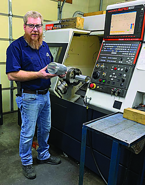

Jerry McNealy, owner and operator of Indian Mountain Machine Shop, displays thin-wall aluminum parts produced on a Mazak turning center with an STMD anti-vibration tool body from MAQ. Image courtesy of Indian Mountain Machine Shop

“When we first began running the parts, I went over to my toolbox and got the best 1.25″ (31.75 mm) anti-vibe bar that we’d previously had, thinking that we might just try with it first and see how it went,” he said about turning parts that were 228.6 mm (9″) long. “Using this bar, however, we only ended up with what I figured to be a low rpm, slow speed and a very poor finish. This particular part we were working on was going to take up to an hour and 15 minutes to rough and finish the bore.”

With MAQ’s STMD bar, he said the shop now roughs and finishes the 228.6 mm-long parts using the same bar in less than 15 minutes.
“The finished product was checking in at under 20 µin. and was absolutely immaculate,” Jerry said.
He said Indian Mountain Machine Shop doesn’t save quite as much time when turning all the parts but typically reduces cycle times by 15 to 30 minutes, with spindle speeds up to 1,000 or 1,200 rpm.
