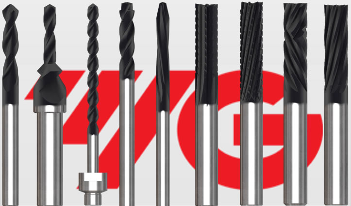

YG-1 Tool developed its line of D-Power diamond-coated carbide endmills for machining graphite and composite materials. Image courtesy of YG-1 Tool.
