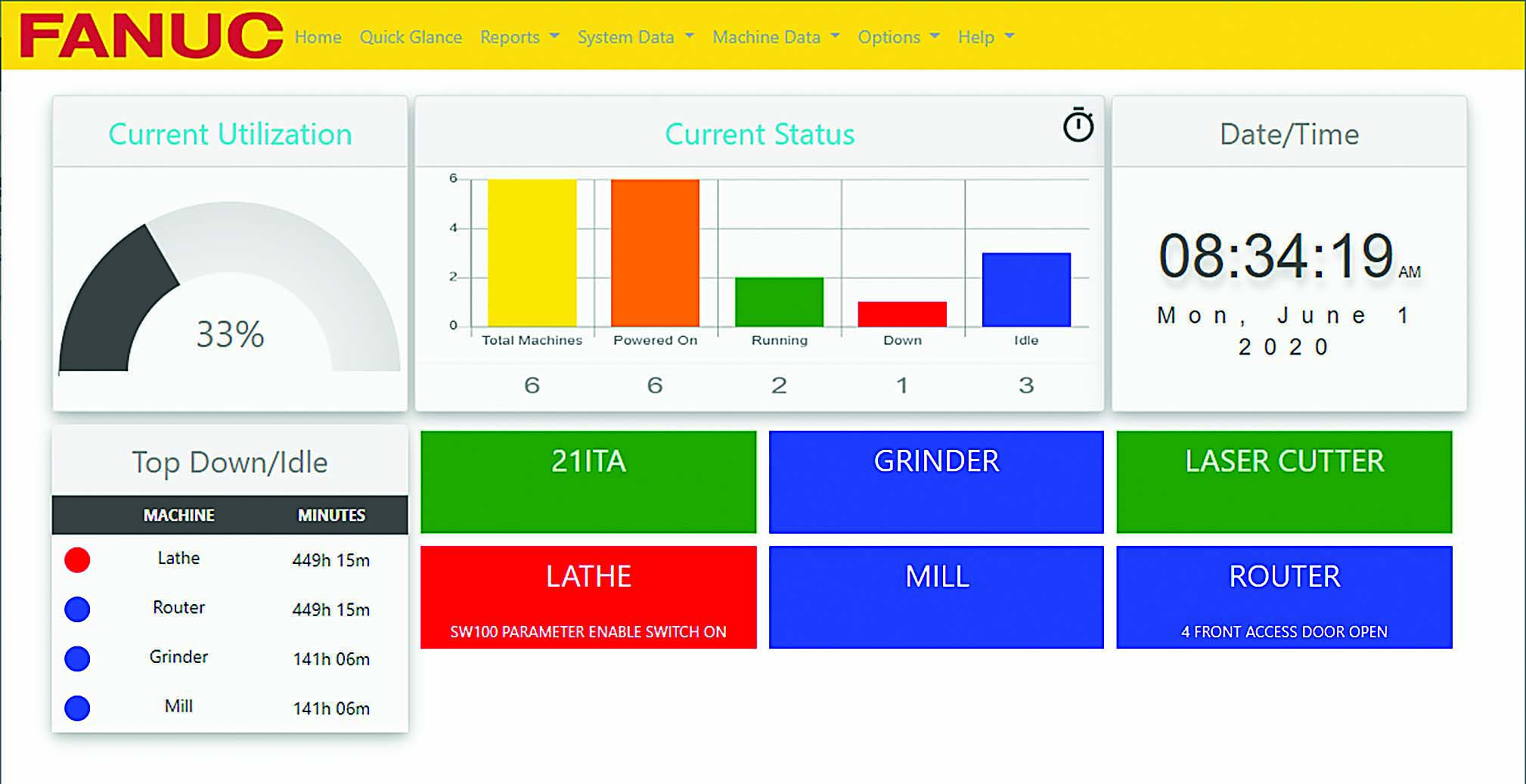

One such product is FASData software from Fanuc America Corp. in Rochester Hills, Michigan. Working with Fanuc CNCs, FASData allows users to collect and analyze shop floor data. Key process and maintenance information can be viewed on a simple dashboard. Displayed data includes machine status (up or down), alarm information, cycle time and part count. Collected data can be stored for later analysis or passed along in real time to other software programs.
Redax users enter a web address that brings up the system’s dashboard on any type of display. Image courtesy of Anca
FASData is installed on a single computer — for example, a desktop or a small-business server — connected to a shop’s network. Data is viewed on webpages shown by a variety of displaying devices, including PC screens, phones and tablets.
In many cases, complicated analytics isn’t required to produce valuable information, said CNC Engineering Manager Paul Webster of Fanuc America.
“Probably 80% of the issues in shops are relatively straightforward, (like) you had an alarm on your machine for 10 minutes before somebody realized it,” he said. “(An alarm) is a simple thing for software like this to pick up. The same with production data. Maybe the feed rate override is turned down to 50% because an operator doesn’t want to run it at 100%. There are hundreds of examples of data that a simple dashboard, simple analytics, simple reporting can pull out to identify maintenance problems or slowdowns in your production process.”

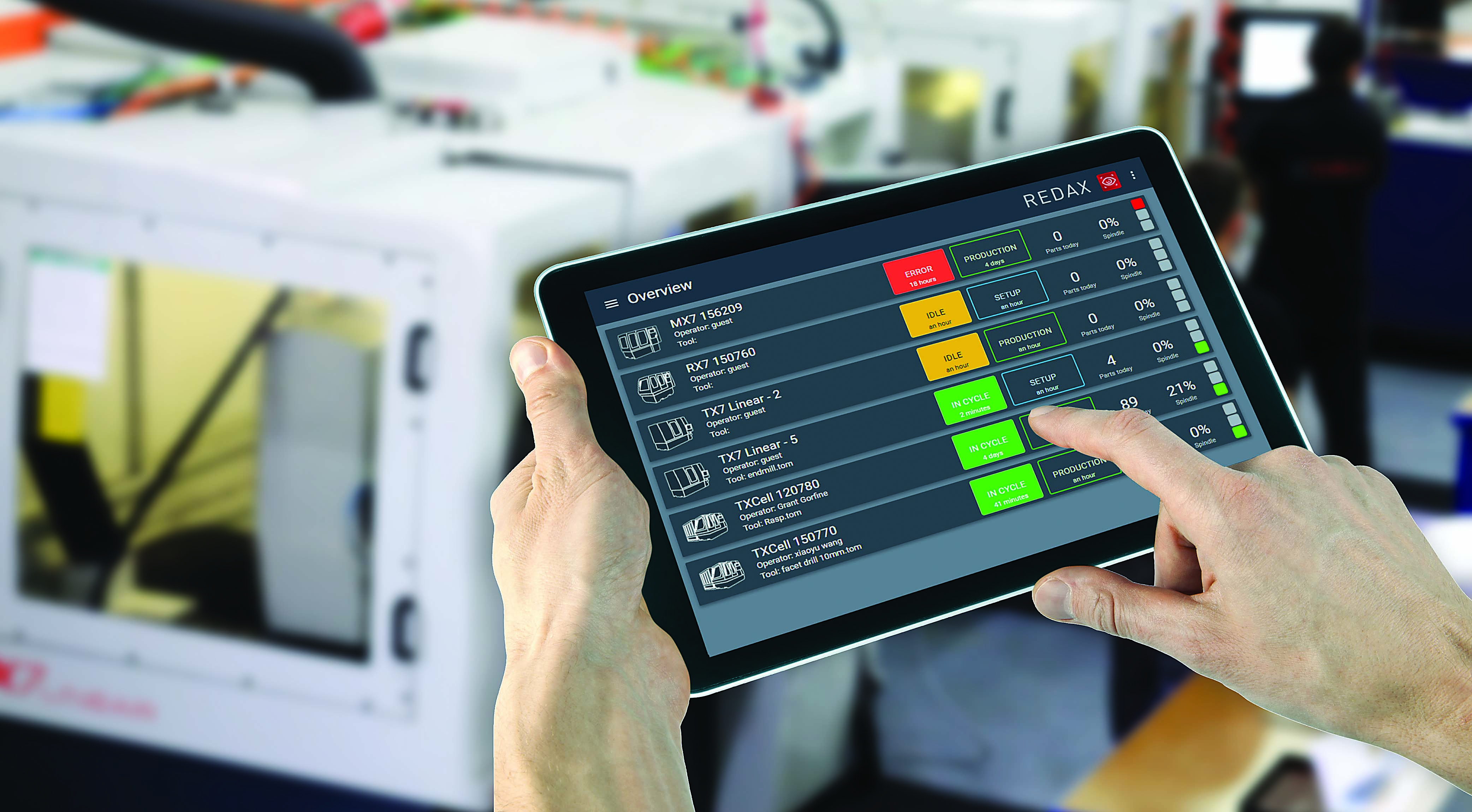

Similar to FASData is Redax software, which is used to network grinding machines to send and receive data. Developed by Melbourne, Australia-based Anca Pty Ltd., Redax allows users to view, analyze, manage and generate reports on production and maintenance data from all machines at a shop. (Anca Inc. is in Wixom, Michigan.) Data is accessible anytime, even when machines are shut down, using any web browser on a desktop computer, mobile phone or tablet, as well as a monitor on a shop floor. Shop personnel also can receive email or text message notifications when machines are down so immediate action can be taken.
On a screen, Redax users see at a glance how all their grinding machines are operating. Displayed data includes machine availability, uptime and time spent in setup. Redax also collects information that lets users calculate overall equipment effectiveness, a common measurement of how well a manufacturing operation is performing compared with its full potential.
By showing which machines at a shop are most productive, Redax makes it possible for shops to identify their best operators.

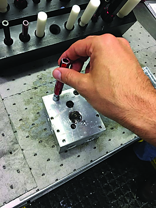

Automated data collection and analysis also can be employed to assess the quality of machined parts. At a plant in South Carolina, an artificial intelligence system developed by the North American research and development team of Charlotte, North Carolina-based Bosch Rexroth Corp. is gathering and analyzing data to spot bad automotive components made by 38 CNC machines. The machines drill two different holes in each part. After a machine drills a hole in one side of a part, a tower holding the workpieces rotates and a second hole is drilled in the other side of the component. In the process, chips that are sent flying during cutting operations can end up in the already drilled cavities and produce undesired part vibration.
The goal of the R&D team was to eliminate the need for humans to manually check each part for chips in cavities.

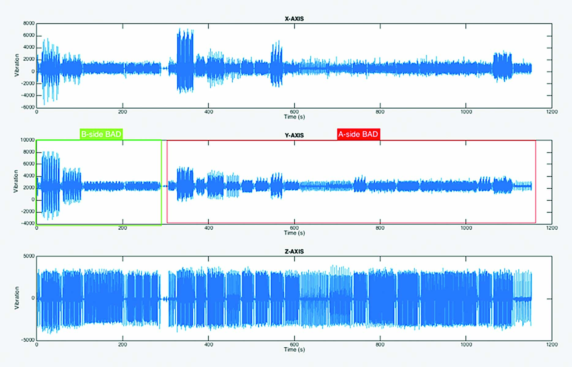

The system created by him and his colleagues includes Bosch sensors mounted on a drill to capture vibration data, which is collected by an edge device near the machines and eventually travels to an Amazon Web Services cloud platform for analysis.
To create an AI neural network capable of evaluating the parts, the Bosch Rexroth team had to extract certain information from the vibration signal produced during drilling. The team also needed “labels” created by operators clicking on Amazon Dash buttons to signal whether each drilled part was good. By matching labels and vibration information produced at different times during machining, the team was able to teach the neural network which vibration data indicated a bad part (one with a chip in the cavity) and a good part (one with no chip in the cavity), as well as the type of tool used in the machining operation.
Downloaded to the edge device, the neural network can evaluate parts almost instantaneously as they’re machined, Dariol said. The system has been running for more than two years and has become more accurate over time thanks to continuous data collection.
“Now we produce 1% or less false positives and false negatives,” he said. “So our customers are really trusting the results they are getting from our system.”
