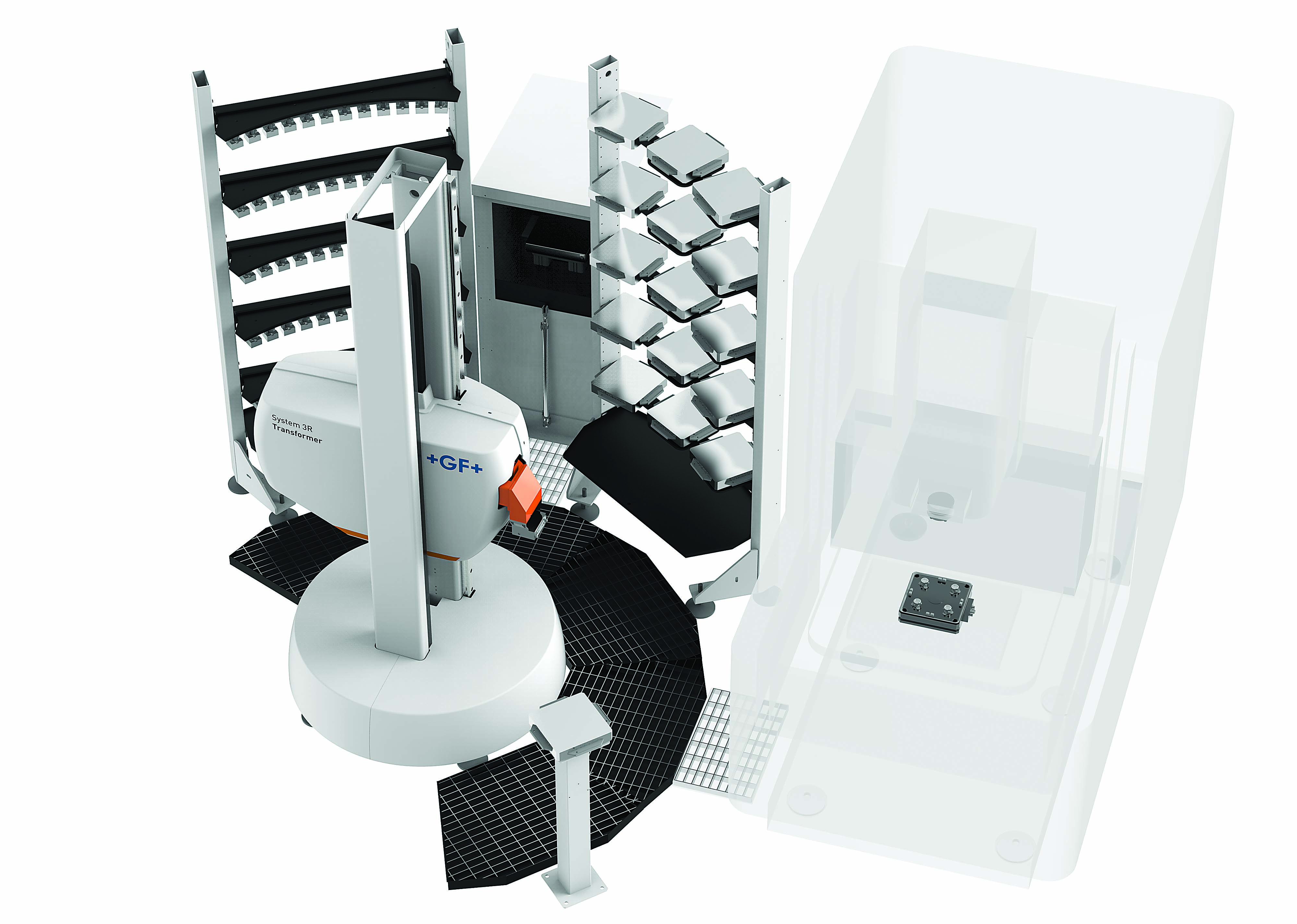

The System 3R Transformer robot, shown above, can connect up to three EDMs. Alternatively, by adding a track for the robot, it can feed up to 12 machines.
The System 3R Transformer robot, shown above, can connect up to three EDMs. Alternatively, by adding a track for the robot, it can feed up to 12 machines. Image courtesy of GF Machining Solutions

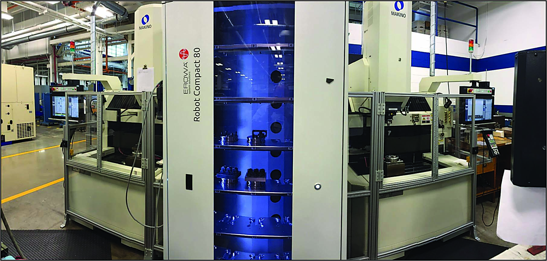

Makino offers a variety of cellular automation for sinker EDMs, such as the Erowa Robot Compact 80, which has a transfer weight capacity of 80 kg (176 lbs.) and can serve one or two machines.
Makino offers a variety of cellular automation for sinker EDMs, such as the Erowa Robot Compact 80, which has a transfer weight capacity of 80 kg (176 lbs.) and can serve one or two machines. Image courtesy of Makino

To connect to three machines, he said GF Machining Solutions provides System 3R’s Transformer three-axis robot. By adding a track for the robot, it can feed up to 12 machines.
“Instead of throwing away the robot because you want to hook up more machines, the robot is already invested,” Ostini said. “The robot can transform from a stationary robot feeding three machines to a track robot feeding up to 12 machines.”

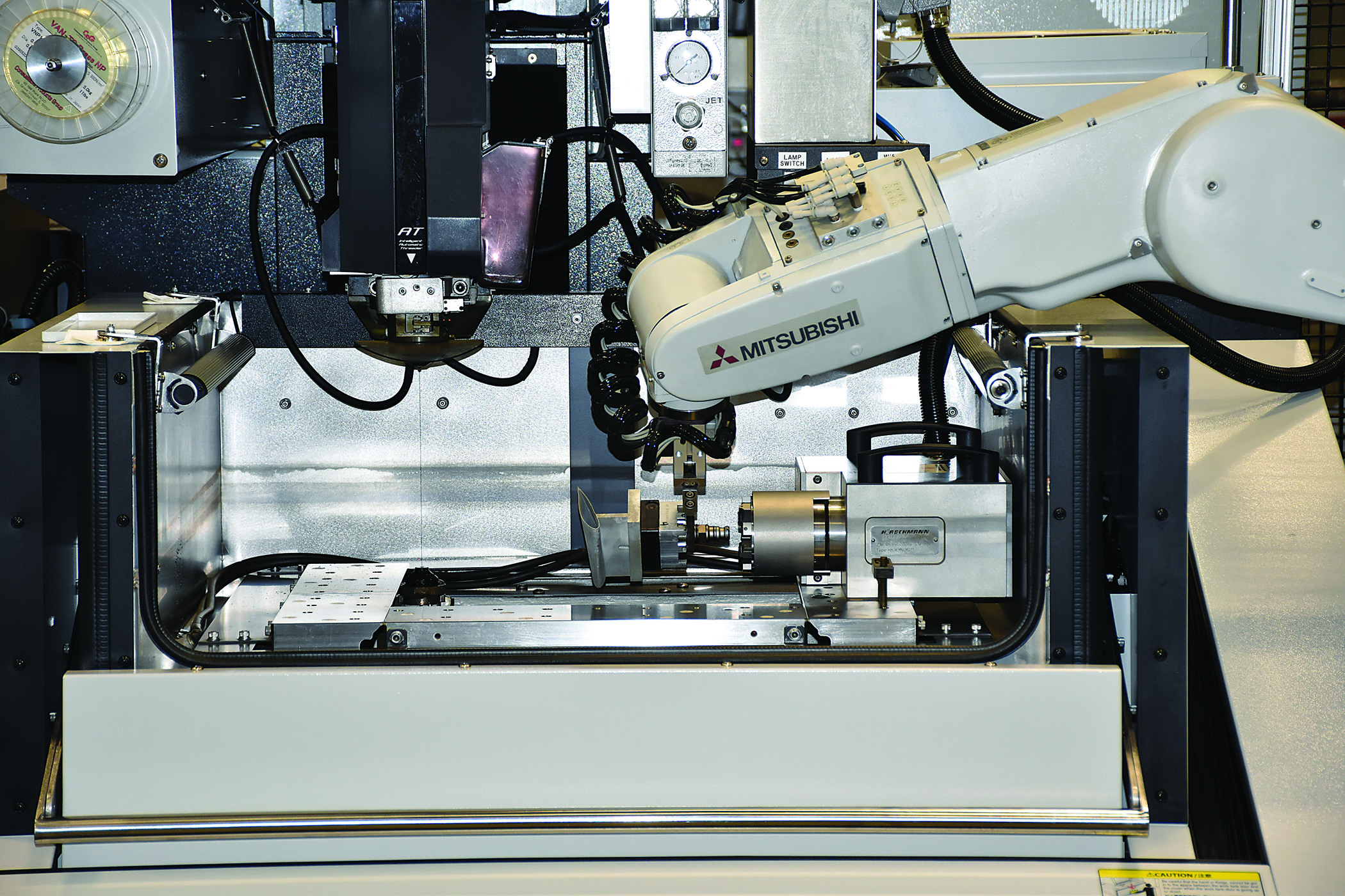

A Mitsubishi MELFA RV13F robot (above left) places a palletized production part into the tooling chuck of a rotary b-axis, which is mounted to the table of a Mitsubishi MV1200S wire EDM.
A Mitsubishi MELFA RV13F robot places a palletized production part into the tooling chuck of a rotary b-axis, which is mounted to the table of a Mitsubishi MV1200S wire EDM. Image courtesy of MC Machinery Systems
